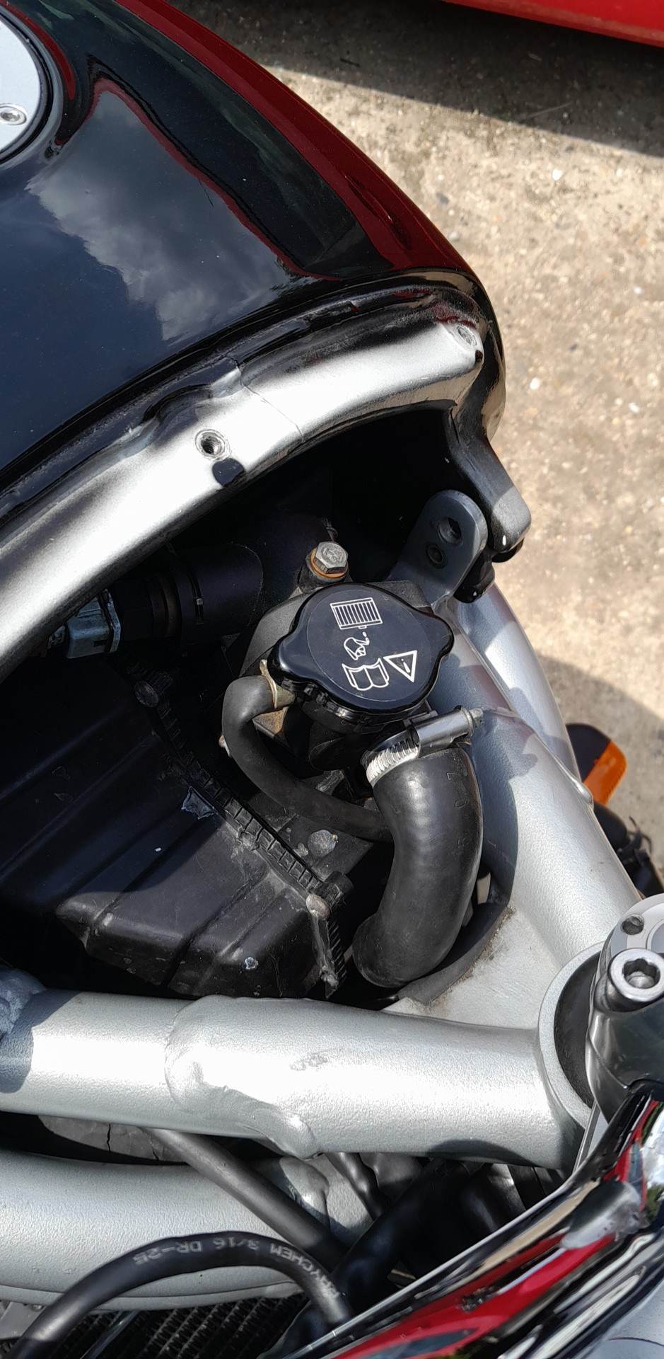

    I'm not sure if these are Triumph one's or aftermarket but they look pretty new and are in good nick

    So a few things that I've found. The thermostat to expansion tank hose was routed wrong and was badly kinked and was pinched between the frame and the tank. I've not got a photo but I took a video of the airbox just resting on top of the throttle bodies and not secured. The fuel pump housing seal although not leaking appears to be the original one by the look of it which is incredible when you see the debris inside the tank which the previous owner, only 800 miles ago paid to be drained and cleaned and the fuel filter replaced. Why on earth the pump, hose and seal weren't done at the same time is beyond me. Finally, one of the breather / drain hoses from the base of the tank is blocked. Again, the previous owner paid to have the drain holes unblocked and "drilled out". I'm sure all of these things aren't helping the issues I'm experiencing with the bike.
