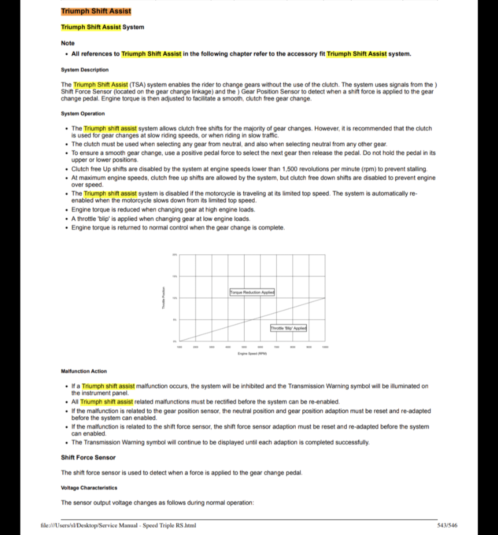

    Mine works flawlessly, and even better after setting the shift rod to the spec in the service manual. I find it works much smoother when higher in the rpms and when completely off throttle on downshifts. The service manual also states that normal easy riding should be done with the clutch. Its more intended for spirited riding from what I gather.

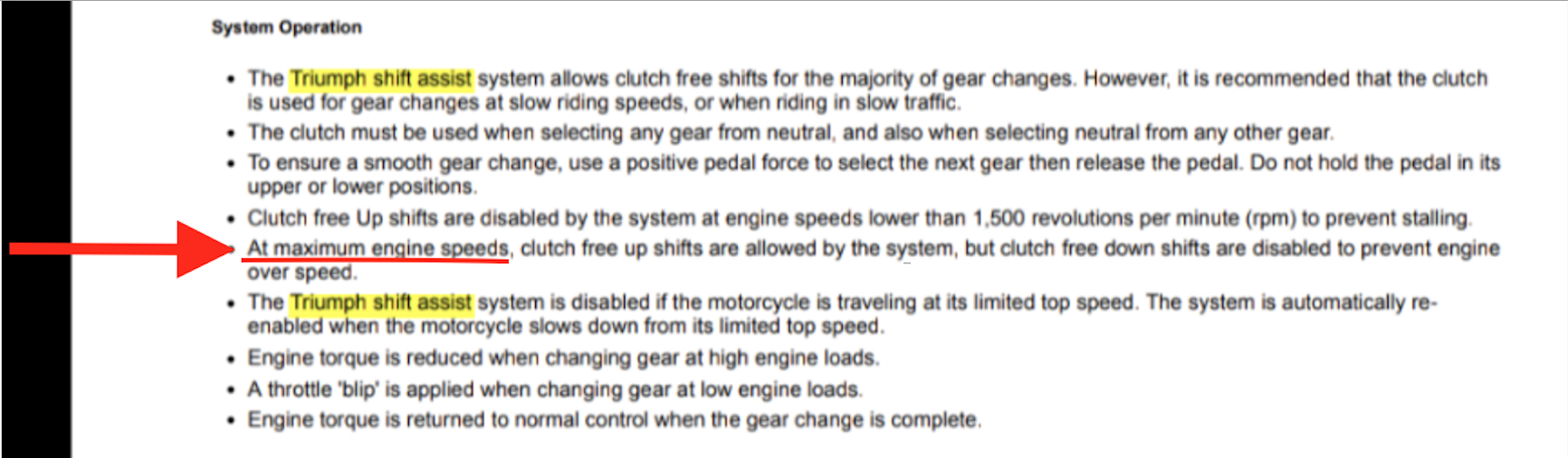

    From service manual...
    Anyone else feel like this info would be better suited for the owners manual and not the service manual?

    Definitely something that should be in the owners manual. Wouldn’t of made a difference though. There was no warning lights or message in the dash on any of the miss shifts.

    Thanks for sharing this, Sean. I definitely agree that this is better suited for the owners manual.

    Oi! That’s my manual! ;)
