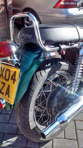

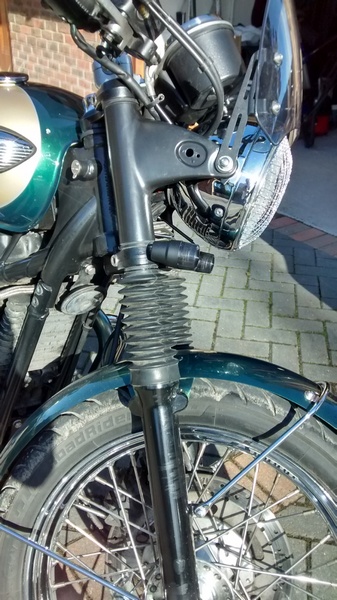

    Have just replaced the stock, oversize plastic indicators on the Bonnie with British Customs black alloy smoked ones.
    Fitted a relocation bracket at the front behind the regulator and instead of fitting the rear brackets off the top of the shocks, (beacause of the grab rail) I fitted them to the bottom of the grab rail fitting. They are farther back which I prefer anyway.
    They come with clear bulbs so have ordered amber ones and the connectors are bullet ones so you need to modify the connection to the loom. I chose to cut the wire to each of the old indicators and leave the original connector in place. I then fitted a female bullet connector to each exposed wire ready for the new indicators - if I add a male connector to the original indicators, I could always refit the stock ones if I ever went mental.
    Have kept the stock rear light for now on the original mudguard IMG_20150217_132012347_HDR.jpg IMG_20150217_132004849_HDR.jpg as I have Scrambler ones to fit once they are painted - also have a Lucas style rear light which will go on then. Have ordered blanking plugs to cover the hole on the headlamp bracket.
