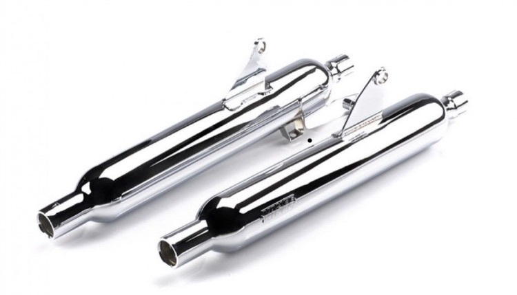

    Hi, may I have a newbie question: awaiting my first Bonnie to arrive in March I just bought 2 V&H exhausts for half price. That's the good thing. No problem to exchange them, but..
    The ugly thing is that I can't get the size/dimensions for the exhaust gaskets and a supplier for them; Athena seems not to have them listed. Gues one of you knows - thanks, Thomas

    The only gaskets are between the exhaust port and header on the engine. The tail pipes clamp up with silicone or exhaust paste.
    Which year/model?

    And you are replacing the headers too?

    No, only the silencers:

    Then no gasket required. There is an exhaust clamp to tighten. Seal the gap with exhaust paste.
