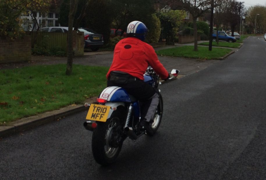

    I bought this for my thruxton, its the led one but comes with indicator brackets and a plug and play loom
    I had the normal lucas style tail light but it proved to be a bit flimsy.
    The indicators are these They look good but the finish quality isnt great, the chrome is peeling and I keep blowing a bulb in one for some reason,, might be water ingress not sure. I have been kinda happy with them but now would prefer ones where the lenses stick out more so they can be seen blinking from the side and the bulbs are cheaper
    you will probably have to get the plug and play wires for your front indicators

    They look nice in the photo. The kit I was looking at has the rear indicators located very close to either side of the tail light.
    Those blue Thruxtons are rare, very nice colour.
  4. crispey
    7,247
    Ta. its caspian blue, custom paint job
    Having seen the ones your going for I dont think you'll need the wiring harness for the front indicators
