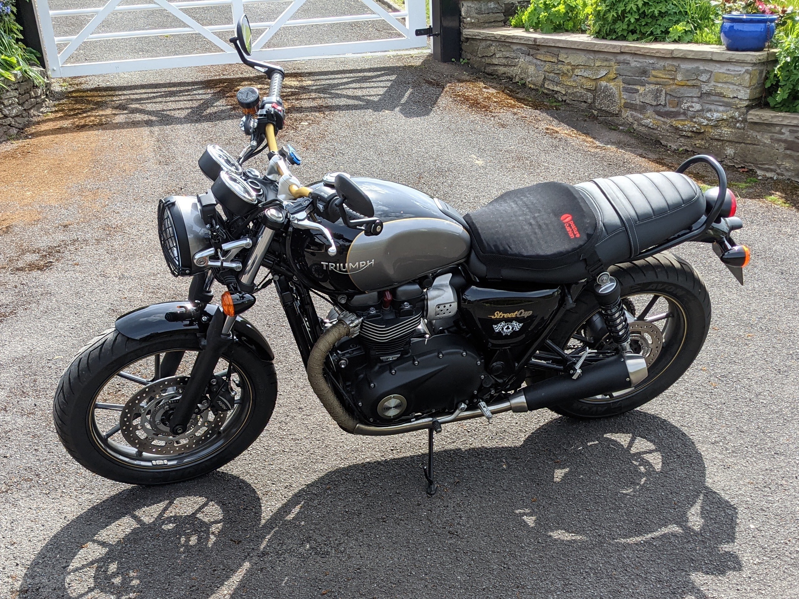

    Hi all,
    After flipping my standard Street Cup ace bars and riding the bike for 50+ miles I have established that the handlebar angle and position is too uncomfortable (as is the standard factory position). I therefore plan to change the bars for Renthals the same as or similar to the Street Twin.
    Does anyone know the Renthal equivalent or have recommendations based on a more comfortable Street Twin like riding position? I already have Street Twin clamps and know I will also need a long clutch cable and brake line.
    Thanks in advance
    Geoff

    In the end I fitted Renthal 758 Road Ultra Low 7/8 bars using Street Twin clamps and an extended clutch cable. I rode the bike 160 miles yesterday and am pleased with more comfortable and upright riding position.
