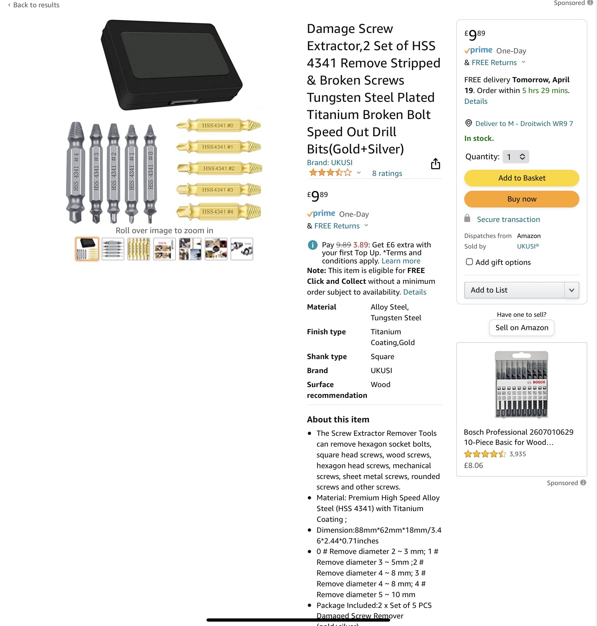

    I've had a fair amount of success using extractors like these

    Try one of these.
    video of similar product
