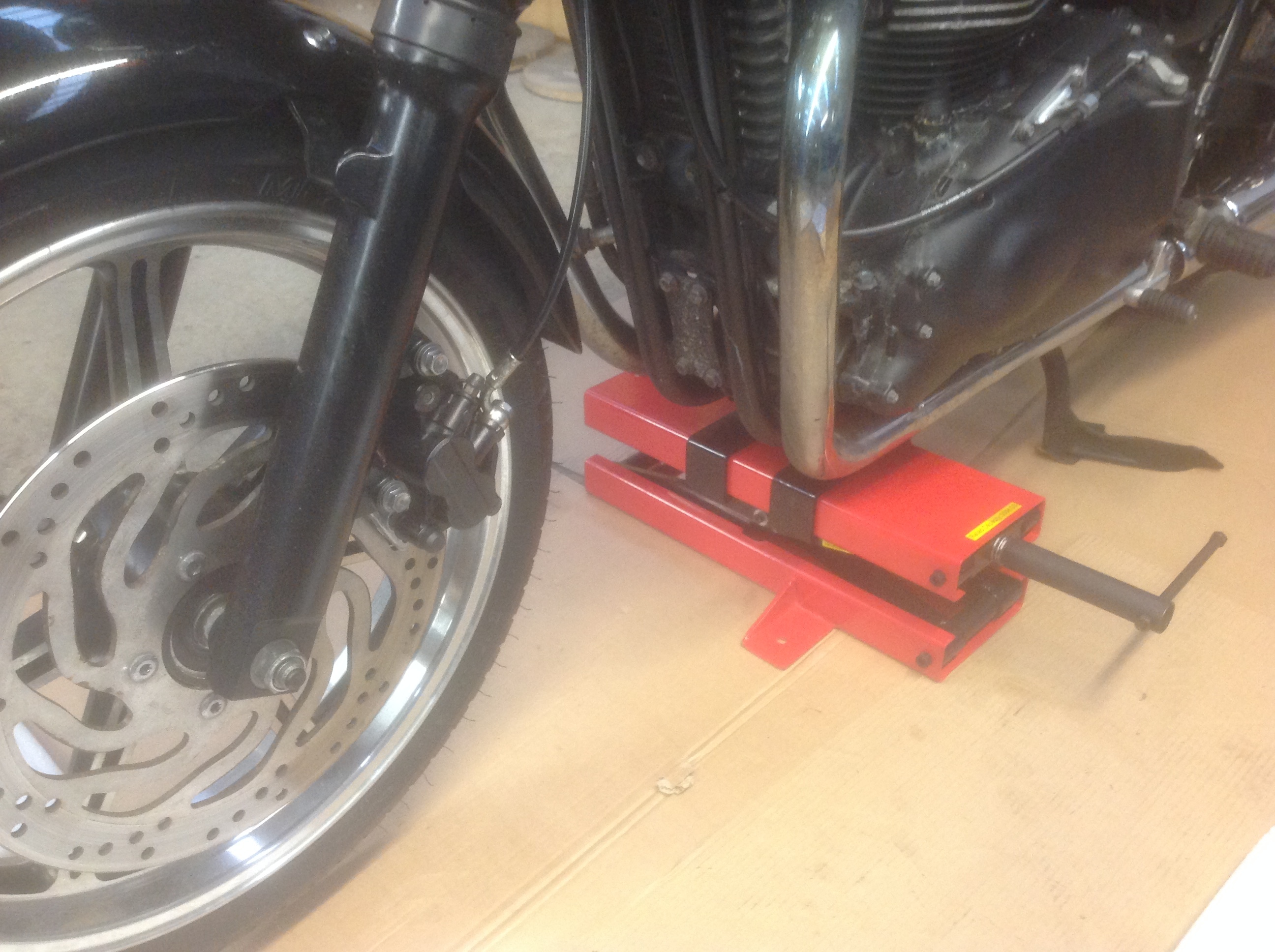

    This is a cheap and safe way to get the wheels off the ground.
    Particularly useful for bikes without a centre stand
    £35 brand new off fleabay
