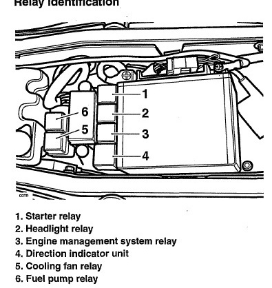

  10. Sprinter
    Sprinter First Class Member
    1,647
    Is yours any thing like this?
  11. David Cockerell
    Dec 22, 2017
    27
    North Dorset
    No it doesn't to be honest Sprinter, the relay in the diagram looks like it could be the same size but the layout isn't the same, my battery is under a cover at the front of the tank.

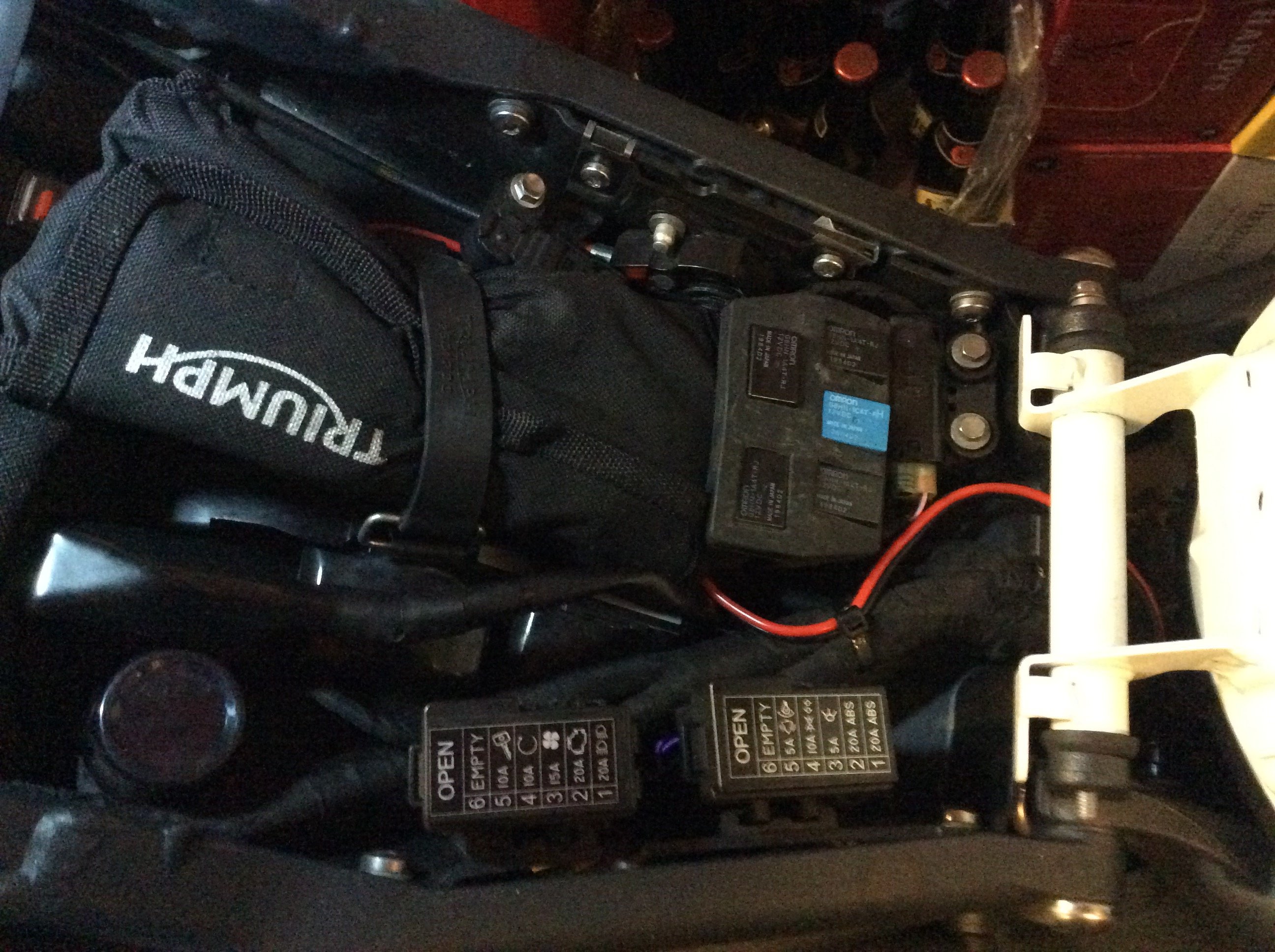

  12. Yorkshireman
    Yorkshireman Well-Known Member
    269
    92E6D797-F674-4AE6-9BE7-BAB3504605E4.jpeg Here ya go, the flasher relay is the round black thingy in the bottom left of picture. It’s an LED relay, the original was square but in the same location
  13. David Cockerell
    Dec 22, 2017
    27
    North Dorset
    Ahh, brilliant, that may be where I've gone wrong as I was looking for a square thingy opposed to a round thingy, thanks Yorkshireman
  14. David Cockerell
    Dec 22, 2017
    27
    North Dorset
    Well chaps, I did find the relay, in my dark shed I'd missed the fact that it was covered by the ecu plug, anyway, fitted the relay and way hey, result, no more quick flashing indicators, thanks for all the pointers.
