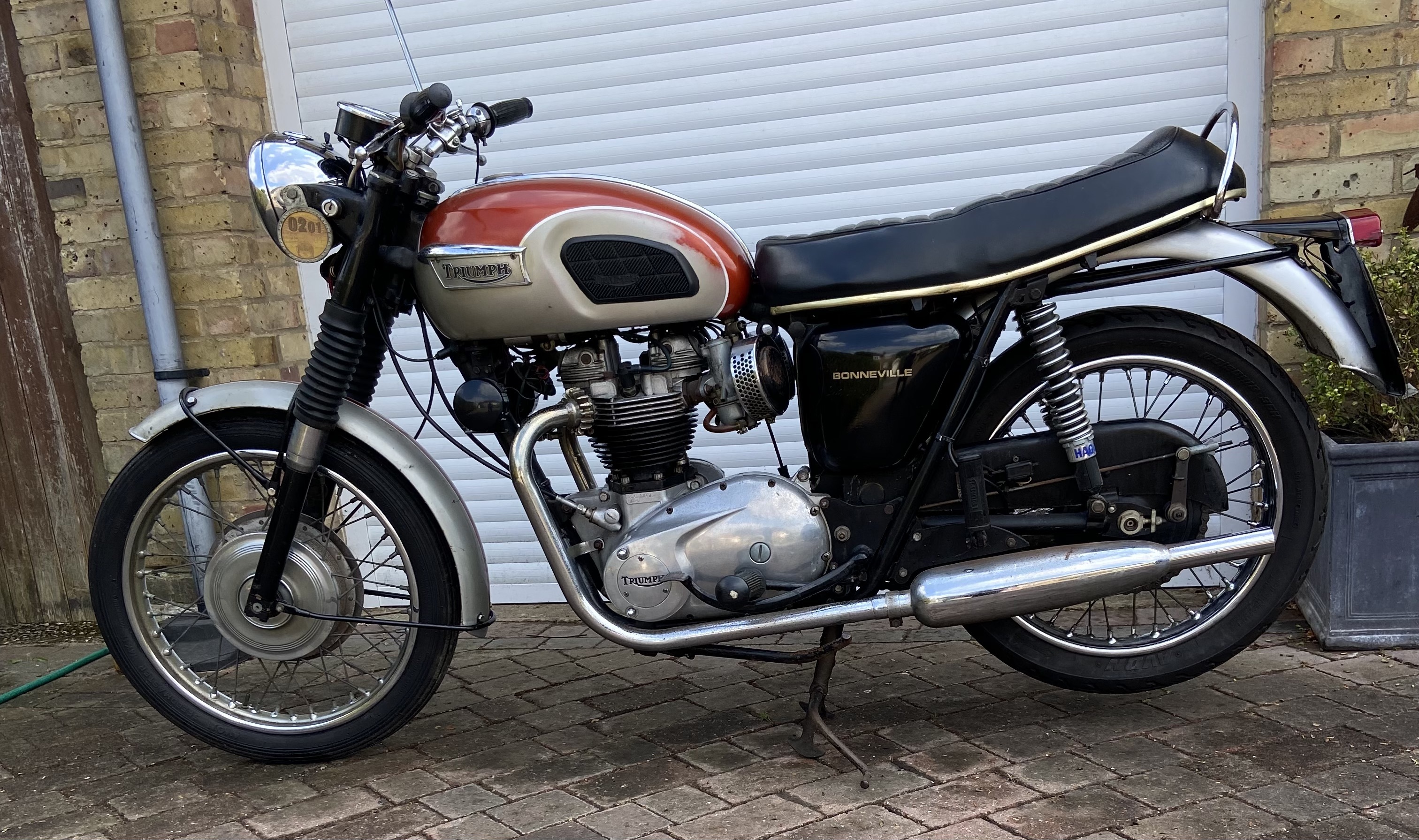

  1. DaveQ
    DaveQ Senior Member
    Jul 28, 2022
    339
    Surrey. England
    This is my ‘other’ bike, a T120 Bonneville which I last used in 2000 and has been laid up in the back of my garage since II completed the National Rally that year doing about 1000 miles over 24 hours to get a silver medal and missing out on the gold by just a couple of checkpoints. When I got home the bike went in the garage and to my eternal shame I haven’t ridden it since. Uncovering it the other day it’s certainly showing a lot of deterioration from lack of attention and needs a lot of tlc to get it back at least to a rideable condition.
    Over the years since, for one reason and another, I haven’t touched a motorcycle until I started in on the T100ss that has also occupied space in the same garage, but in boxes which I naively thought was a ‘mostly complete’ bike. At the moment I think I’ve pretty much run out of patience with it, although it will get finished but maybe not in the original timescale I’d set myself.
    So.. although I know it’s probably a stupid thing to do, and as my efforts with the T100 are pretty much getting nowhere, I’m going to turn some of my attention towards a bike that I know is at least one complete entity and that I’ve got some sort of chance of turning it back into a going concern.

    Close up it’s looking a bit sad I’m afraid. Needs a lot of tlc. My fault. Rear shocks are ok though. :confused:

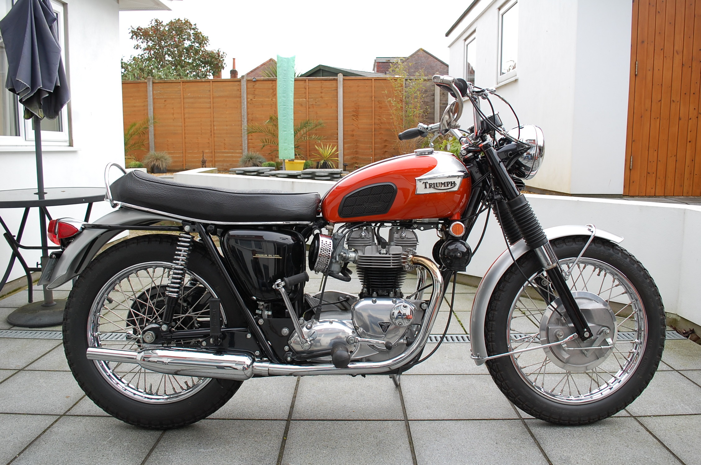

    Rare to see a UK spec 69 these days and it looks original as well, nice.
  6. DaveQ
    DaveQ Senior Member
    Jul 28, 2022
    339
    Surrey. England
    Well, I can’t vouch for what happened to it before I got it but I haven’t changed much. The silencers weren’t originals and were pretty ropey so they got changed. I put Trophy TR6 ones on as I liked their look better than the longer originals. And of course the rear shockers which weren’t doing much at the back. Otherwise it was just routine stuff.

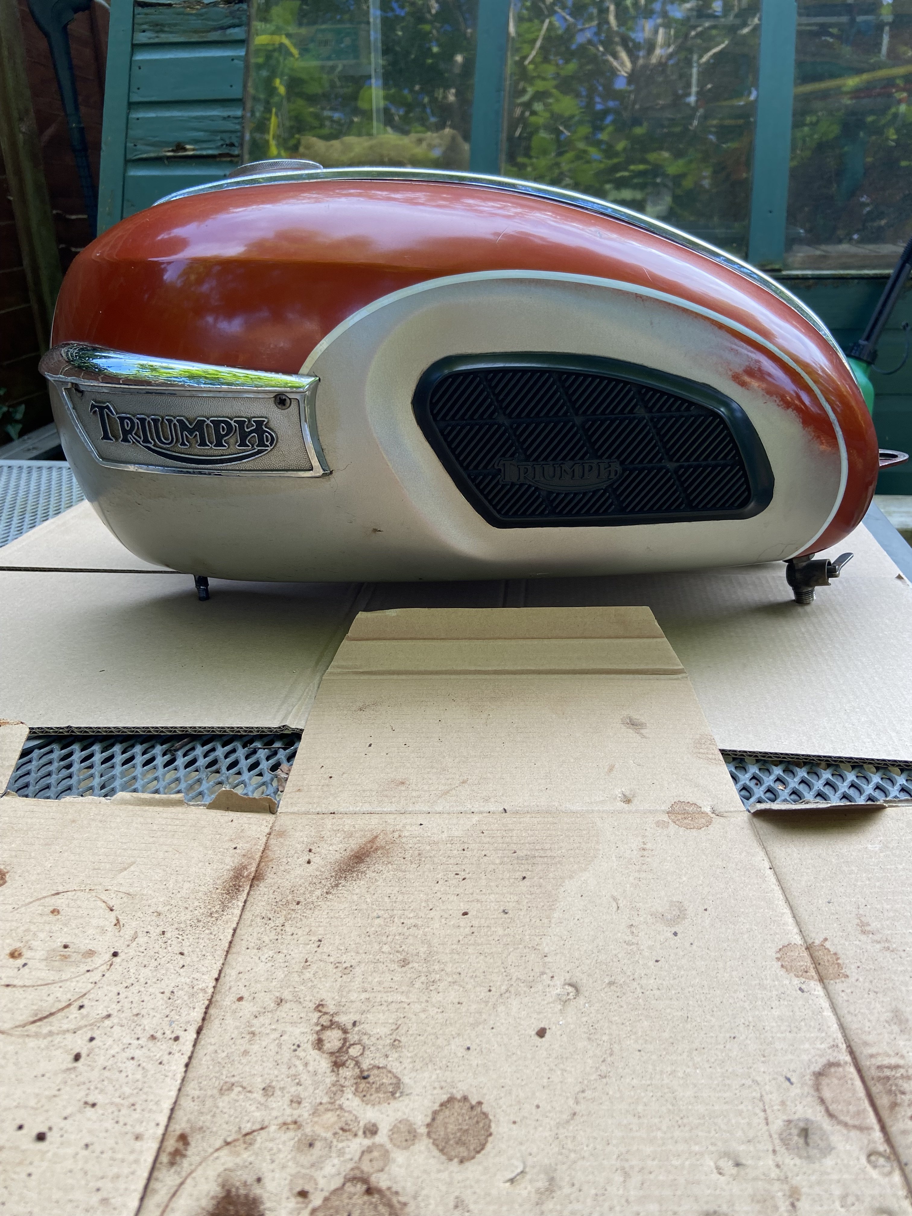

    The petrol tank came off reasonably easily after cutting back the old hardened pipes to the carburettors. Surprisingly the tank mounting rubbers were still soft and pliable, but they’re not going to go again. Equally surprisingly, since I’ve never had to take the tank off before, there’s some damage to the underside paint and the tunnel’s welded seams is distorted outward. It also looks like there might have been a tea break between painting the left hand and the right hand white coach line to the underside. I had thought the paint was original. I’m not so sure now.
    The interior of the tank is very rusty. So far I’ve swilled it out with about 5 litres of clean petrol and removed a whole lot of powder like sediment and there’s still a bunch to do.

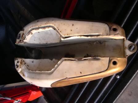

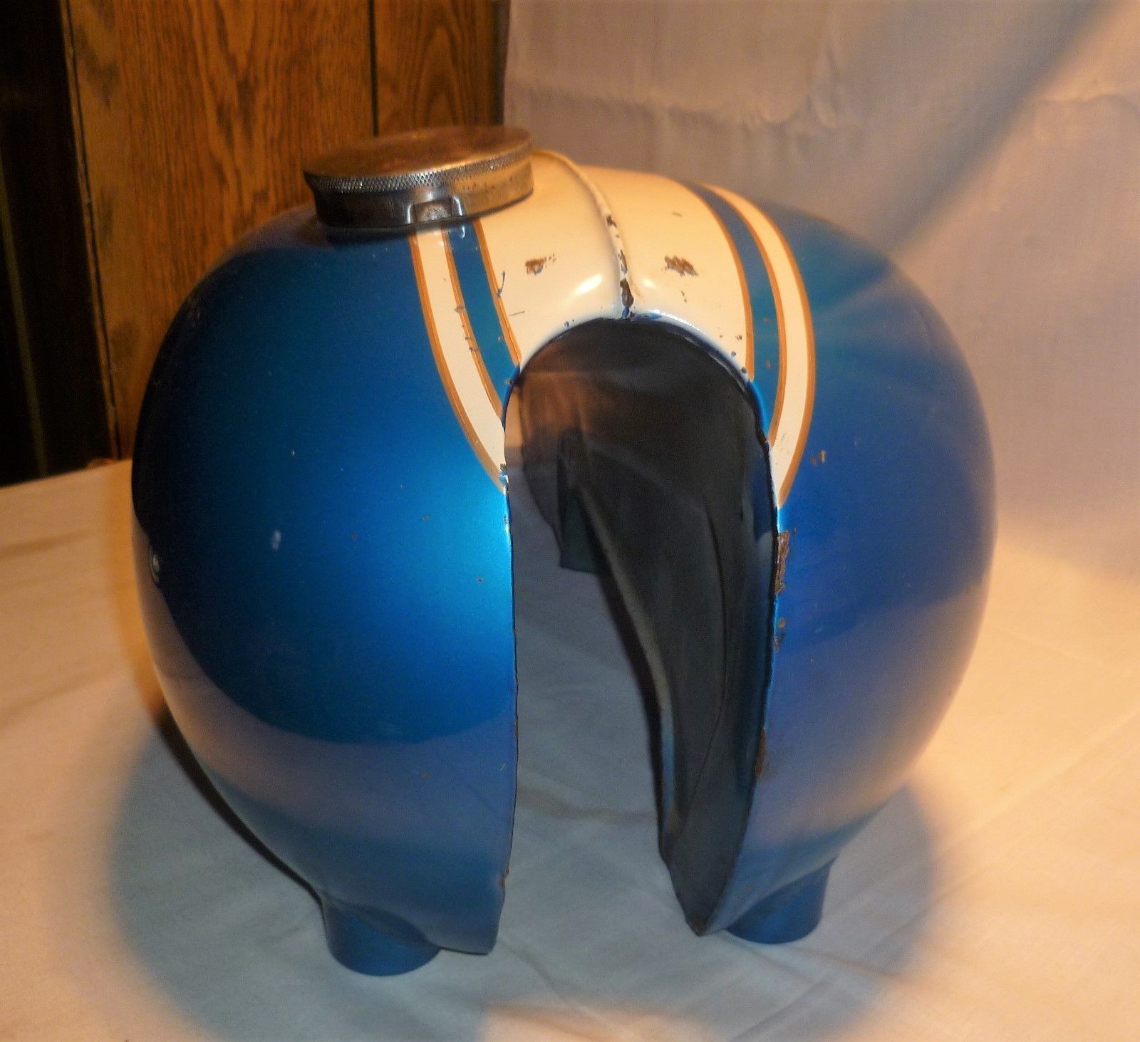

  17. darkman
    7,661
    The two distorted bits on the seams are standard and i'm 99% sure the paint is standard/original as well. All the two-tone paint jobs were done free hand as was the pinstriping. A pic of a 64 tank to confirm shape of seams. And a 66 tank showing how far out some jobs were side to side.

    Thanks for that info darkman. It’s really quite amazing! The carburettor cables and loom are bundled either side in that area and taped to the frame and only just clear enough to get the tank off.
    The coach line does seem to follow the colour split both sides and they’re very similar thickness It doesn’t look like an add-on but I suppose a right handed painter, under pressure, might not get it quite even handed.
    The rubbish in the tank is coming out slowly. but there’s still quite a bit to go. I’ve had vinegar and bolts in the tank for a couple of days (shaken, not stirred) but there’s still quite a bit to go yet. I might try the electrolysis method if it doesn’t come out in a few more days.
