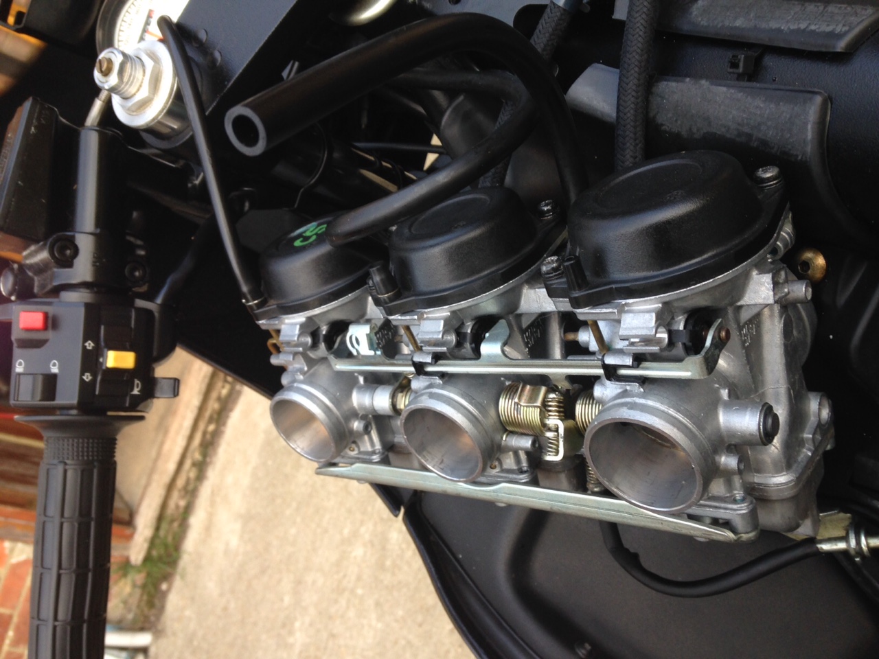

    I have been doing the exact same job as you, bringing a '95 Daytona 900 back to life. The previous (original) owner had stored it beautifully for 6 years but the fuel system was disgusting from fuel tank cap to main jets. On the outside the carbs were in a beautiful condition but the fuel hoses were hard and brittle, as were the fuel supply T pieces between the carbs and the pet cock was so badly seized I had to renew it, (£80+ ouch!). I think this is common with a Suzuki part but I was in a hurry. 2 of the 3 pilot jets, the emulsion tubes were part blocked and so was 1 of the main jets. The bowls were full of disgusting crud. Removal of the carbs is a pain but if you go slowly and pay attention you shouldn't have a problem. TAKE MANY PHOTOS. Many of the O-rings and seals disintegrated upon removal. Kits in Viton are available from NRP. If you look at all the myriad sites on YT you will see what to do and what not to do. I cleaned the carbs with an ultrasonic cleaner and then blew out every orifice and jet with carb cleaner. You should renew the interconnecting fuel T-pieces as well as the little filters in the leg of each tee. I used the cheaper, external cotton braided fuel line but it does have a tendency to collapse and I would suggest you use the reinforced nitrile stuff (ID 6mm OD 13mm sae j30r6) with new spring clamps. Be sure to clean and lub. the fuel filler cap, I got mine open after a couple of hours but they cost a fortune to renew. The bike has done 17k miles and I didn't need to renew the float valves. Prime and run and you should have years of trouble free service. Once I'd got it idling well and revving hard I filled my fuel tank with a double dose of Redex and sprayed carb cleaner down the air inlets. I don't know if this helped but I thought it would clear through any dislodged crap. Good luck with yours.

    Hi Andrew, I'm sorry to hear that you had to take it to a shop. Make sure that you get your old carbs back.... complete! I don't know what your mechanic means by "knackered" but as long as the castings are all intact they are always repairable. I've included a photo of mine without the choke bar before they went back in. If you want to send me the "knackered" ones I'll give you an idea of how much it will cost you to put them right. I reckon I could get your knackered ones looking and running like mine for less than £200. Don't forget, make sure you get the old ones back. Next time you find yourself in such a predicament take the carbs off and ship them to a real expert like JRS.uk.com, he's done some lovely work and has a reputation to defend. Good luck. Paul IMG_0113.JPG
