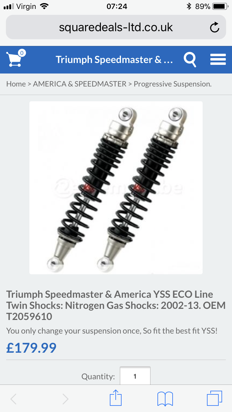

    Ok so I’ve just changed my mind :confused: again
    Can’t find any negative reports on these :) so I’ve just ordered a pair :eek:
    Cheaper than the rest but it’s a cruiser at the end of the day and it’s not like I’m trying to improve my lap times or something :eek:
    Got one of the original shocks off my bike and measured it eye to eye and it’s 12.5”
    The progressive ones that I was looking at in BLACK :cool: are 11.5”:confused:
    Don’t want to alter the ride height either up or down so YSS it is :)
    Hopefully I’ll get the smoother ride I’m after.....gotta be better than standard which might as well be bits of scaffolding bar:confounded: they’re that harsh :confounded: D0765EFF-C92C-4C5F-8CE7-3A75CB521DBD.png
