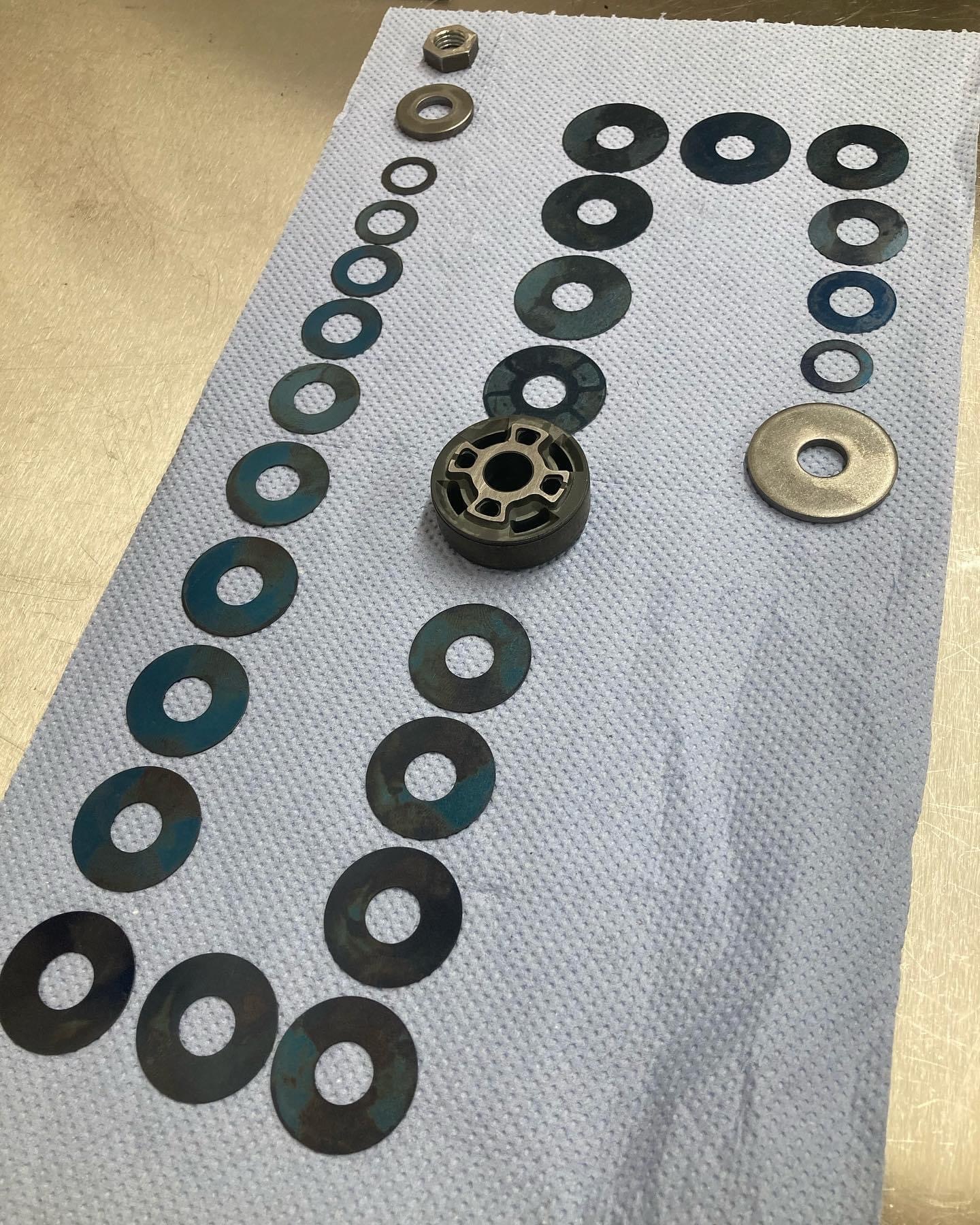

    been offered a rear shock from a 2010 R that has just been fully serviced and revalved to suit almost my weight
    question is, would this fit onto. 13-16 standard street? Getting it for peanuts
    thanks

    Al let you know tomorrow. It’s been revalved for the 170-180lb mark. Have the receipt for the full service and revalving of it. Al ve honest al be gutted haha. Obv won’t get all the money back for it but if I can get what was paid to have the work done (don’t expect to get the money on top for the actual shock) then al be almost happy. The suspension tech pretty confident it ain’t gonna but it’s in to have forks serviced
