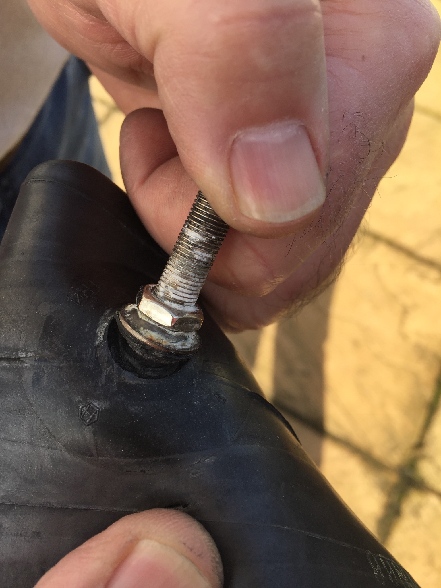

    Last Saturday out on a ride I got what I thought was a puncture.
    Luckily it was in the rear, It went flat within 3 seconds but fortunately at the time I was in a 30 zone (and doing 30!) and not banking for a corner, so I stop, under control and still upright. Called the RAC and I was back home about 3 hours later.
    Dropped the wheel out on Sunday.....checked it over and could find no evidence of nail/screw/ sharp object that had caused the flat. Took it to the local motorcycle tyre specialist today, they whipped the tyre off and thankfully no damage to it......it's only done 849 miles from new......and there was no sharp object puncture in the tube.
    However the valve had nearly completely detached itself from the inner tube!!!......it had not torn off.......but it had simply come unstuck.....check out the attached photos......clearly it had not been vulcanised correctly onto the tube.....a one off?.....maybe......but who knows?.......
    I know the tyres were at the correct pressure since I checked them pre-ride.
    Also from the pictures see how much salt/dissimilar metal corrosion there is on the metal of the valve and I am a fastidious bike cleaner if I know there is any salt about.
    On the inside of the rim where the two ends are bent round and it is butt welded together to form the rim into a circle there were sharp edges left, these were filed and sanded down before re-fitting the new inner tube and tyre.
    I will be sharing the photos and facts of the incident with the Warranty Department at the Factory. I am not very pleased at all about the cause of this failure........how many other tubes were in that production run?....
    Cheers,
    dickydido

    Howdo DD, that looks like the rubber's torn at the base of the valve from here . I had a rear puncture not long after I got mine, valve ripped but I found a tiny hole elsewhere too . No sharp stuff found, the tyre is still on -with no more flats .

    The rip could be down to the rear tyre slipping on the rim and dragging the tube with it :-(

    One great idea is to use 3M tape and go tubeless, if not a good tip is to clean all tyre fitting lube from tyre n rim before inflating tyre onto the wheel rim :)

    Is that nut meant to be in that position. It’s been a long time since I’ve had tubes on a motorcycle, my mountain bike has tubes, and but the thread doesn’t go all the way down, but from memory isn’t that dome shape supposed to fit to the recess inside the rim with the nut on top, I.e outside the rim, to secure the tube in place? It looks from the residue in the threads like it hasn’t been screwed on after the tube has been removed, or that there was a securing nut on the outside?
