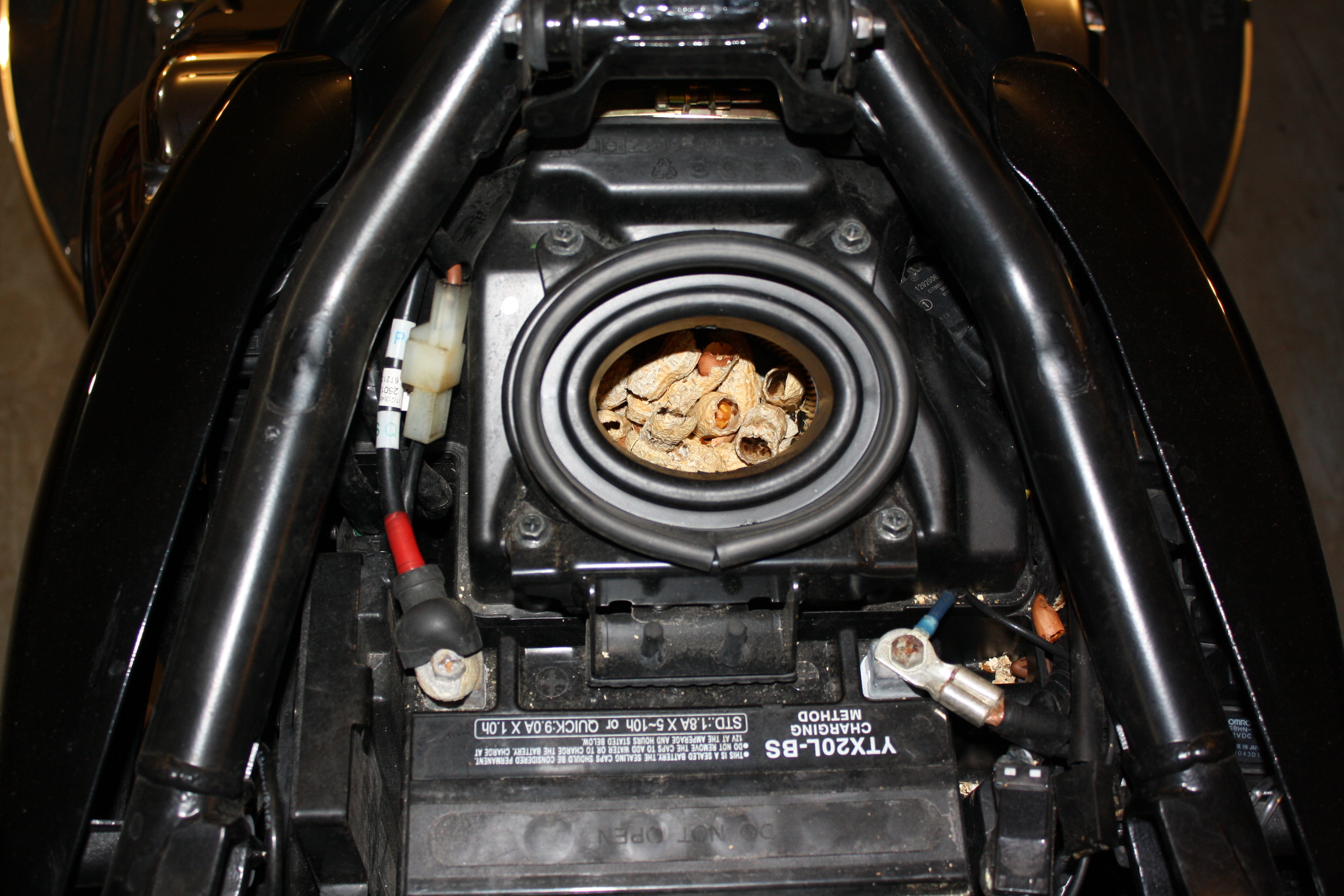

    Sorry, but that sounds like a challenge:) Two years ago, I took my seat off and this is what I found in my air filter. I feed the wildlife (foxes, opossums, racoons, turkey, birds, squirrels, and deer) around my home. During the winters, mice come into my garage and in the crawl space under my home. We live trap them and move them a couple of miles from the house, but until we get them, they make themselves at home. I know I should just kill them, but I don't have the heart. I reserve that treatment for things that should know better:)
    Proof that there was a mouse under my seat. Why they would go to the trouble of walking over to the bike and crawling up to the air cleaner is beyond me.
