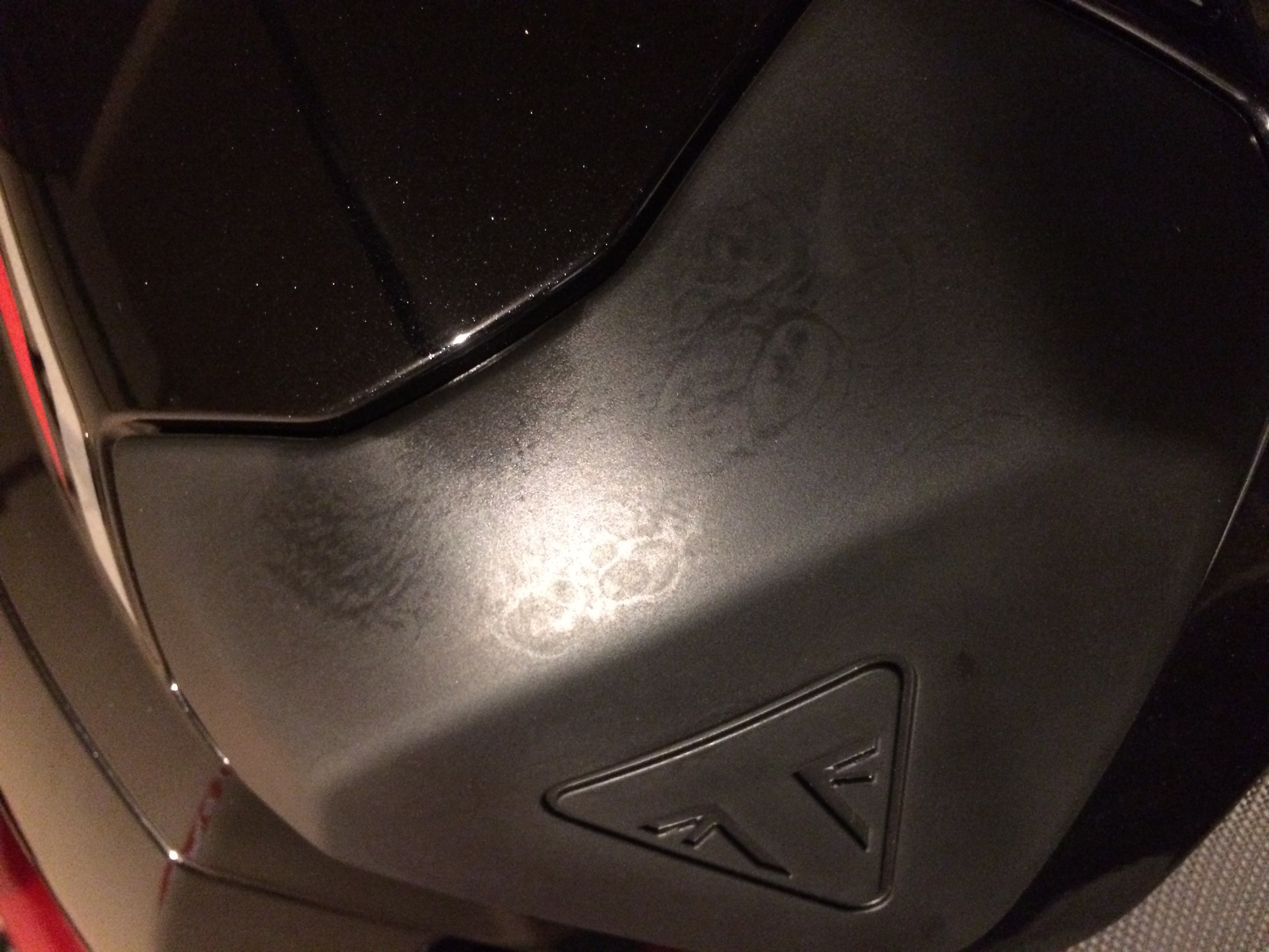

    Has anyone else with a 765 got a strange patterning on the top of the pad on the rear seat cowl. The picture isn't great but on mine it's quite unsightly in the flesh. I've tried to clean it off but with no luck. Any suggestions as to what it is and how to get rid of it?
  2. Scoot65
    Scoot65 Well-Known Member
    Dec 3, 2015
    237
    DURHAM
    Looks like a liquid of smoking has been allowed to dry on / evaporate.
    Soapy water? cleaning fluid? etc etc

    Looking at your picture though......has their been a sticker on there it looks like quite a uniform pattern?

    It looks like it has either had some liquid on there that has not agreed with the plastic or it is moulding contamination from the injection moulding process. (Mould release spray or similar)

    +1 with mickeng, would say it's release agent from the mould.
    Substandard, needs replacing, give em shit until they do. :tired_face:

    There could very well have been a batch made that have all got this cosmetic quality problem.
    As this part is the visual 'A' face of the moulding the parts should have been rejected and not passed through quality inspection at the moulders.
    If they did get to Triumph, Triumph Q/C should have rejected them and demanded a new batch.
    This needs a strict and determined Q/C manager at Triumph to look retrospectively at the problem, so you need to make a formal complaint.
    There could be thousands from the same batch in the system so replacing it with another poor one is not the answer.

    I spoke to my dealer today. Apparently the warranty claim was issued and accepted so just waiting for a new cowl to turn up. Hopefully be here for my first service next tuesday.

    New cowl has arrived and will be fitted when the bike goes in for the service, which is fair enough so pleased with the outcome, providing it isn't the same as the one that's fitted! Famous last words...Anyway, will get those images posted as promised. :)

    Mine was exactly the same. The dealer got a replacement rubber and stuck that onto my seat cowl, it took 2 minutes.
    It looks perfect now.

    I finally got my bike in for it first service today. The dealer has changed the pad on the rear cowl and all looks good.
