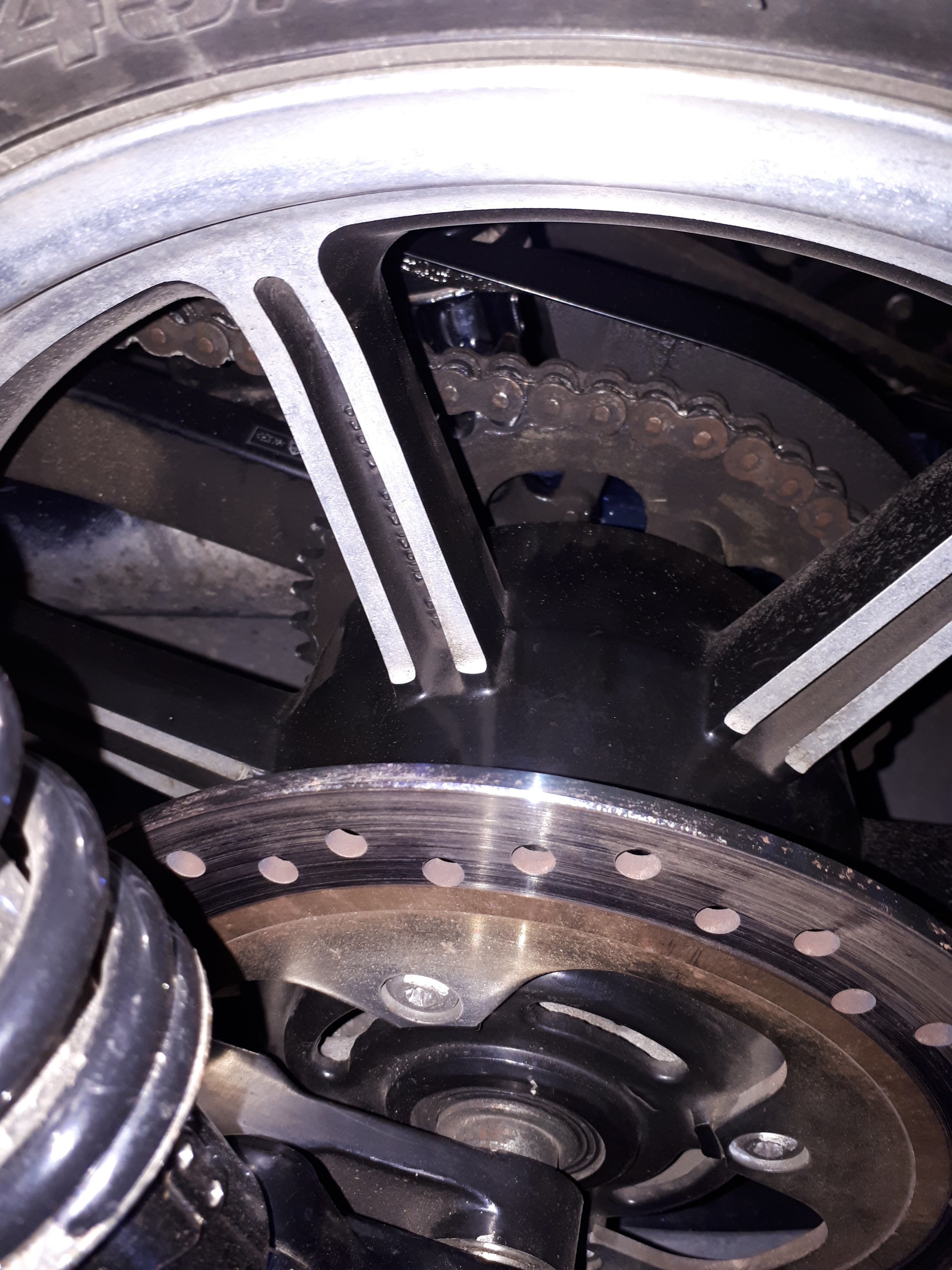

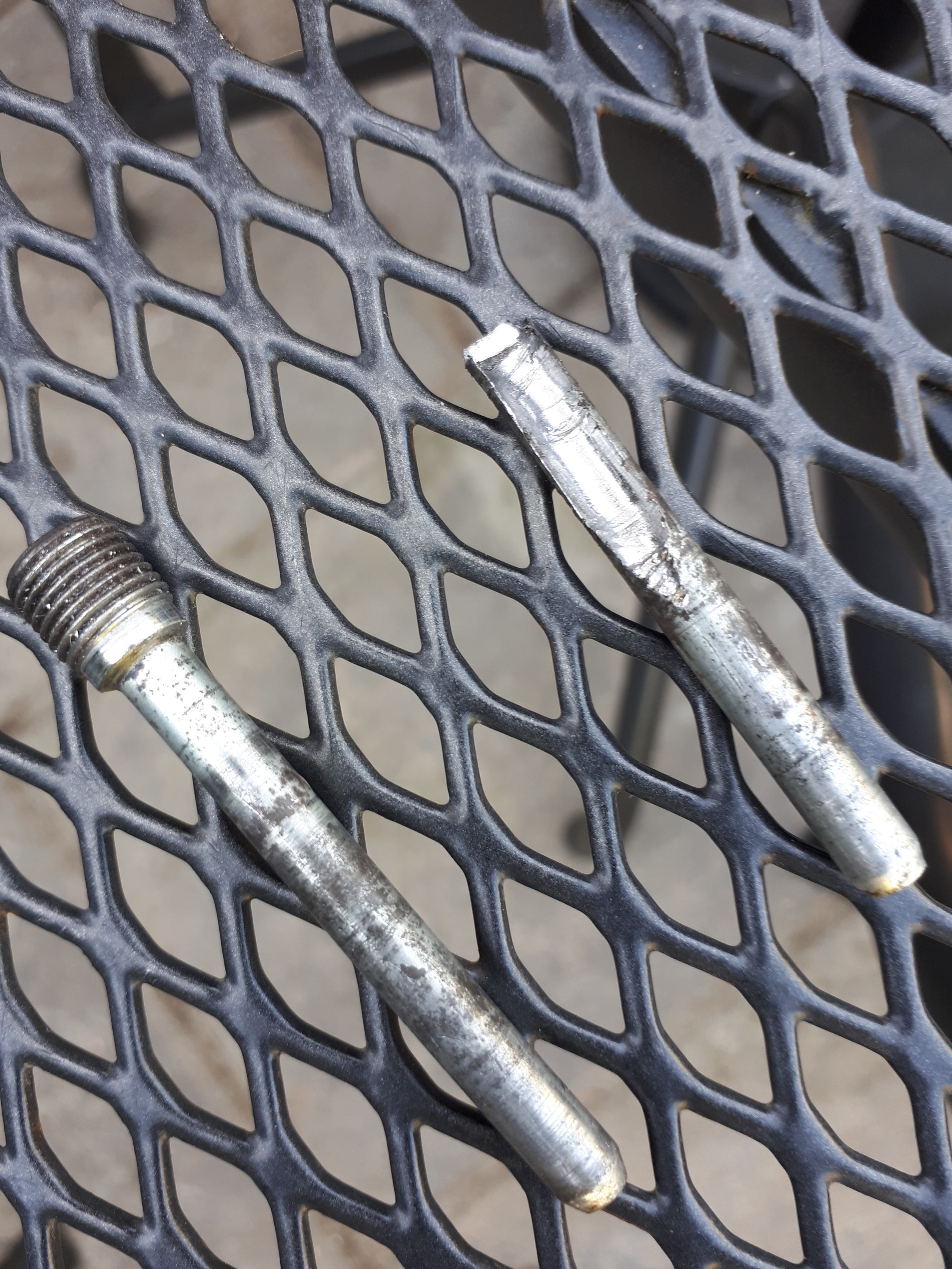

    Get off the bike and the rear brakes are smokin' big time - the disc is actually blue. Leave it all to cool down and then take a look. On the centre stand and I can barely turn the rear wheel by hand and the brake pedal is almost solid when you try and push down on it. I manage to get one pad retaining pin out with my limited tool kit but the other one rounds off!
    Thankfully borrow a socket set and a set of hex keys and have the caliper off. The pistons are seized solid and nothing is moving so not much else I can do. Unbolted the banjo nut and no fluid comes out. Get a jar and pump the pedal and eventually with a "gush" all the fluid comes out and the pedal is free. Rode home with caliper in the rucksack and the hose cable tied up to the frame.
    Looks like I could need a new disc, will need to drill one pin out of the caliper and then if it's salvageable a seal kit and new pistons probably. Going to look at it properly this morning. May now consider the Motone caliper relocation bracket as well!

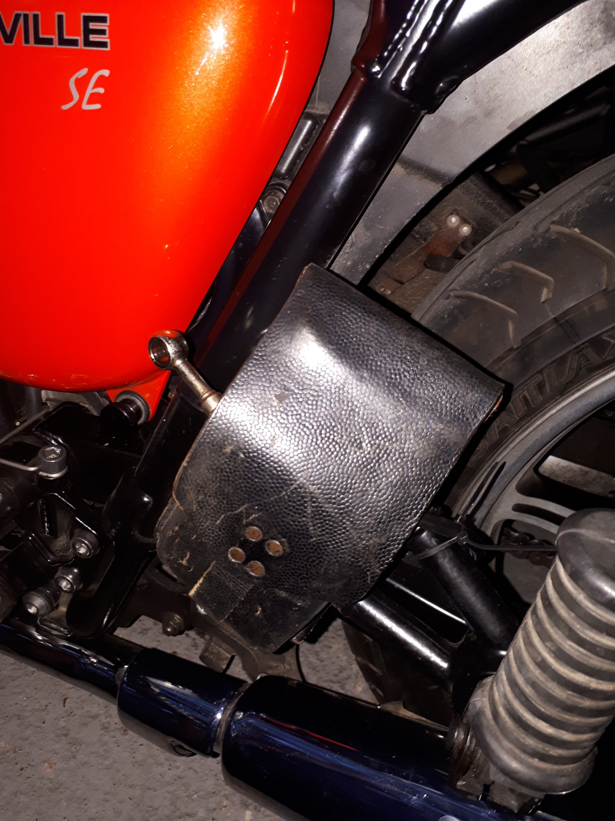

    Doesn't really look blue here (but it is)
    How to get home!

    Caliper is OK - cleaned up well and old retaining pin is now drilled out! Pistons pushed back in by hand so they probably aren't seized - suspect the brake hose!
    Ordered new one and new pins and will check the disc to see if it isn't warped.

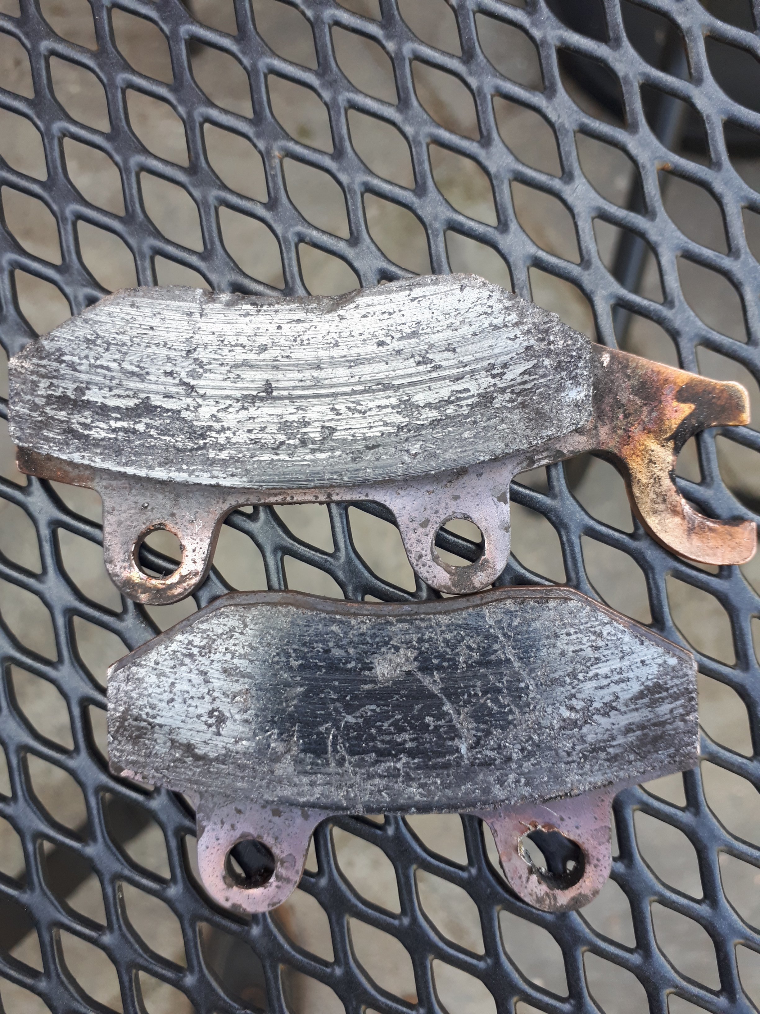

  17. steve lovatt
    Slightly glazed pads and remains of the retaining pin.

    They are buggered, they are!:eek:
  19. Yorkshireman
    3,405
    That’s what I would point the finger at given your explanation.
