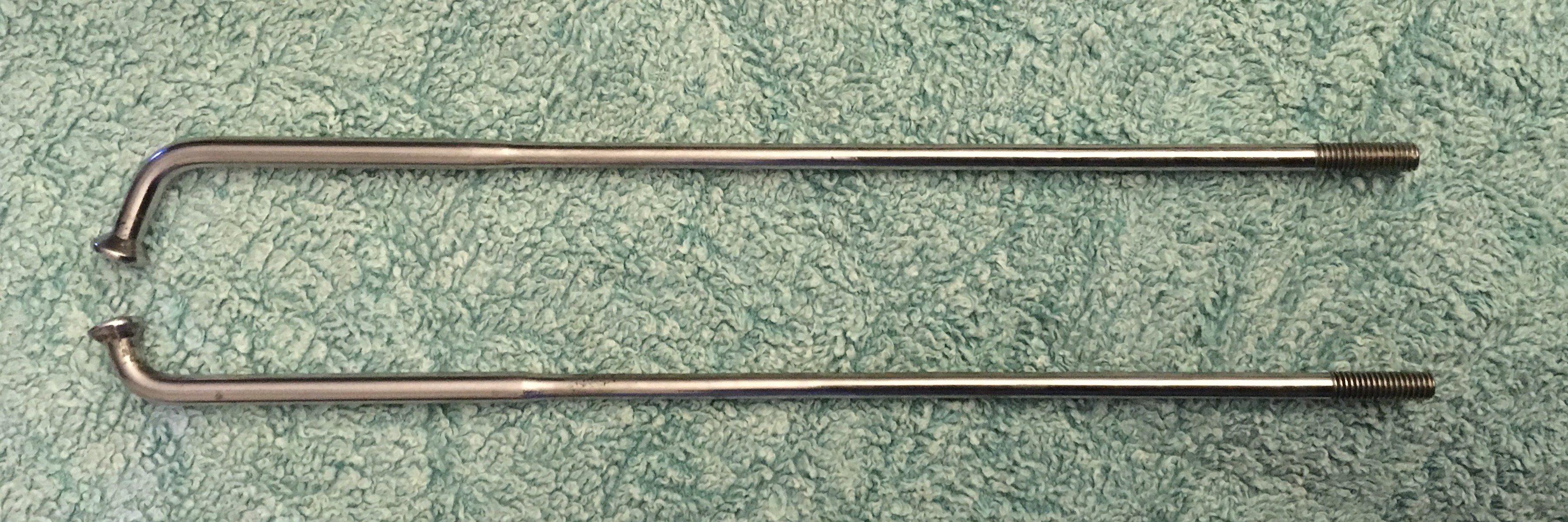

    Hello all,
    In the process of a tear down, so decided to unlace and get the hubs vapour Blasted to clean them up and am now looking to relace.
    It was not until I removed all the front spokes that I realised that there are two types of heads.
    They are very close in length with only the necks differing. Can I please ask could soemone advise what side of the hub for each of these two types of spokes.
    Many thanks
  2. Dazzzzz
    Dazzzzz New Member
    Apr 2, 2018
    4
    Australia
    Now realise that they have a longer neck because they overlay the shorter.
    Same side hub, long, short, long, short....repeat
