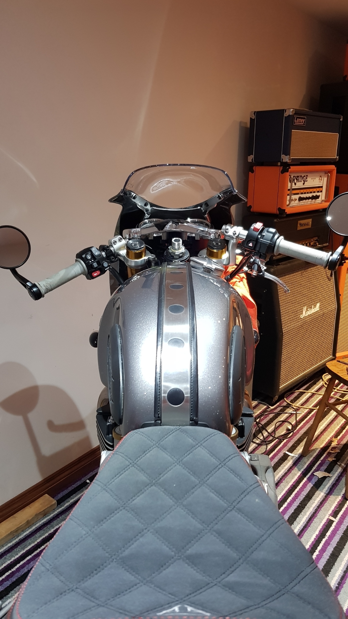

    I knew I had a picture somewhere! 1 low and 1 high riser for comparison. You can see the clocks still attached to the yolk complete with tape to avoid scratches
