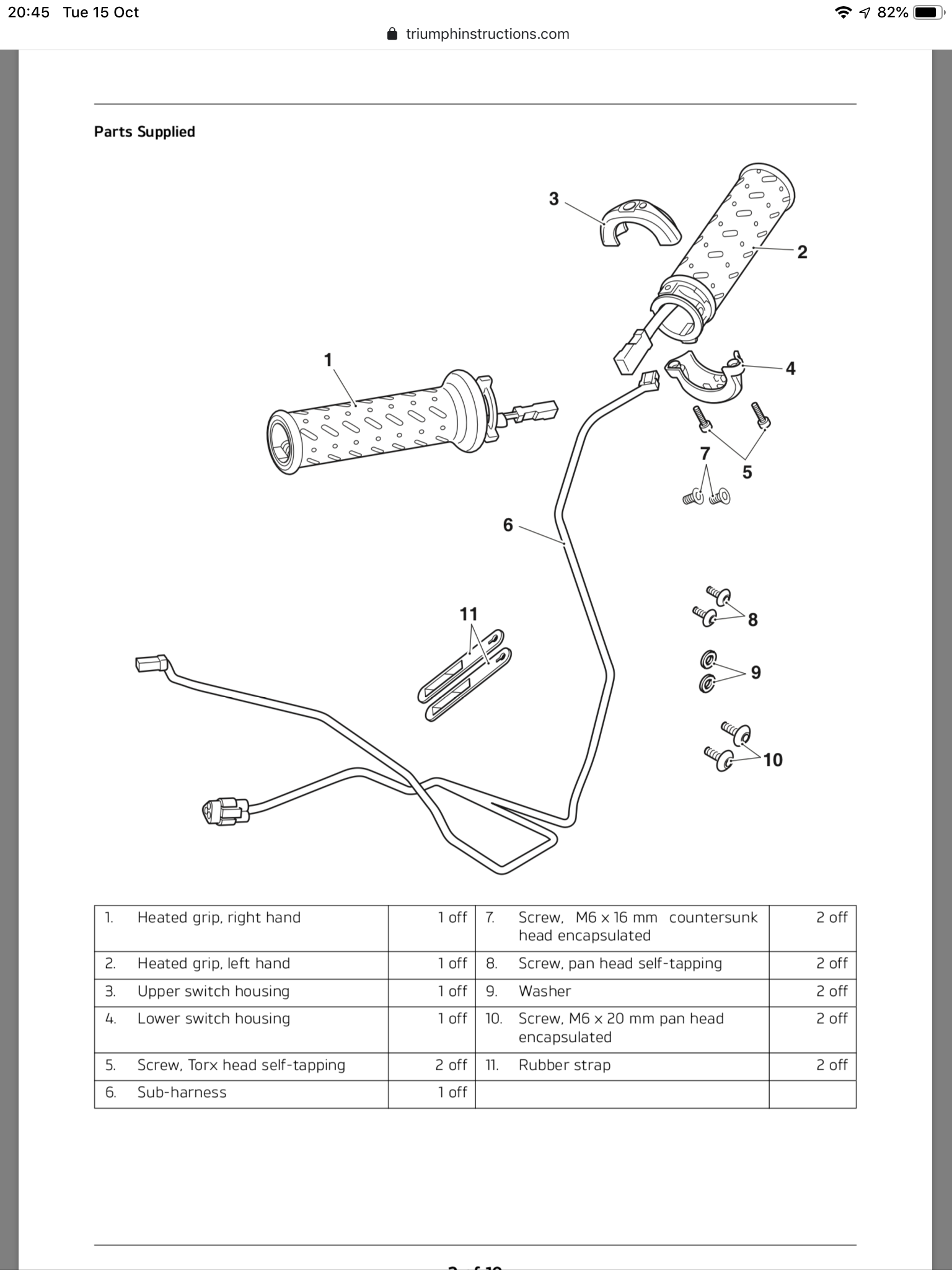

    One more question, do these have the on/off button on the grip? I looked at this model # on the Triumph accessories page and it didn’t look like it had the button.
    Has anyone installed Triumph heated grips on their bike themselves? Just curious how difficult it is.

  15. Captain Trips
    Captain Trips Member
    Feb 4, 2019
    74
    Surrey, UK
    Hi Steve, the pictures on Triumphinstructions.com for the RS version show a pair of buttons on the grip. See below

  18. Ducatitotriumph
    Apr 25, 2019
    2,181
    Rothwell
    #18 Ducatitotriumph, Oct 17, 2019
    hi steve, there is only 1 button that you cycle through for the temp. 1st press is hottest, and if you want less, press it again. On the forth press, its off. 1 press again and it'll cycle through again.
    There is a grip displayed in the tft showing this after you install them.
    Speed RS btw.
    Easy to install and nothing to worry about.
    I had to support the bars as i found it easier to install the RHS grip wire with them off as its bending at a 180 degree angle if you don't and almost impossible to thread through the small hole in the bars.
    Genuinely makes it a doddle that way.
    However, great to have BUT they seem VERY thin rubber and I don't think that they'll last too long.
    From previous knowledge though, i'd recommend the OXFORD ones as the battery location is perfect for hiding the cables and they are way hotter and thicker.
    Also WAY cheaper.
    Downside, no display on the tft and you have the small square control unit to mount but at 1/5 of the price and will last far, far longer.....

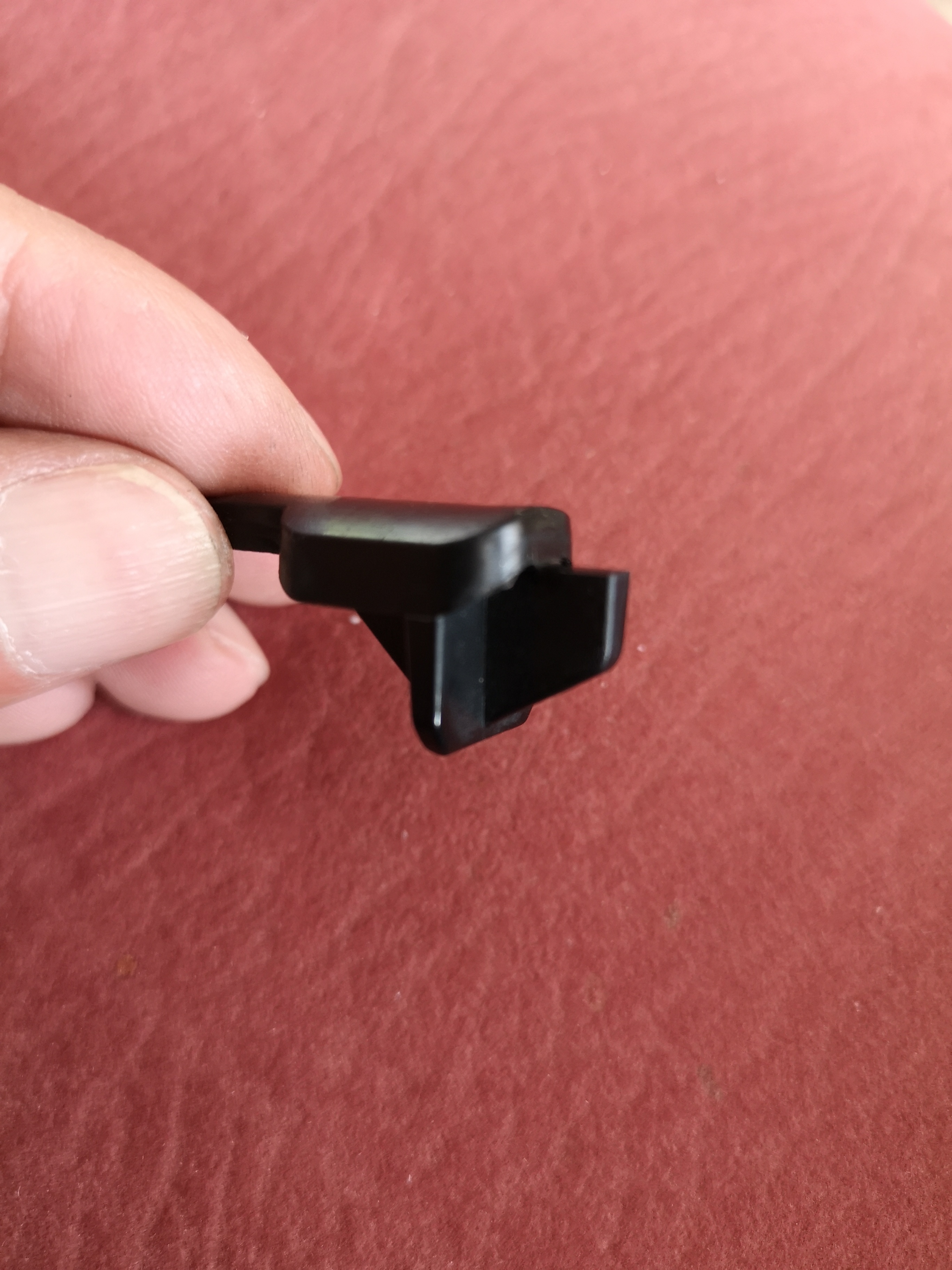

  20. neilb
    neilb Active Member
    Oct 8, 2019
    185
    Billericay, Essex
    #20 neilb, Oct 18, 2019
    Install finished and they work. They don’t have the “burn your palms” heat of the Oxford grips but I think they’ll do the job.
    A straightforward job with the only PITA part being removing the blanking plug from the harness connector....easy when you know how but much cursing up to that point.
    This plastic bit landed on the floor when removing the left side mirror and grip. Can't see where it came from. Any clues, anyone?
    Edit: Now identified from the online parts......it’s a plastic plug. Must remember to put it back!
