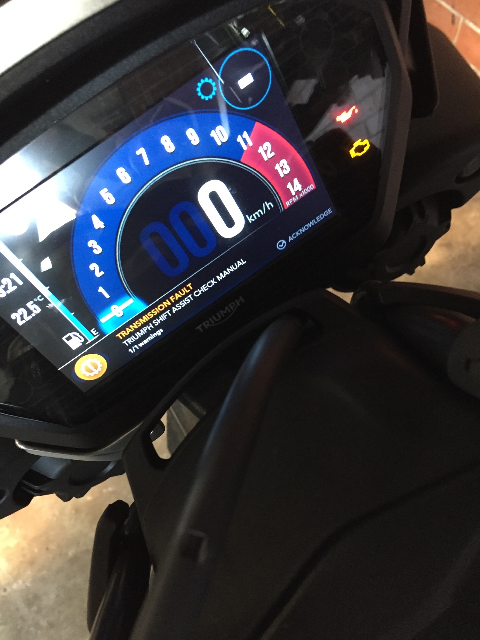

    Went for a decent ride today, on the way back the dash lit up with all sorts of codes.
    QS disabled, traction control disabled, no gear position was on display , there was just a line where the position is normally displayed. so it’s gone to the dealers for them to sort.
    Anyone had similar?

  6. James Fan
    James Fan New Member
    Apr 23, 2019
    Sydney, Australia
    Hi Andybow
    Has your QS issue been sorted out? I had the same issue with my Speedy RS - was riding at 80kph (50mph) in sixth when the same warning lights came on.
    The additional issue I have is that the bike doesn’t start with the kickstand down (even when the bike is in neutral - not that the dash shows what gear I’m in).
    The bike is only two months old so I’m going to take the bike back to the dealer first.
    James

  11. James Fan
    Apr 23, 2019
    Sydney, Australia
    Took it back this morning and they spent an hour on it. Seems to be back to normal now. They said they played around with the gear position indicator without going into specifics. However, they also said that if it plays up again, they will need to fix or replace something.
    I had always thought it was an electronics problem, given that the bike felt fine mechanically.
    Here's hoping it doesn't come up again.
