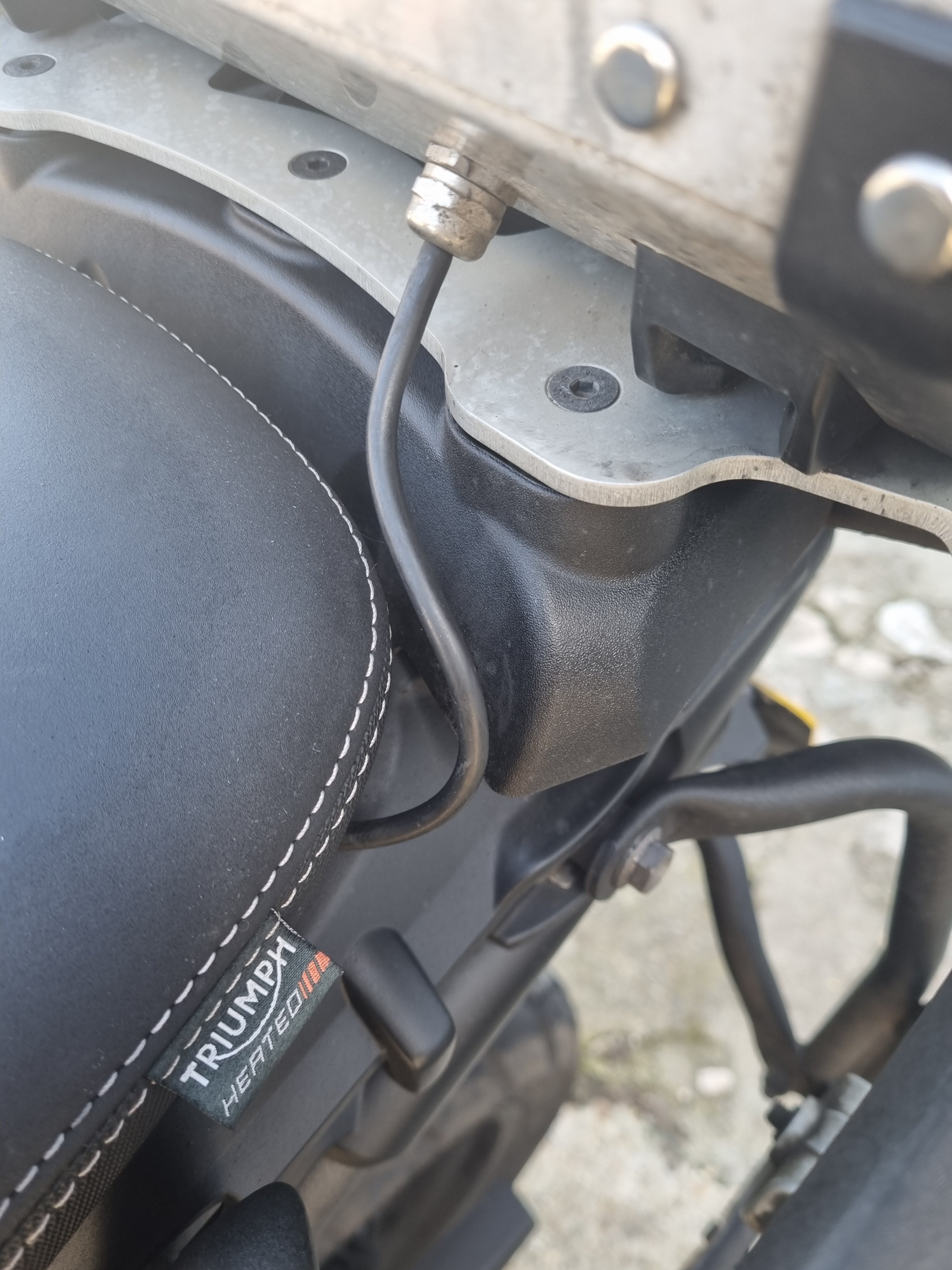

    Hi, I bought a Tiger 800 XCA last weekend and love it, few questions though.
    I have a fog lamp out and can't find a link to a replacement ?

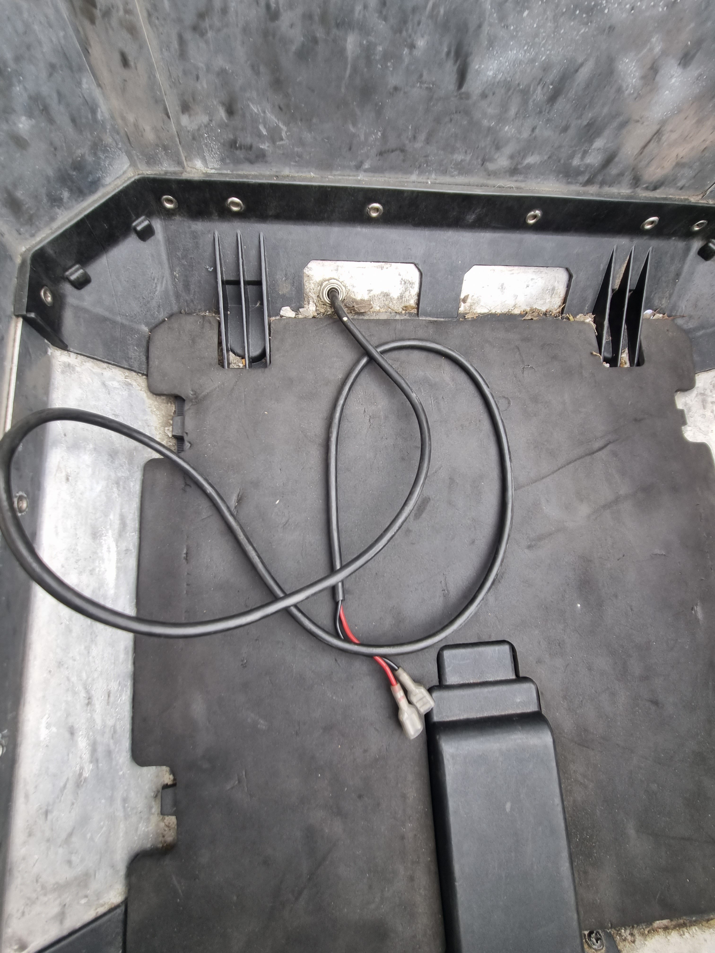

    Also It came with a powered top box which I gather is only supposed to be on the 1209 explorer, but it's connected, to what I'm not sure but it's def connected, what can I plug in and how (see picture)

    Your second query regarding the powered top box, this looks like a home made addition, the genuine Triumph one had contacts under the top box and a socket on the plate so that it disconnected when you took the top box off.
    You need to check whether your leads are powered all the time or just ignition live and you need to check the feed and fuse rating to see what load it can carry.

    Thanks, the fog light has randomly sorted itself so I'll dig a little deeper to check the connection and the top box power disappears further under the seat so may have to remove more things to find what it's connected too
