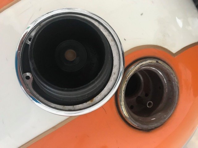

    Here is a photo of the tank fill and gas cap. I tested the airflow on both and found this.... On the tube vent pipe shown inside the tank, with a hose attached, no air flow when vacuum, air flow when pressured a bit. On the gas cap, no air flow when pressured on the threads pipe and some air rather a bit difficult when vacuum the thread pipe. I hope this is normal. We’ll see... image0 2.jpeg

    Here is a photo of the tank fill and gas cap. I tested the airflow on both and found this.... On the tube vent pipe shown inside the tank, with a hose attached, no air flow when vacuum, air flow when pressured a bit. On the gas cap, no air flow when pressured on the threads pipe and some air rather a bit difficult when vacuum the thread pipe. I hope this is normal. We’ll see... View attachment 113203
