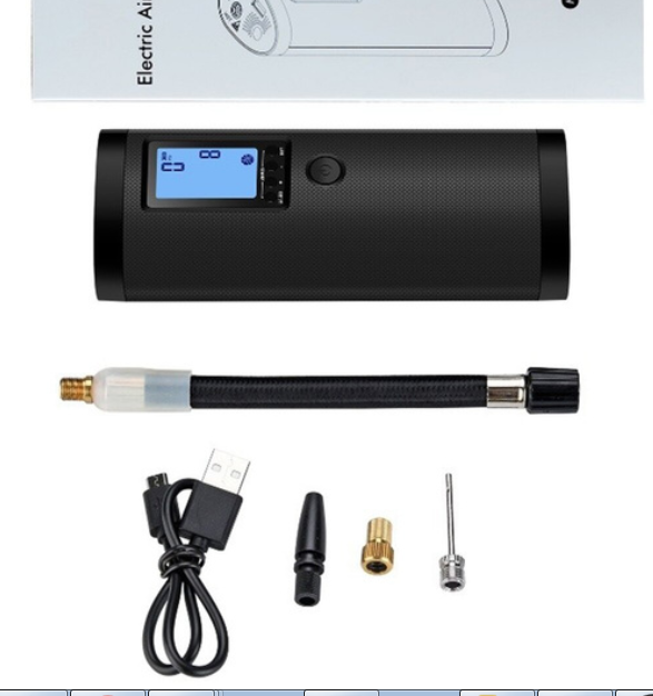

    I've seen these kind of very portable compressor. Could be a good invert (30 bucks) to travel.
  8. Ducatitotriumph
    Apr 25, 2019
    2,181
    Rothwell
    Now that looks a VERY good idea.
    Pumps motorbike tyres 6 times on one charge apparently.
    1031 reviews on amazon too so worth a go!?

    With my luck the battery would be flat when I needed it most!
    Ken.

    My battery operated compressor that is similar to @Hubaxe’s post #8 also comes with a 12v plug to power it from the bike/cars charge/lighter socket.
    Helpful should the internal battery ever be flat.
