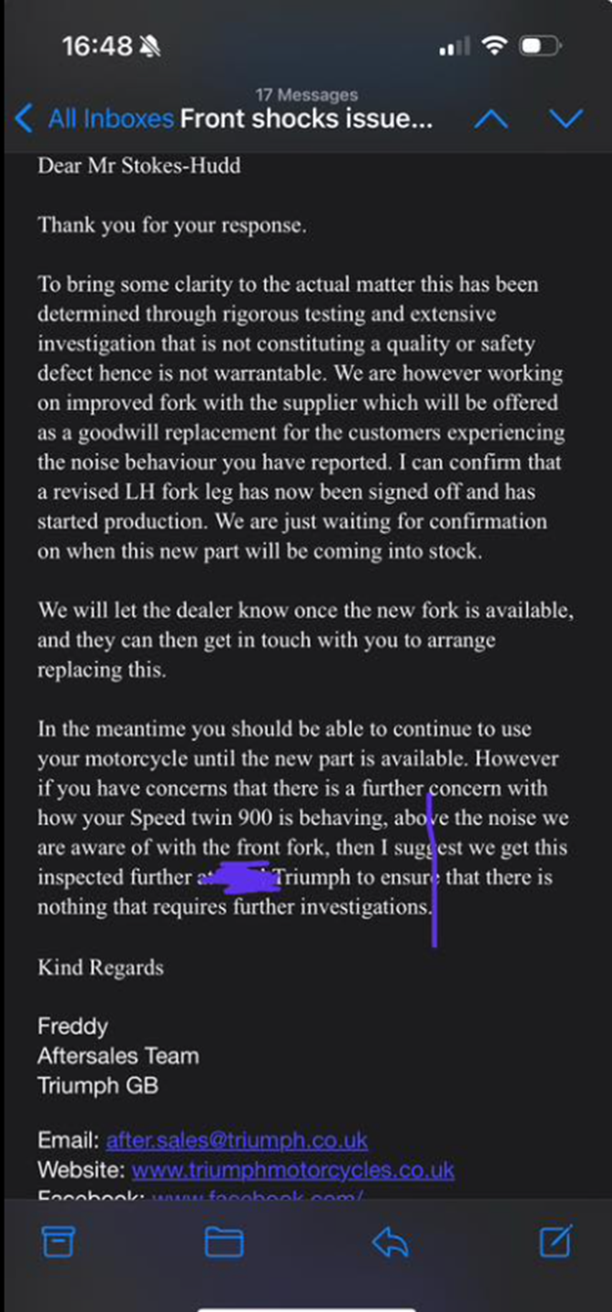

    Hey everybody,
    few weeks ago, I read about problems with the Marzocchi front fork of the new Triumph Speed Twin 900 (2025) for the first time in a YouTube comment. It sounds rattling or banging on uneven roads. At slow speeds, this can also be clearly heard and felt in the handlebars.
    I am now actually affected by this and it has increased within the first 1k km. I also reported this to the dealer at the 1k km inspection. However, he only said that it was the same with his demo bike and that's the way it is.
    But I'm not happy with that. I suspect that there is actually a problem with the product.
    I also discussed this in a German forum and there are actually other owners of this type of bike with the same problem.
    Today I have also written directly to Triumph by e-mail and am waiting to hear back.
    Now I would just like to know if there are any other owners here who are also experiencing this problem.
    kind regards
    Disto
