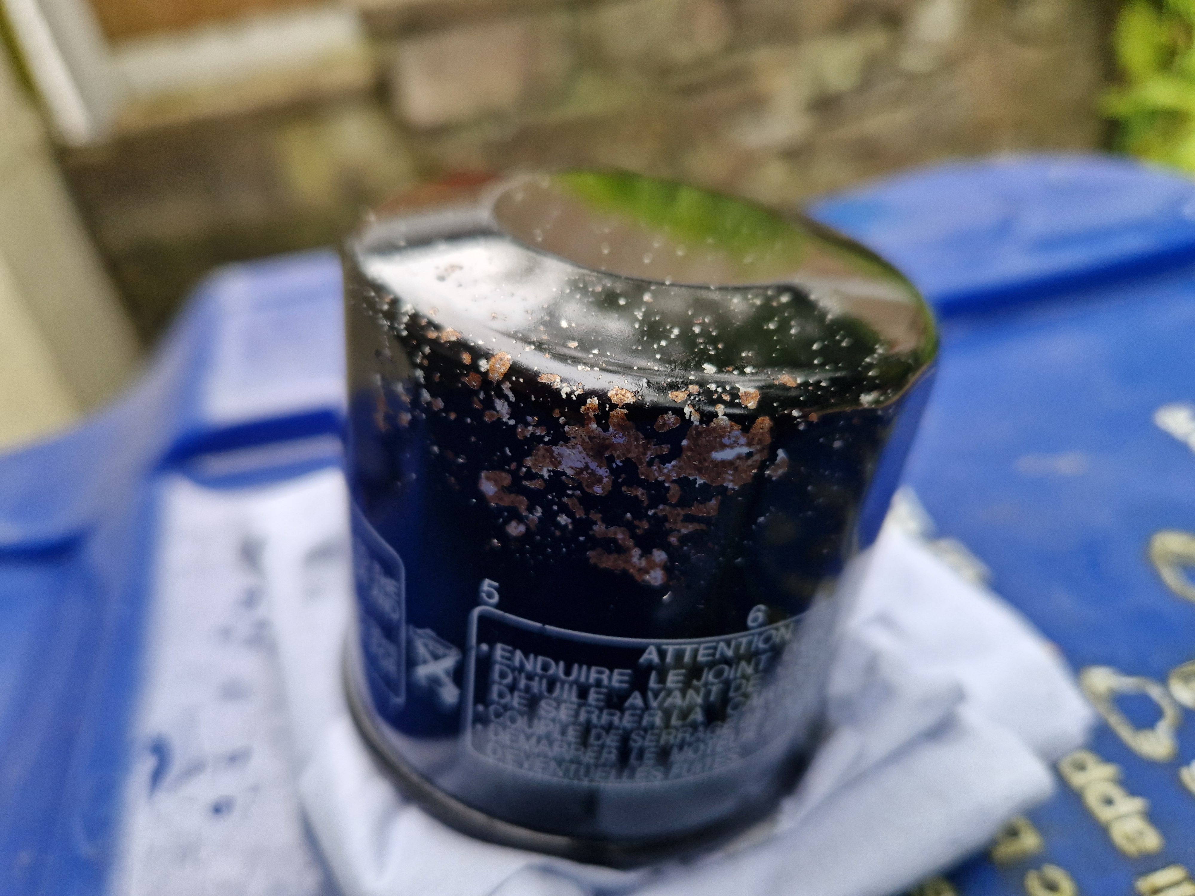

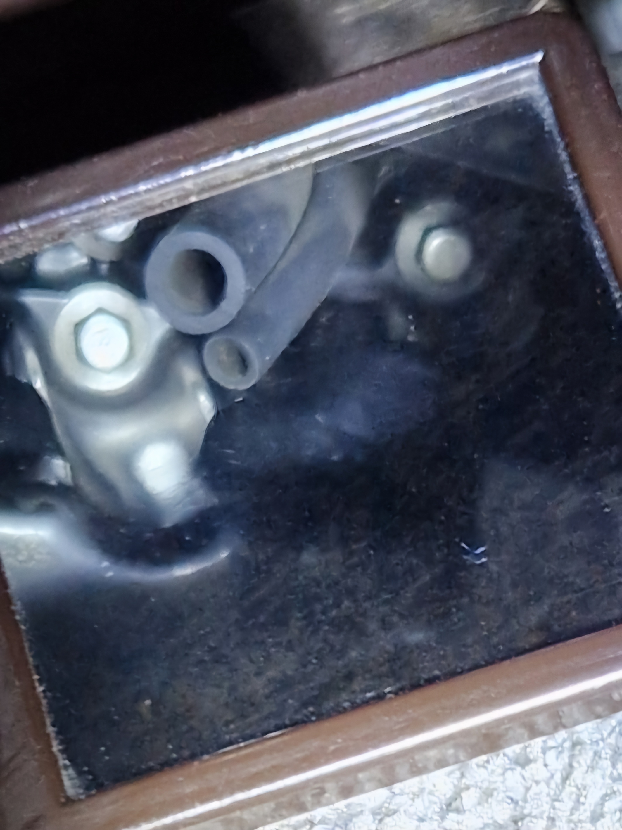

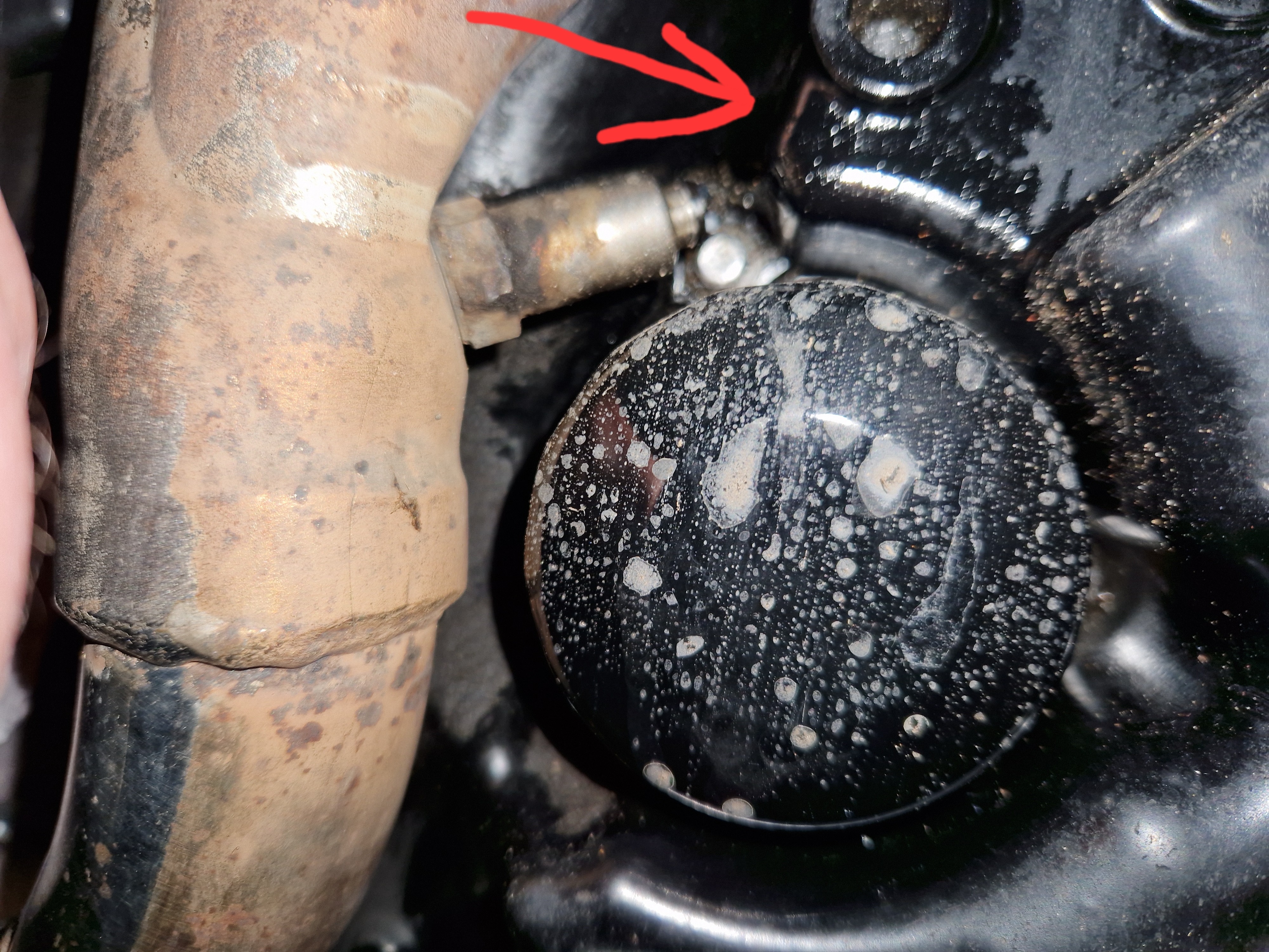

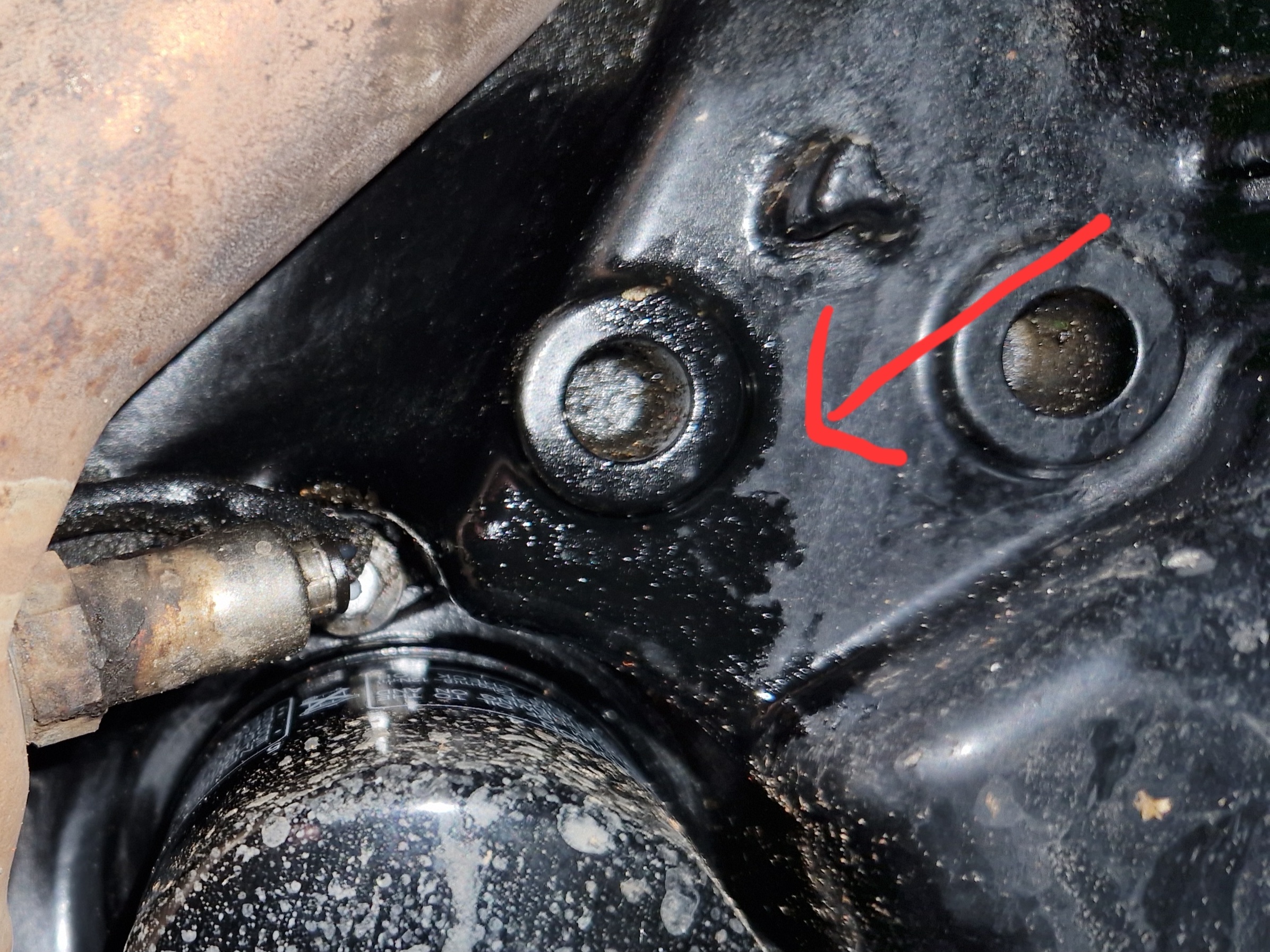

    Oil vapor for all th world seams to be coming from a hole bung in th sump. As anyone had a similar problem?? Also th near by breathers are dry, so it carn't be them? Oils filter, sump plug all oil tight. See fotoes.
    Note dry all around filter seal.
    Breathers oil free..
    Cheers Phil

    I would check for a blocked breather first and then give the area a thorough clean and then dust with talc powder to source the place where the oil is coming from.

    3, Iv cleaned it when filter is off, replaced with new and then ridden it 10 miles and there is no sign from were it comes from. A right mistery foreshore this one.. Its like some one as given it a misting of oil from underneath. Nothing is coming from above.

    3, Iv cleaned it every where when th filter was off, replaced with new and then ridden it 10 miles and there is no sign from were it comes from. A right mistery foreshore this one.. Its just like some one as given it a misting of oil from underneath. Nothing is coming from above. Oil level never drops. Like i say its not a leak more of a misting.

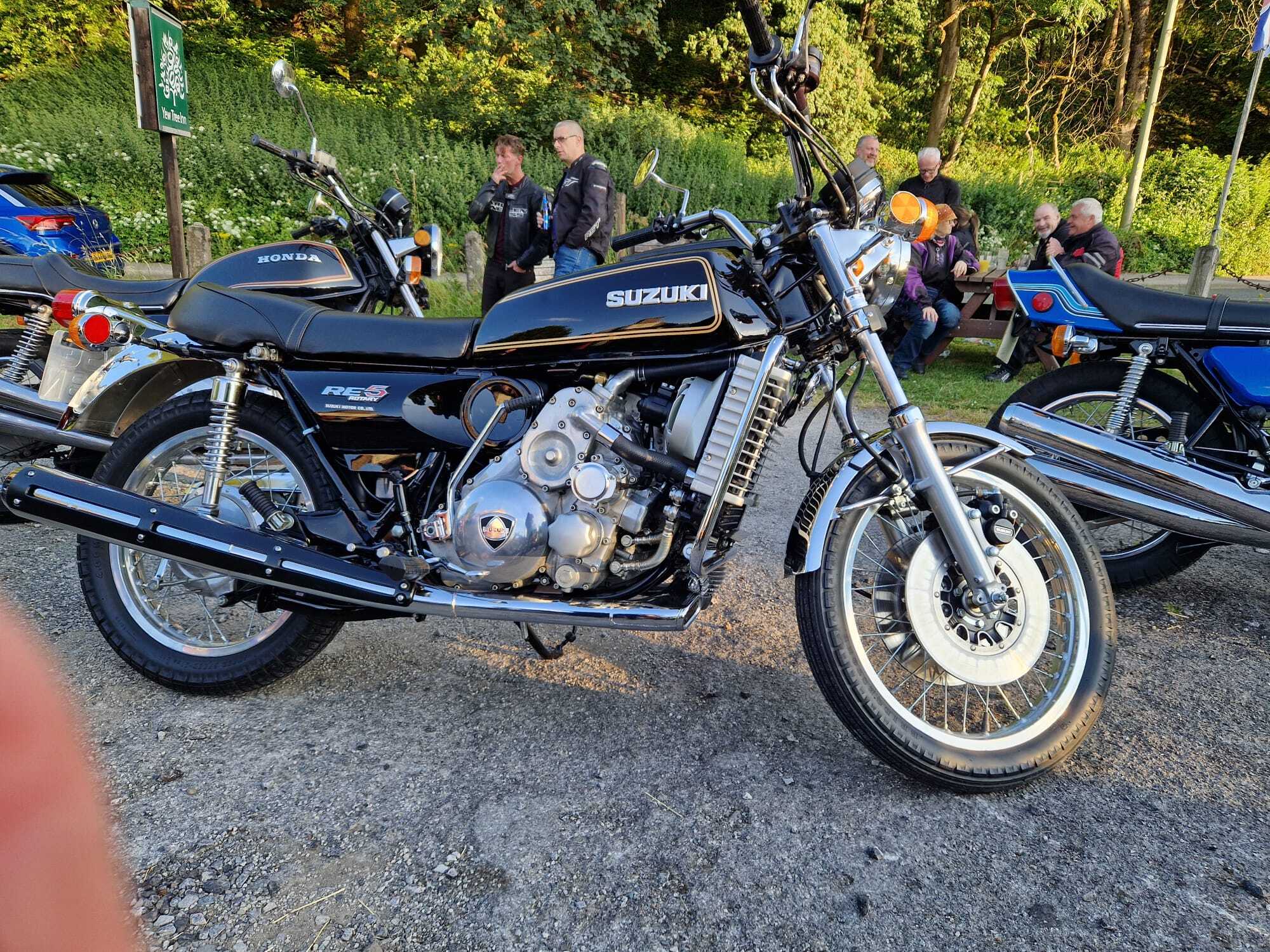

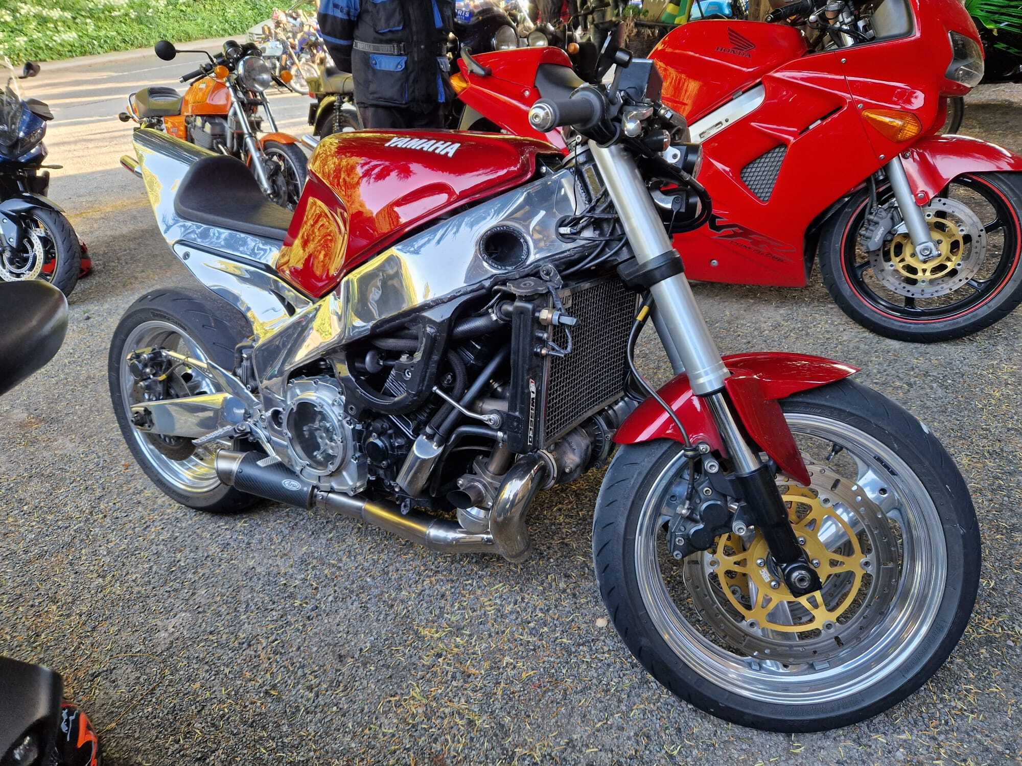

    On th ride out i saw these too.
    Nice 750. I wont one.
    Wankle...!!!!
    TURBO>!!!!!
    This is in th raffle... I hope we win it... ;-)

    That sump bung shouldn’t weep unless crankcase pressure is high. Inspect the breather system (even if hoses look clean) and confirm the PCV valve isn’t stuck. A blocked breather can push oil out of weak points. Also, check the bung’s sealing surface for damage.

    PPS. Th oil vaporing's saga still remains. Th sump might need a bit of Tig work. As any one done this to a sump??? Or should i go down th liquid metal route.... Mmmmm
