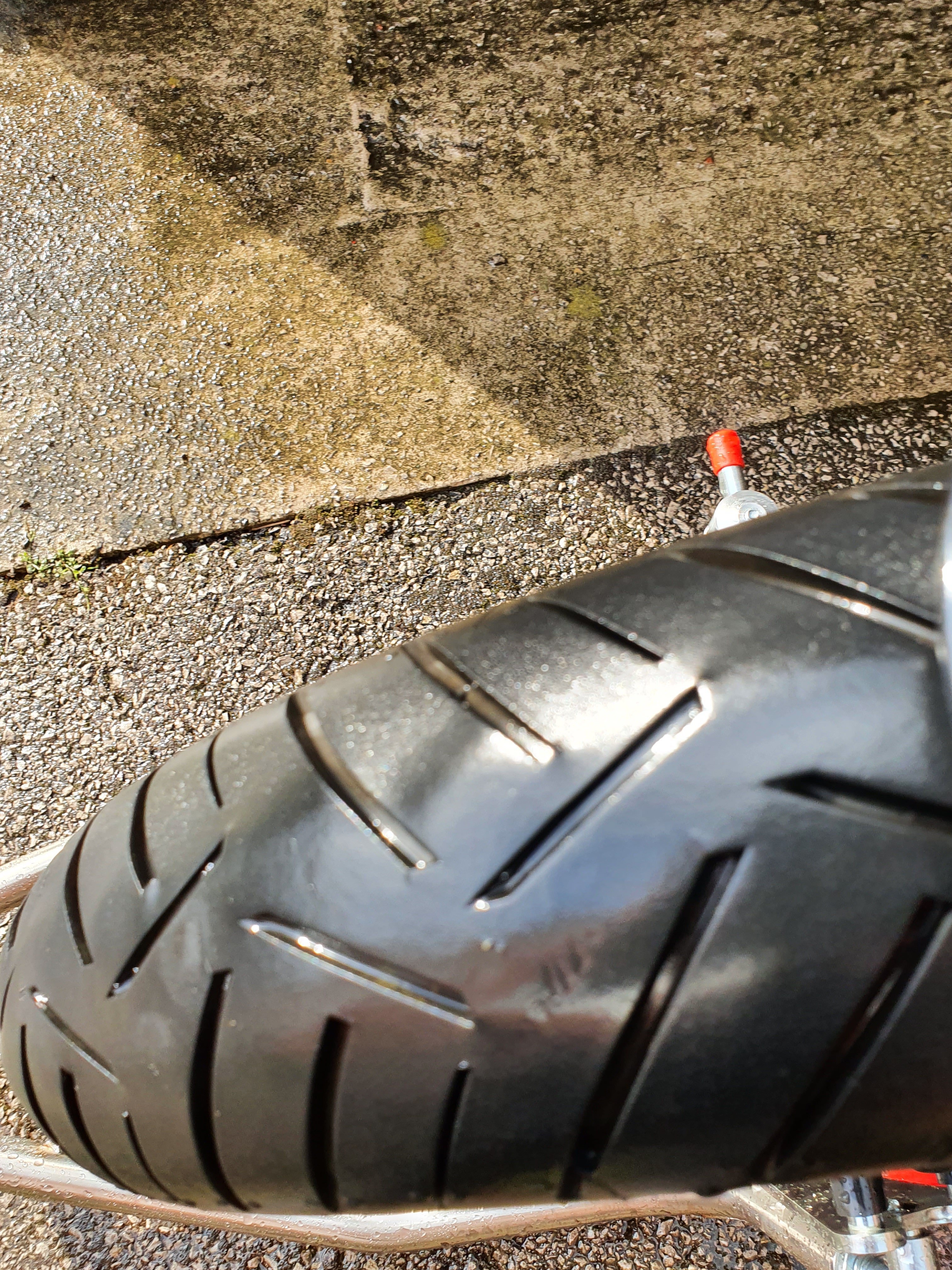

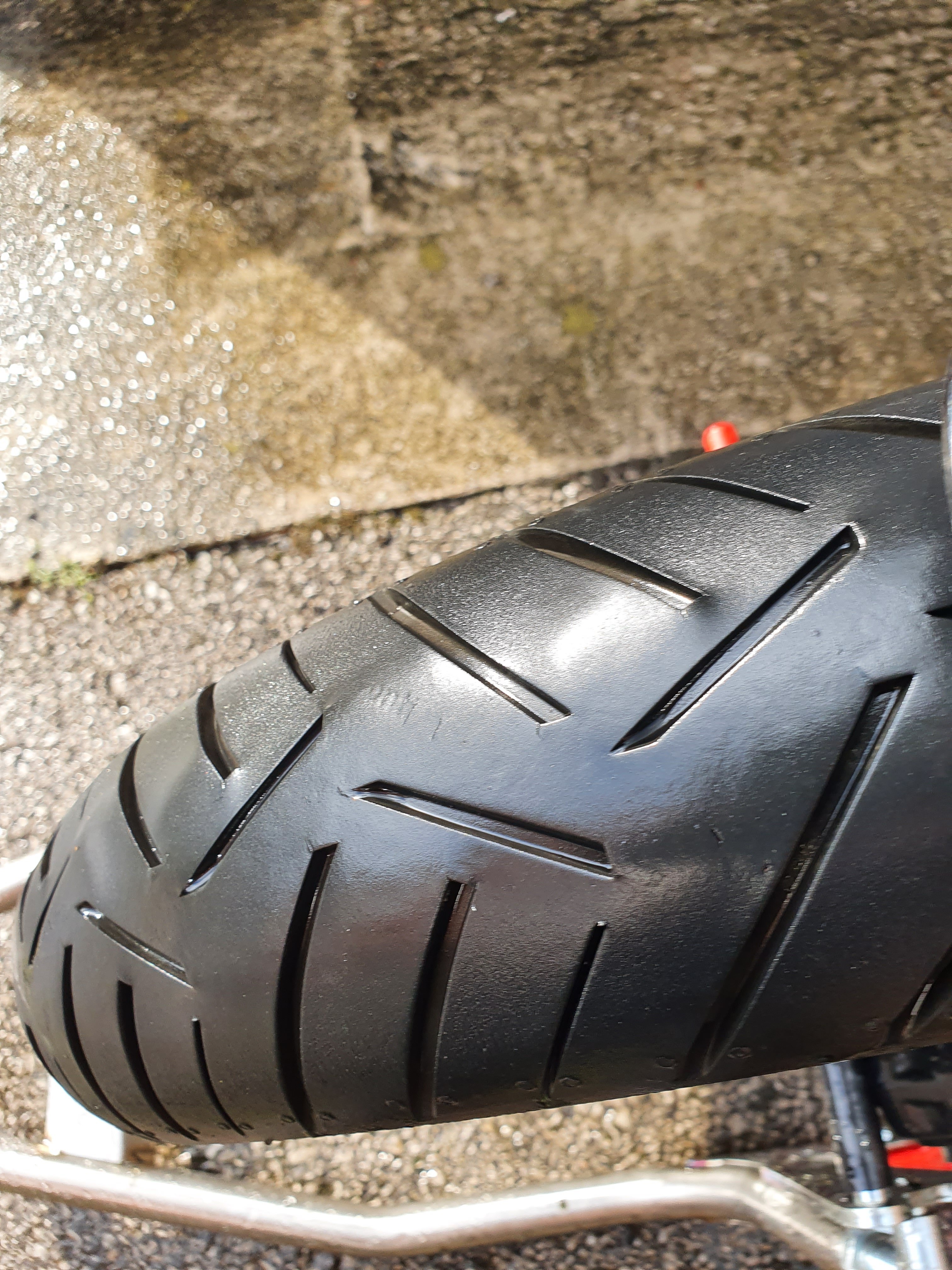

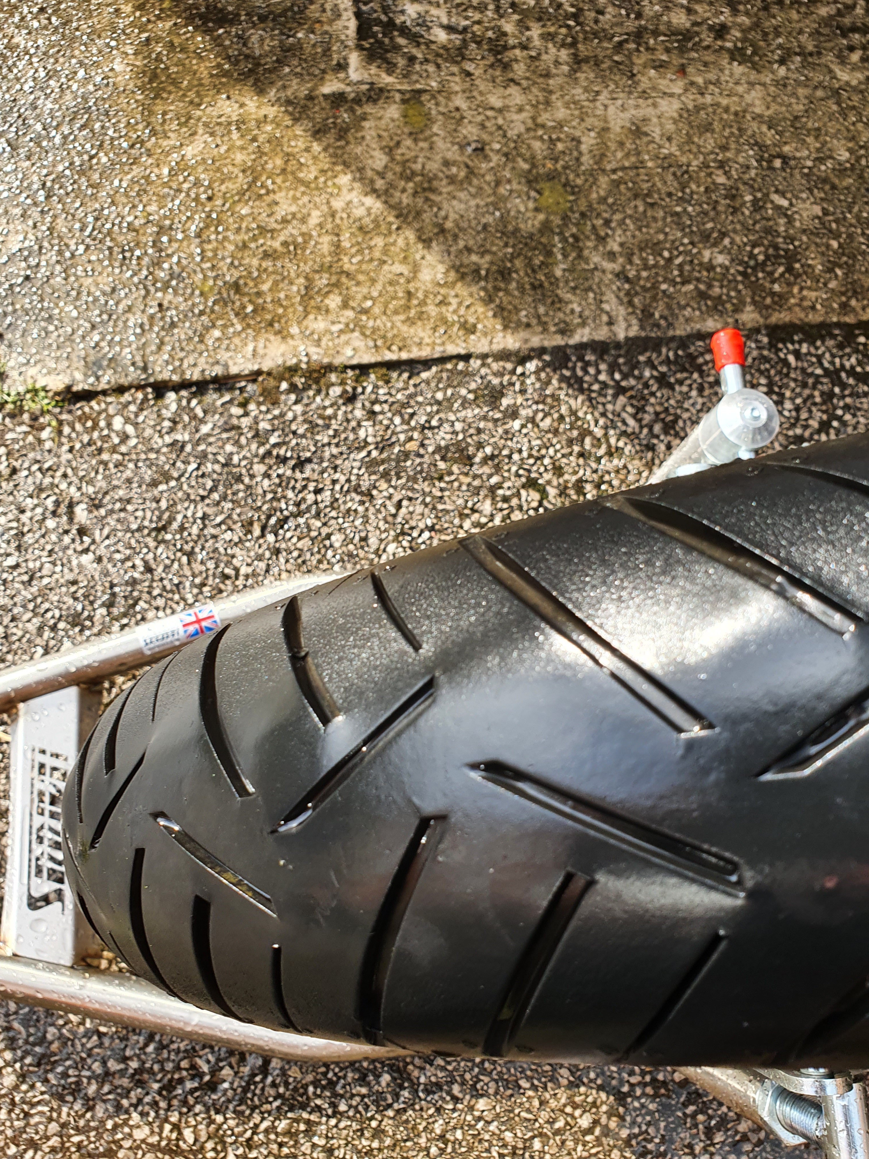

    Advice please I fitted Conti Road Attack 3 tyres to my Street twin 3K miles ago and have been very happy with them until recently when handling at the front became a bit worrying when pressing on. I checked all the usual suspects, axle etc and everything was OK. The front tyre shows hardly any wear, has not been repaired and there are no cuts or things embedded in it and it doesn't lose pressure ( I run it at 32 psi) when I washed the bike yesterday I noticed that the front tyre wasn't smooth, its lumpy and not consistent not obvious when dry but sunshine on it when wet and it shows. I have added pictures which I hope show the problem.
    Anyone come across this should I replace it and what is recommended?
    Thanks in advance.

    32psi might be a tad low, if you've lost confidence in the tyre then I'd say change it. Also, very often front end problems come from the rear.

    I think in America they call that cupping. I've had it with Road Attack Ils interestingly enough, and my Maxxis used to go like it towards the end of their life. Nothing to be done other than change it, l'm afraid. :confused:

    I've only just seen this and was going to reply to say that, from the images posted, it looked like cupping - Smilinjack was way ahead of the game - and spot on - with that one!
    The usual cause of cupping is inadequate damping so the tyre bounces or patters on the road. Out of balance and out of true wheels can also cause or contribute to the condition. If you haven't noticed any untoward side effects by now I'd say change it whenever you can but don't let it worry you until then. It would probably be worth making a quick visual check for the wheel running true.

    I had cupping on my Speed Triple, adjusting the rebound and compression cured it
    I had to experiment but if I recall correctly the rebound was too firm, once corrected it took a few more miles to smooth the tyre out

    Had the same starting on mine, and on the recommendation of a reliable shop increased the pressures to 40psi rear, 38psi front. Helped the overall handling and after another couple hundred miles the cupping has actually started to smooth out. Shop manager said that the manufacturer recommended pressures from the bike would rarely be what the tire actually needs, almost always resulting in odd tire wear or performance. His suggestion was spot on.

    Yes had the exact same on my Bonnie. Bulldog tested it and said there is nothing wrong with you bike but your obsession to go by the manual settings which are no help. They increased the pressure and boy the bike was like a track machine. I did a further 1000 miles on the tyres before changing to avons.
