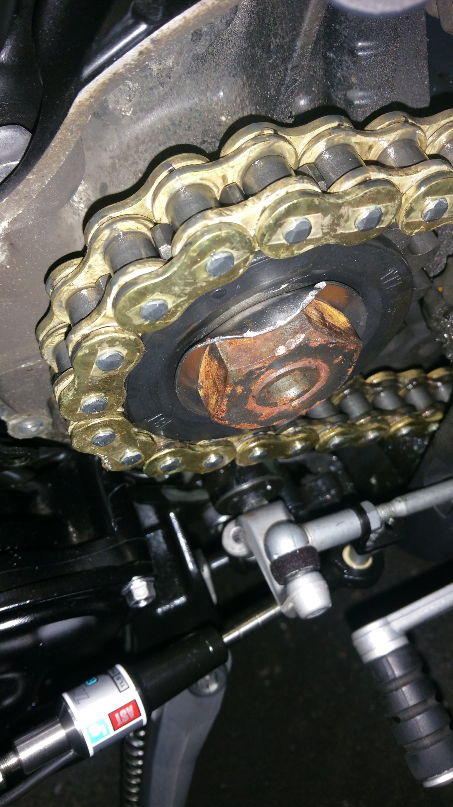

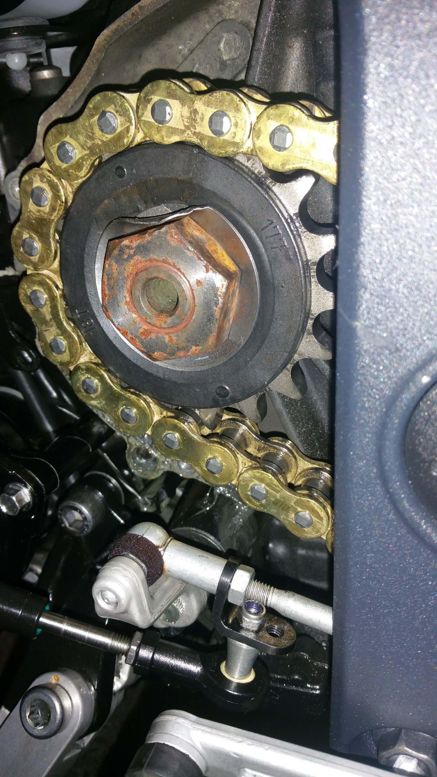

    I am surprised that the technician who fitted the sprocket did not make a neater job of bending the washer down to align with the flat on the nut, but that's probably me being anal, I do like things perfecto!
    More importantly in the bottom photo there is a 90 degree bracket holding an adjusting rod.
    This bracket has a Nyloc nut that does not have any male thread coming into the nylon portion.
    The bracket probably has a threaded hole (like the one at the side which has not been used) so I would imagine the bracket is held by a bolt or stud from the underside into that threaded hole and the Nyloc nut is there as a secondary safety locking nut.
    The problem is there is no male thread visible and certainly not into the nylon locking portion so that nut could vibrate loose and find its way into your moving chain and sprocket, or it could drop off altogether being that it is below the sprocket and chain.
    I would get that checked out with your Triumph dealer, it is not right and if the bike left the factory like that it shouldn't have.
    It may very well be an after market mod ?
    Basically it needs a longer bolt or stud that locks into the Nyloc nut!
    A bit of protective oil on the sprocket nut wouldn't go amiss either! lol
