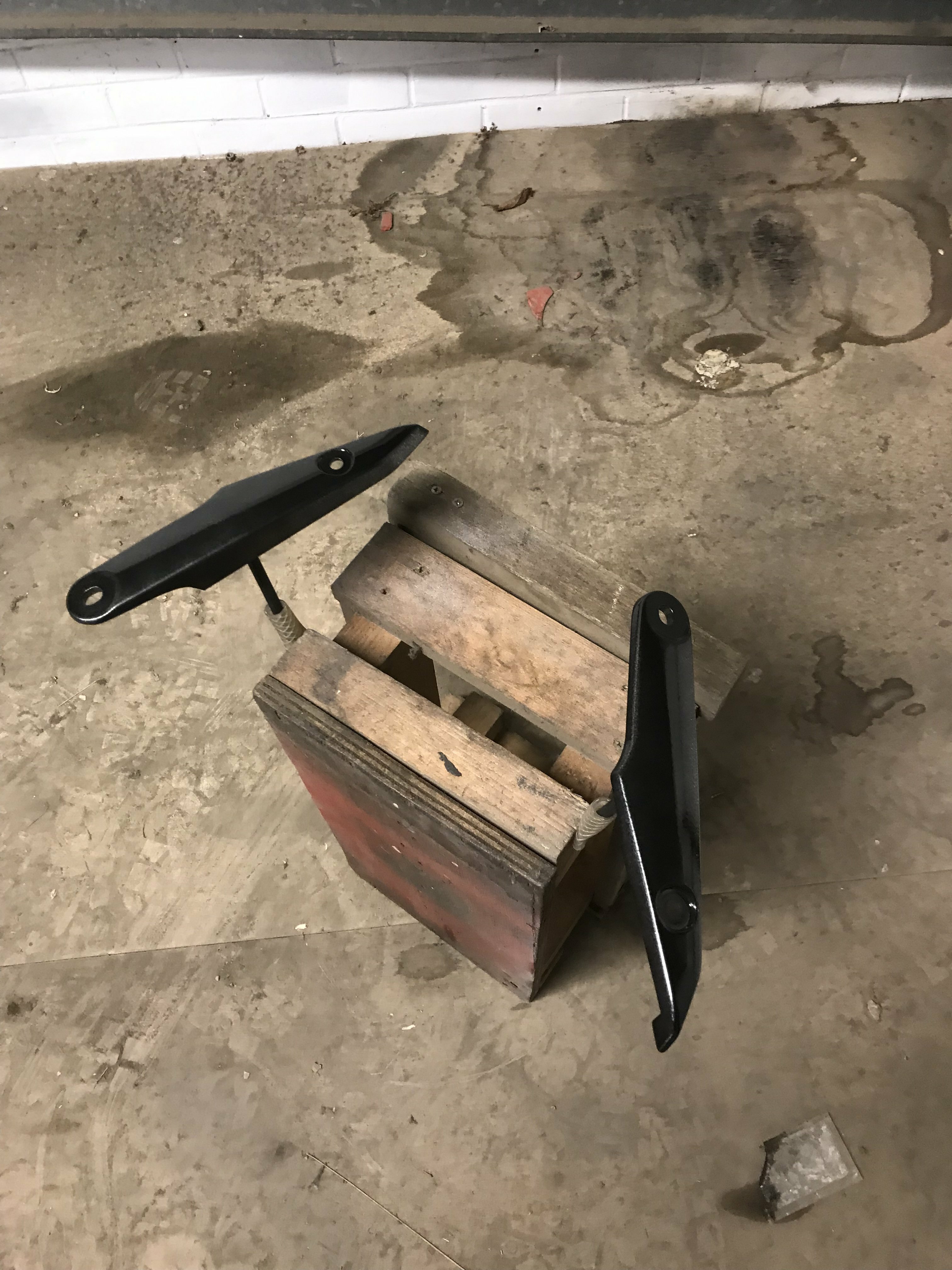

    Sent off for some plastidip :)
    Gonna have a go at doing these side rails :confused: 9542585C-DD88-405A-8719-E48FC280E982.jpeg temporarily glued some nuts on the inside to make handling easier :) F6EFCC8A-E00B-4A03-9281-98824322A15A.jpeg first coat on :) E1C153BE-4BEB-4B41-B73A-735183C8E4CB.jpeg time for a cuppa :yum

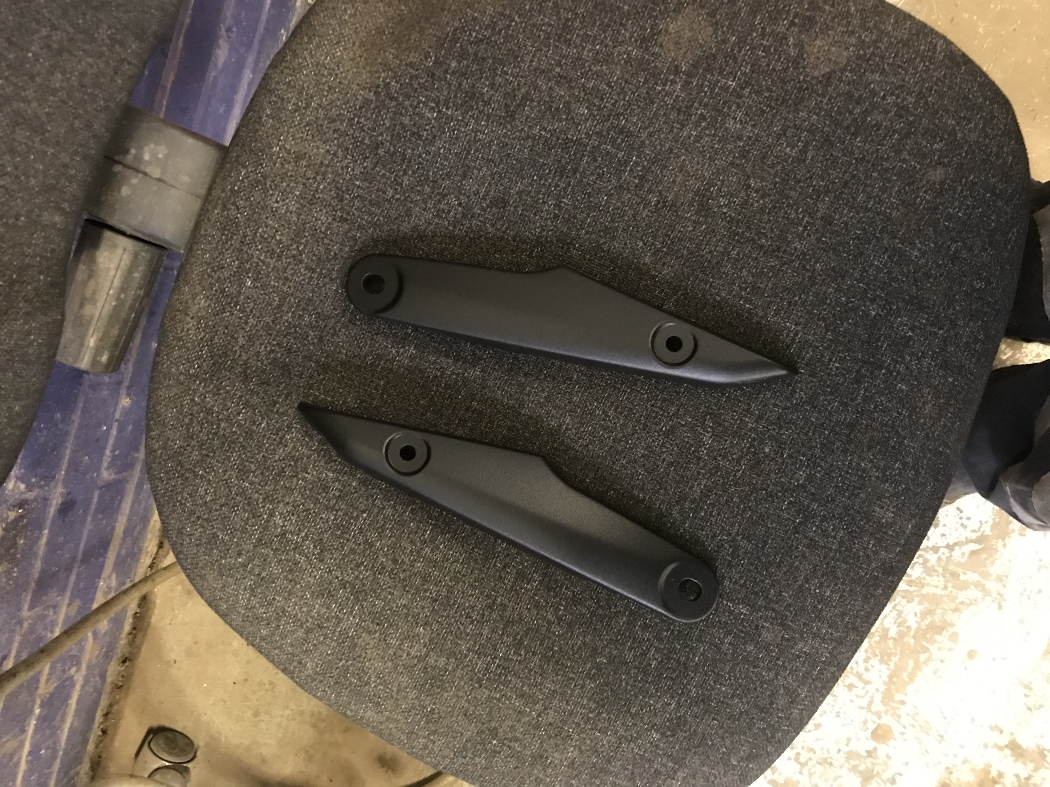

    Applied 4 coats altogether :)
    Gotta slightly textured look but I’m happy enough with the finish :)
    Can’t beat BLACK :cool: 27172001-4FC1-4487-9B1B-A22947922466.jpeg

    How about when you bolt it back on, what effect will the bolts or washers have on the finish as they revolve as you tighten ?
    Time will tell I suppose o_O

    Just got the can of plastidip and done it :confused:
    Should of done more research :(
  7. dilligaf
    Yeah I was thinking about that :confused:
    Find out tonight :p
    No harm done if it doesn’t work :)

  13. dilligaf
    They are already fitted to the bike :)
    I want to remove the chrome parts and rear seat from the back end of the bike when not needed giving it more of a Bobber look :cool:
    But when these bits are removed it looks like a mechano set underneath :(
    This way (hopefully) I get the look I’m after and can easily revert to standard when I need to :p

  18. dilligaf
    :) Well that’s them fitted :cool:
    Ooooh BLACK :cool:
    Ok it’s not the best picture but you get the idea :)
    I put washers on the two bolts on each side of the bike and this stopped the plastidip from twisting and separating from the chrome :)
    Take note though @Der Baron that when you tighten the rear of the two bolts because the rail is now missing it pulls the rear of the finisher hard against the mudguard:eek:
    Dunno if would do any damage :confused: but rather than take the chance I inserted washers where the rail would sit and this holds the tail end of the finisher away from the mudguard :) 4EA3078C-652D-4765-ADF7-8FC5EF939856.jpeg
