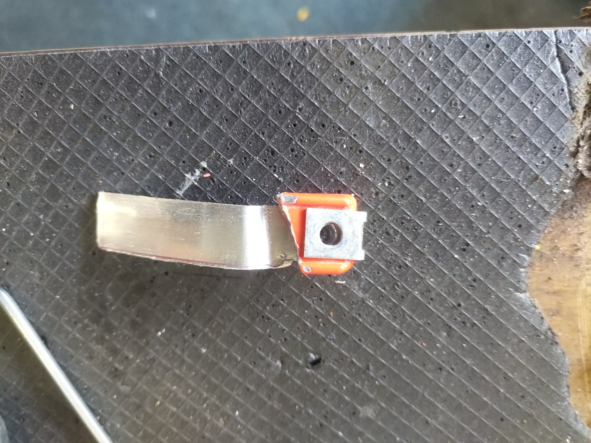

  5. MrOrange
    So went with the two part gorilla epoxy, I keep this in stock, as it will sit on the shelf opened for a year without going 'off'.
    Made a little strip of Ali to strength it and provide a greater area to grip. The spring clip held it nicely in place on the tab.
    Held in place with a bit of tape whilst it sets.
