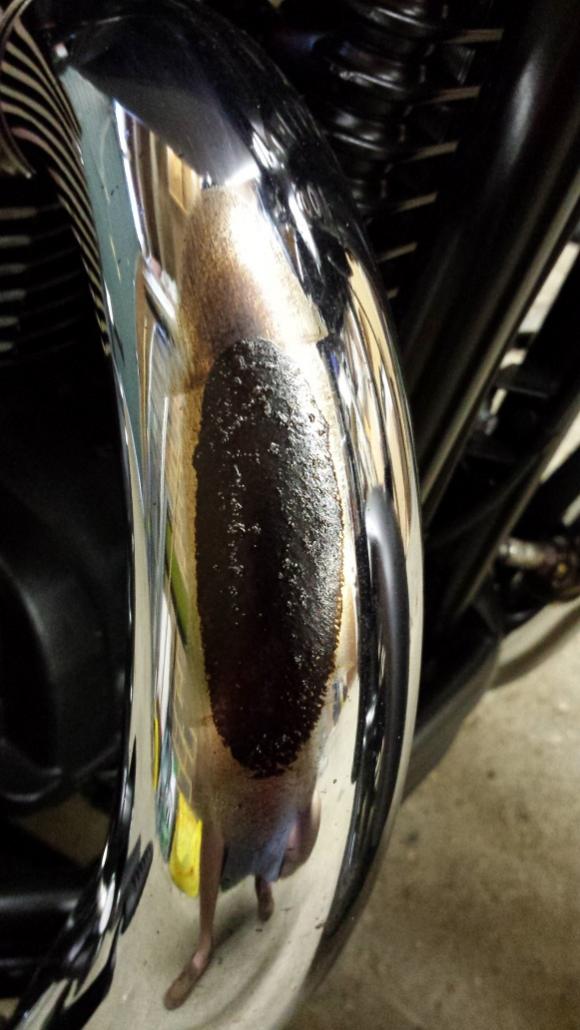

    Ok, took the Bonnie out for a wee spin this afternoon, after an hour starts raining so I head home and park the bike outside the house, I loosely cover the top of it with my Oxford bike cover so stop it getting wetter till the shower is over, unknown to me the outside plastic side of the cover is touching the exhaust, the result is it has melted onto the exhaust :frown: (pic below) .... any idea what I should use to remove the melted plastic from my exhaust? Any help/advice much appreciated...

    If it was mine then I'd use a hot air gun to re melt the plastic, possibly wipe it with a partly oil soaked rag (cotton) till it's removed then Finish off with traditional ammonia base T cut.

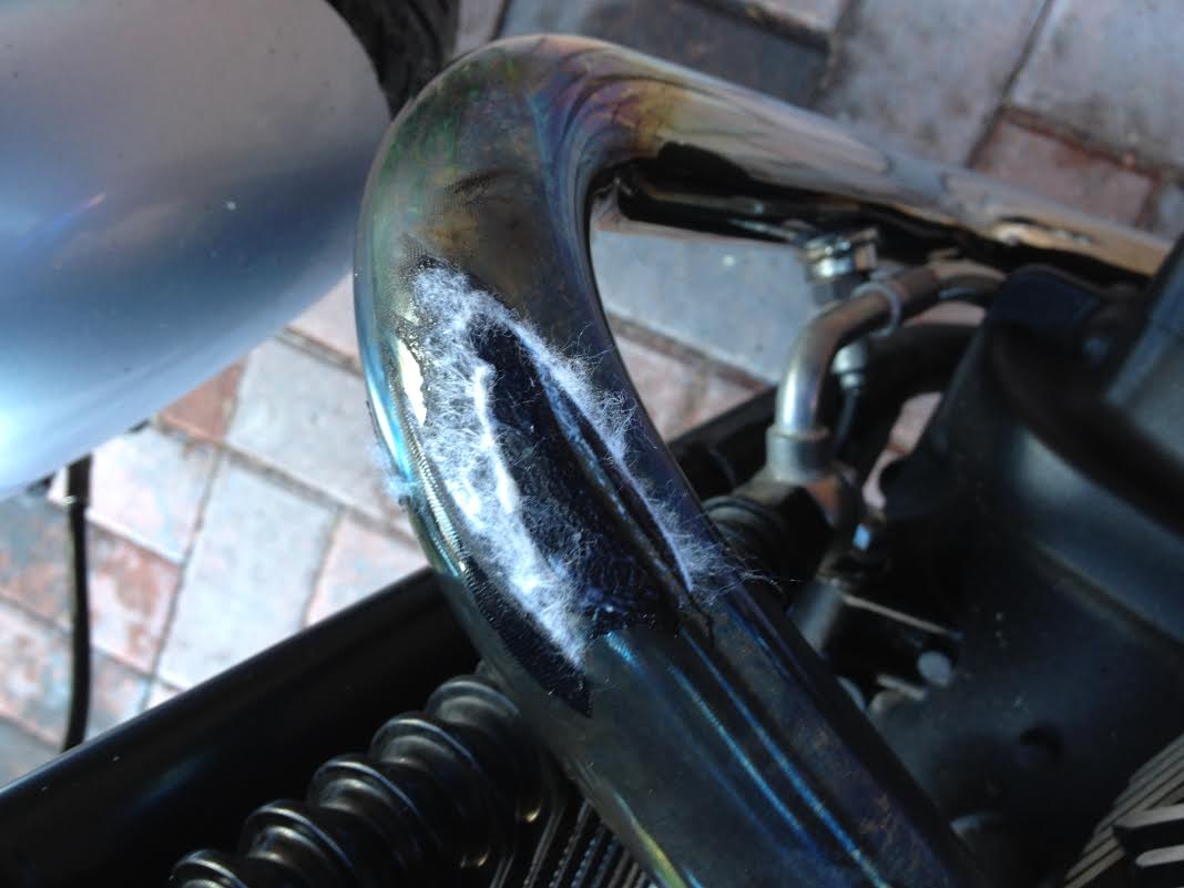

    I had a similar experience yesterday.. but mine was caused by cat jumping into garage, landing on exercise ball and exercise ball falling onto hot exhaust! Will try your suggestions Tigcraft but any more ideas will be gratefully received too :)

    Cleaned it off today, took around an hour... after googling "plastic melted onto exhaust" lots of people have had similar problems... cleaned mine by soaking the plastic with Acetone soaked in a cloth (don't get it on the paintwork) for a minute or so, and then scraping away at it with a plastic tool for cleaning ovens, and a Stanley blade (very carefully and gently) also sprayed some WD40 and repeated till it came off, basically small bits just break away till it's gone completely :smile: Good luck unionfan!

    Thanks for the great advice folks... used the hot air gun and oily rag option plus some elbow grease and this is the result! Very happy again.
