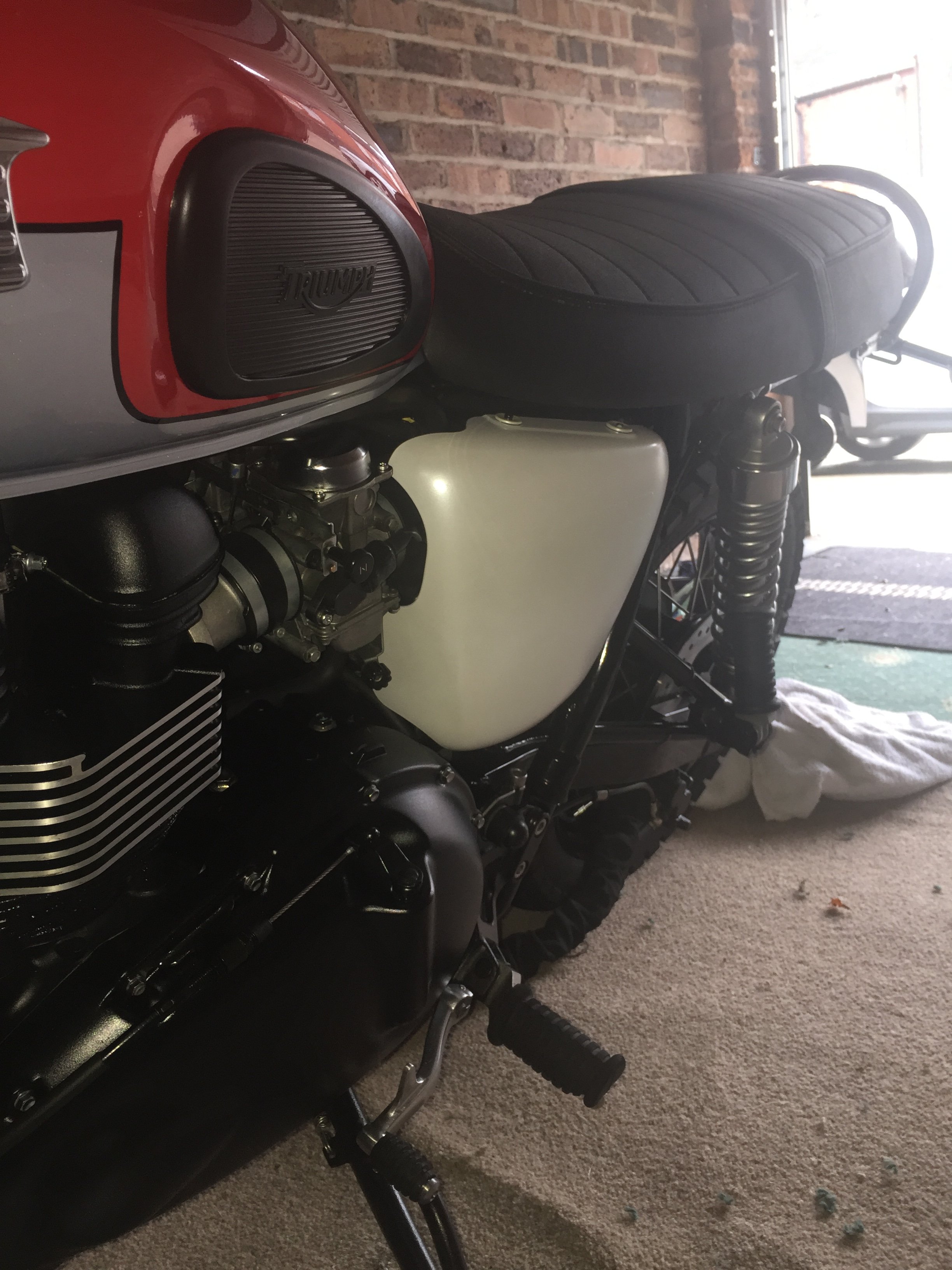

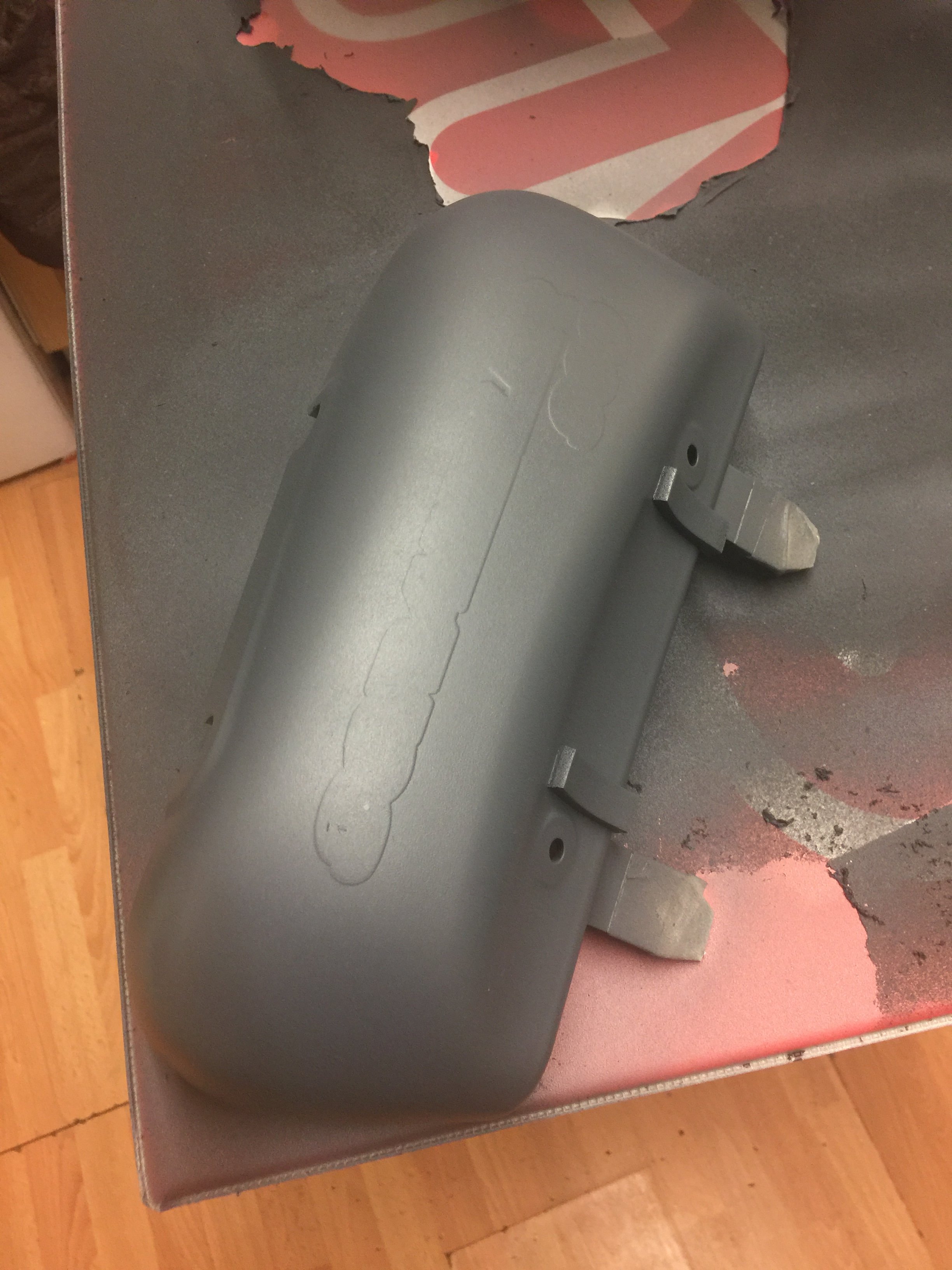

Thanks guys, got the first batch cleaned and prepped. Tank, rear guard, rear indicators and chain guard after this lot. Black on the indicators, heat shield and headlight grill Pearl white fleck on all the tank, mudguards and panels.
Tez So far the May black looks excellent and easy to paint, no issue quick coverage and dries lovely , the pearl white? Er not 100% convinced I've done a good job so far , small hairs and bobbles here and there. Can't sand it back and can't wipe solvents over each coat so the jury is out. Still a bit of fun and I'll persevere. I'm adding some new and differnt stickers to make it po. Tank front and back guard to do. Here is some pics

Hello Tez the black- 3 straight coats The pearl is 3 grey, 3 white, 2 pearl and after stickers -2 clear. Sounds a lot but it covers really quick so you don't use much - so far I have only used 2 tins
Hello Kev So far one coat or glossifier doesn't appear to make any difference, now I have the stickers on I'll give it another coat or two
Well adding the last coat or glossifier hasn't made much difference to the appearance, but did attract every bit of fluff within my postcode area to stick to it. I've fitted some of the bits back on to get a feel for the look. Question is as I'm changing the shock for black ones- do I paint the guard before the sticker or just add the sticker
