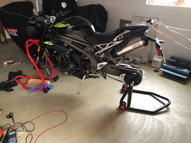

    It seems I'm all prepped now to remove the front wheel in the morning . . . must wade through my S3RS workshop manual first to make sure I'm happy with the process.
    My BikeTek Headstand arrived from The Sportsbikeshop earlier today, I say BikeTek, in reality, it's a rebranded generic jobbie from the land of bat soup and pangolin souffle. I can't complain at the price but . . . . .
    I've never used one before and was debating a front paddock stand (triple tree variety), an additional Bursig adapter plate for my Bursig stand or the SW-Motech centre stand.
    I ordered the centre stand a week or so ago but then canceled after studying the mounting instructions. . . . .
    a. I'm not totally comfortable with using engine and suspension mounting points to attach the thing and
    b. The stand mounting is only totally supported on one side although I'm sure the design is more than adequate but most important of all
    c. I already have an R&G paddock stand which is very easy to use on a SSSA and the centre stand will also prohibit removing the swingarm. OK, this isn't a job I'm likely to do very often, if ever but . . . .I want to be able to do so without having to first remove the centre stand and having done that, find I'm then jiggered for supporting the bike.
    So . . the head stand won the day but I also plan on buying an additional adapter plate for the Bursig so that I can raise the bike and work on it without restriction if ever needed. The headstand will come in useful as an expedient method of raising the front to clean the wheel and/or remove it occasionally and hey ho . . .it was only circa £60 and substantially less than the centre stand plus . . . I can use it on the other bikes - maybe??
    Like all non-OEM kit, pattern stuff never seems to be without issues and the phrase Caveat Emptor is never more appropriate. With this in mind, I watched a number of Youtube videos and soon realised the head stand or triple tree stand is another means by which we can mash our bikes quite nicely if we're not careful.
    The stand comes with a number of pegs for the headstock but suffice it to say, 15mm was a little too loose for my liking and the 16.5mm option wouldn't go. Initially, I was a little concerned that raising the front of the bike, effectively on the end of a 14-inch lever would apply a significant torque or bending force to the hole in the bottom of the yoke and so at the very least, I would prefer to use a peg which is a smooth, sliding fit - no worries, when time permits, I will stick the 16.5mm peg on the lathe and turn it down accordingly.
    That said, I carried out a test fit of the upper portion of the stand prior to assembly and it's clear from the photo the hinged lifting point at it's base, is more or less directly underneath the headstock pin. Thus, when raised on the stand, the only force the pin will be exerting on the headstock is an upward lifting force - there will be no moment exerted and so the pin being slightly undersize is less likely to cause damage that perhaps I first thought - I will still rework the 16.5mm pin however!!
    I have watched enough videos to realise a test fit was advisable - so many folks demonstrate these stands, only to then realise they have crushed their horn, damaged their brake lines, scratched their front mudguards or worse still, pulled their bike off the rear paddock stand . . . .
    Thankfully, the peg located into the yoke without issue and with no interference other than a very marginal degree of clearance with the front mudguard. Clearly this is going to risk getting scratched or damaged if the steering is inadvertently turned whilst on the stand and so an initial prep will be to lay several folds of blanket or foam sponge over the fender and down the sides to protect against such an eventuality.
    The only other issue of note is the fact that when raising the bike, there will be a tendency to pull the thing off its rear paddock stand and with potentially catastrophic results. . . .
    Pressing down on the handle causes the hinged lifting point to rise but also, for it to be pulled forwards. To offset this, the wheels should ordinarily roll backwards but notwithstanding, the action of raising the bike will inevitably pull it forwards as well.
    The issue I have is the R&G paddock stand, whilst quite strong and well made is a poor design insofar as the over-centre lock is minimal and even a gentle nudge forward, will bring the bike off the stand and crashing down.
    The solution to this will be simple enough - when raising the bike using the headstand, apply downwards pressure on the handle of the stand, whilst simultaneously pushing the top of the stand rearward to counteract the tendency for the bike to come forward. This should allow the thing to come up without pulling the bike off its rear paddock stand.

    I did say that I wouldn't bother writing up the front wheel but I've discovered one or two useful snippets which will help conclude this particular episode, that is . . . . until I get the system activated in April when I start riding.
    I repeated the previous exercise on the front wheel today and being only a 120, it went very smoothly.
    First job was to test out the BikeTek stand and being very distrustful, I decided to tie the back of the bike to the garage door just in case . . . somewhat perversely, once it was up on the stand the whole thing had moved backwards slightly and the straps had gone slack - go figure!!
    I broke both beads on my first go and had the sensor installed in half an hour.

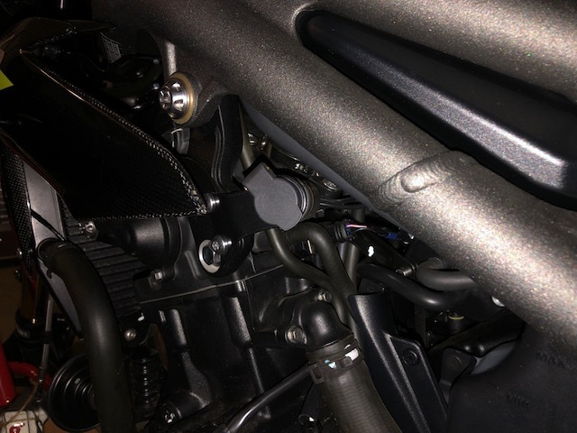

    As I like to use an optimate over winter, I have been looking at the various options for connecting it. The S1k simply has a fused lead which I connected to the battery and the connector is stowed under the rear seat hump - it's simple enough to pull it out and leave it dangling when the bike isn't in use. Originally, I did the same with the Tiger 1050 until I realised that it was wired for a DIN socket and once connected, this gave me a permanent "live" on the side of the bike and a highly convenient charging point . . .
    I decided I would go the same route on the S3RS. Strangely, the accessory socket ( A9938037 for the Tiger) is listed for most Speed Triples but not the RS. It seems that Triumph have deleted the wiring from the loom.
    I took a look at various folks' solutions - most of which involved connecting an accumate lead to the battery and then a cocktail of creative stowage solutions. I didn't much like any of them and so purchased some 12 gauge silicon wire from eBay- a length of black and a length of red, a suitable in-line fuse and having purchased the accessory socket, simply wired the thing straight to the battery. I ran the leads down the side and under the tank, cable tied as necessary and the final installation is neat and uber convenient . . another job done.
