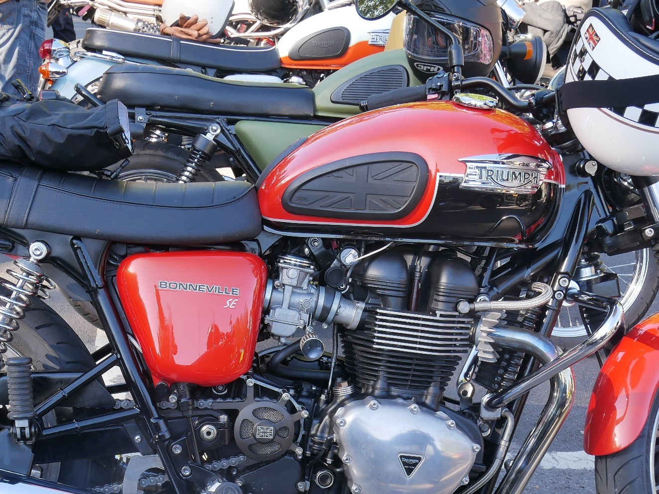

  4. steve lovatt
    9,211
    Agree with Ron, don't remove the tank, just undo the two rear bolts and pull back and lift it up slightly. Put a suitable piece of wood underneath at the bolt end and feed your USB cable through, that's how I did mine.
    If you look carefully you can just see where the white cable emerges to the left of the steering lock and in line with the top of the Triumph badge when not in use.
