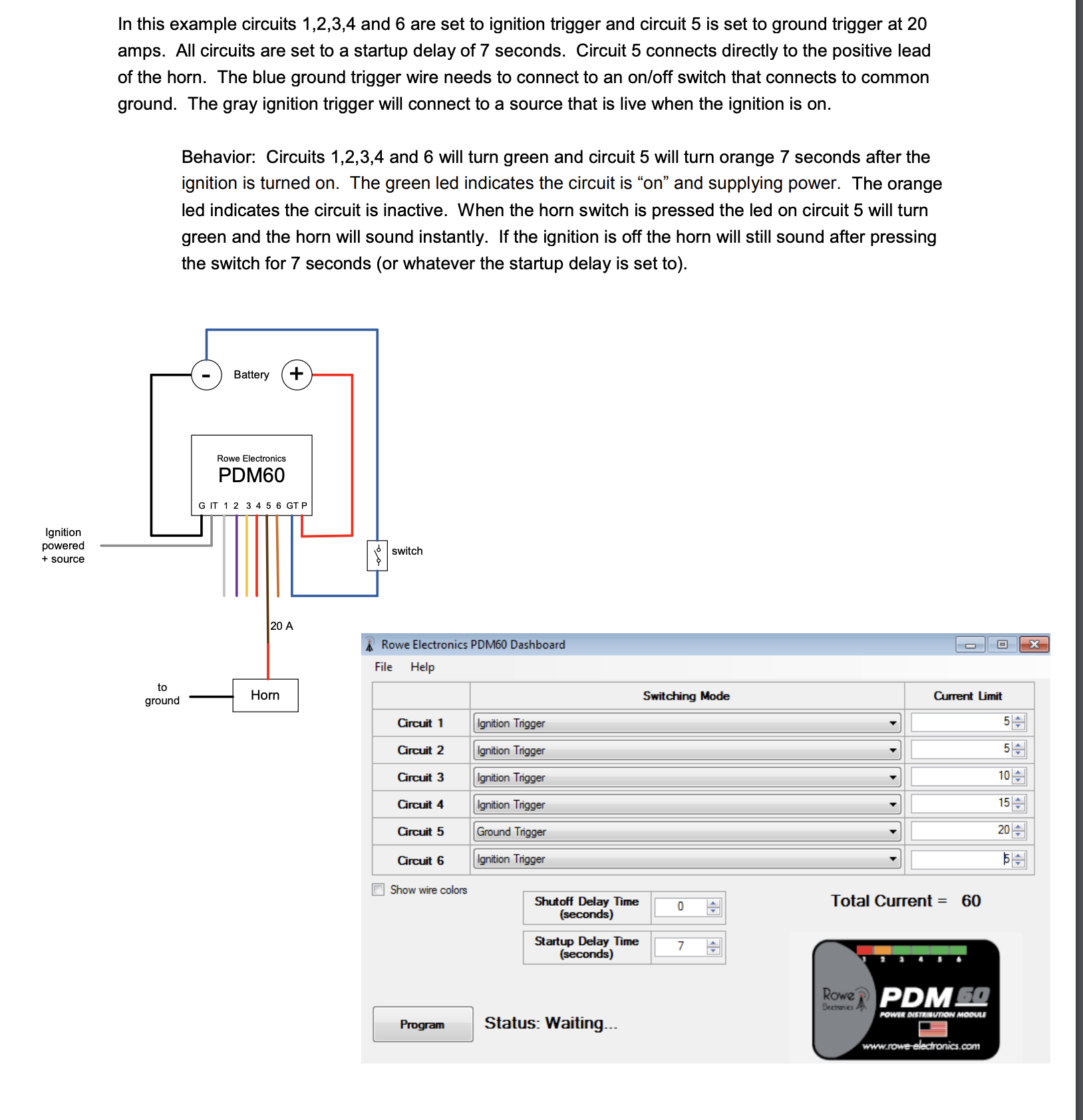

    The PDM60 has a Ground Trigger input and you can assign any of the outputs to be 'triggered' by the ground trigger. So if I'm thinking about this correctly, theoretically I can connect the horn switch wire to the Ground Trigger in on the PDM60 and the assigned output to the horn.
    But that's as far as I can get.

    The PDM60 has a couple variations of this connection, with the 'other' connector of the switch to ground and the 'other' connector of the horn also to ground, as per the attached file. Here is the full PDM60 manual with various connection possibilities:
    http://pdm60.com/wp-content/uploads/2016/07/PDM60InstallationExamples.pdf

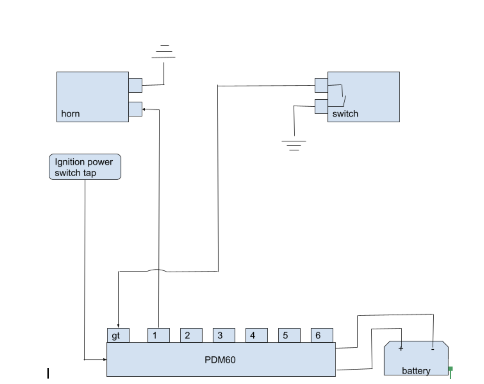

  2. Espanolito
    Espanolito New Member
    Apr 20, 2019
    Toronto
    I think it's as simple as this:
