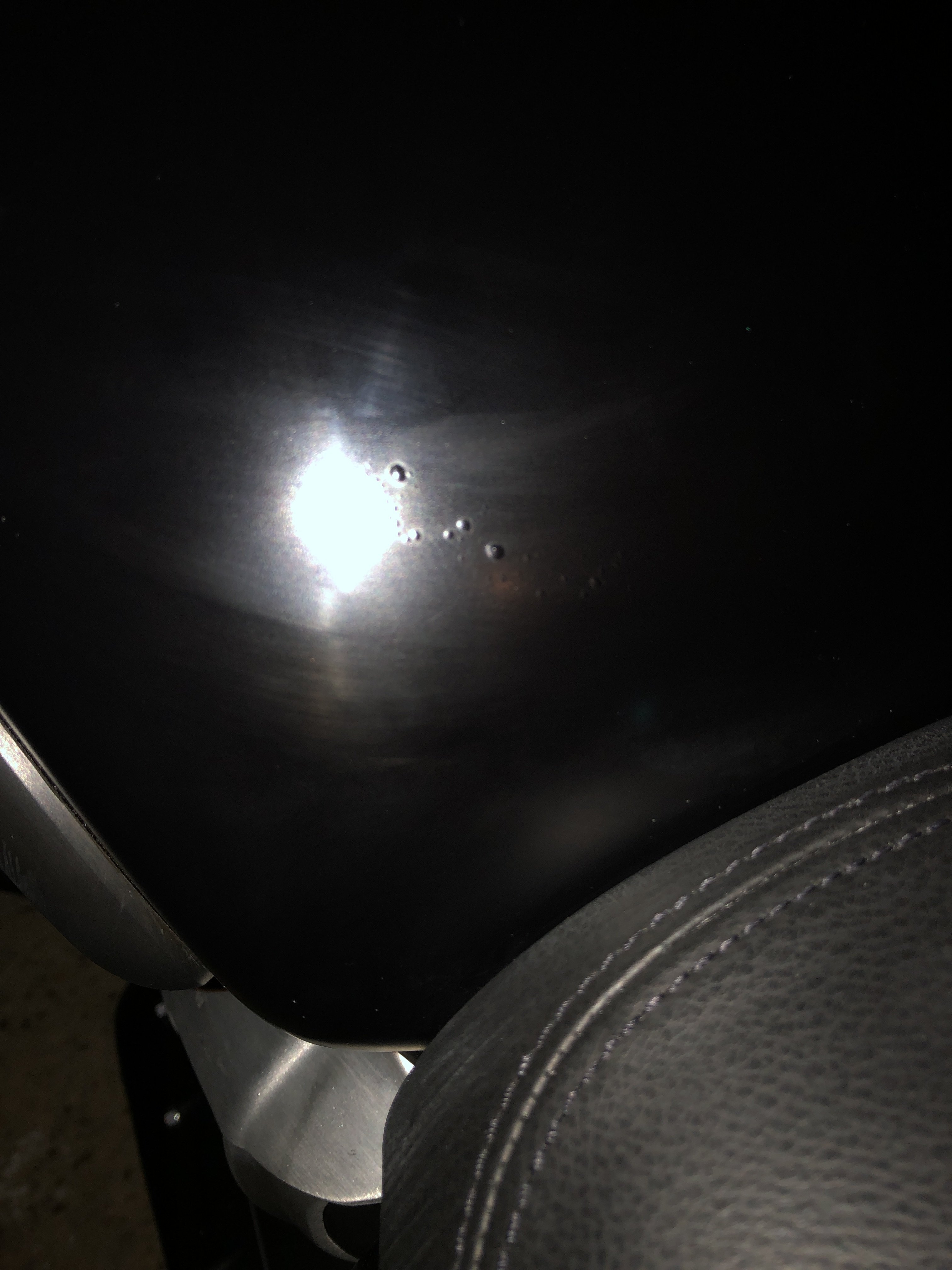

    cleaning it today and have noticed that in several places there are blisters / bubbles under the paint. The worst area is near the seat.

    Surely fuel tank paint should resist fuel spills?
    These look like blisters when you get water trapped under paint also - because it’s Matt and a pain to keep clean - it’s had a tank cover on almost from new so I don’t think a fuel spill would get down near the seat. The others, less obvious are just above the knee rubbers.

    Well by the picture it looks like rust to me under the paint. If the bubble/bumps are hard I bet the tank has rust under the paint. If the the bumps are soft, paint is coming up. The picture on my computer looks like it has a hint of rust color in the paint, may all be lighting and camera or my crappy computer. Let us know what they say.

    I should clarify that this was under a Triumph tank pad fitted from new. It had started to lift so I removed it intending to replace it with new adhesive pads. It peeled off very easily and found the blisters. It can’t conceivably be petrol, it’s been sealed.
    Dealers have photographed it and will be recommending a replacement. Fingers crossed!

    This will be covered under warranty, I cannot see how this could be caused by fuel as by your picture it looks like it's down the ns which is on the oppersite side of the filler. You would have to be spraying it all around the forecourt to cover it in that point.
    Also just because it is a matt finish which I would never buy just means that it would have a matt lacquer on the paint which it would have to have as all auto manufactory's these days have to use water based paints.
    Hope this helps
    If they don't cover it go public, but I have found Triumph paint warranty really good.

    Hi - Just an update on this. I took it to my supplying dealer on Saturday (Dave Deaths, Isle of Wight) and they processed a warranty claim. Got a call today (Tuesday) to tell me that the tank is already in. Booked in from Saturday with a courtesy bike if I need it!
    Very impressed with the dealers and Triumph. Great service.
