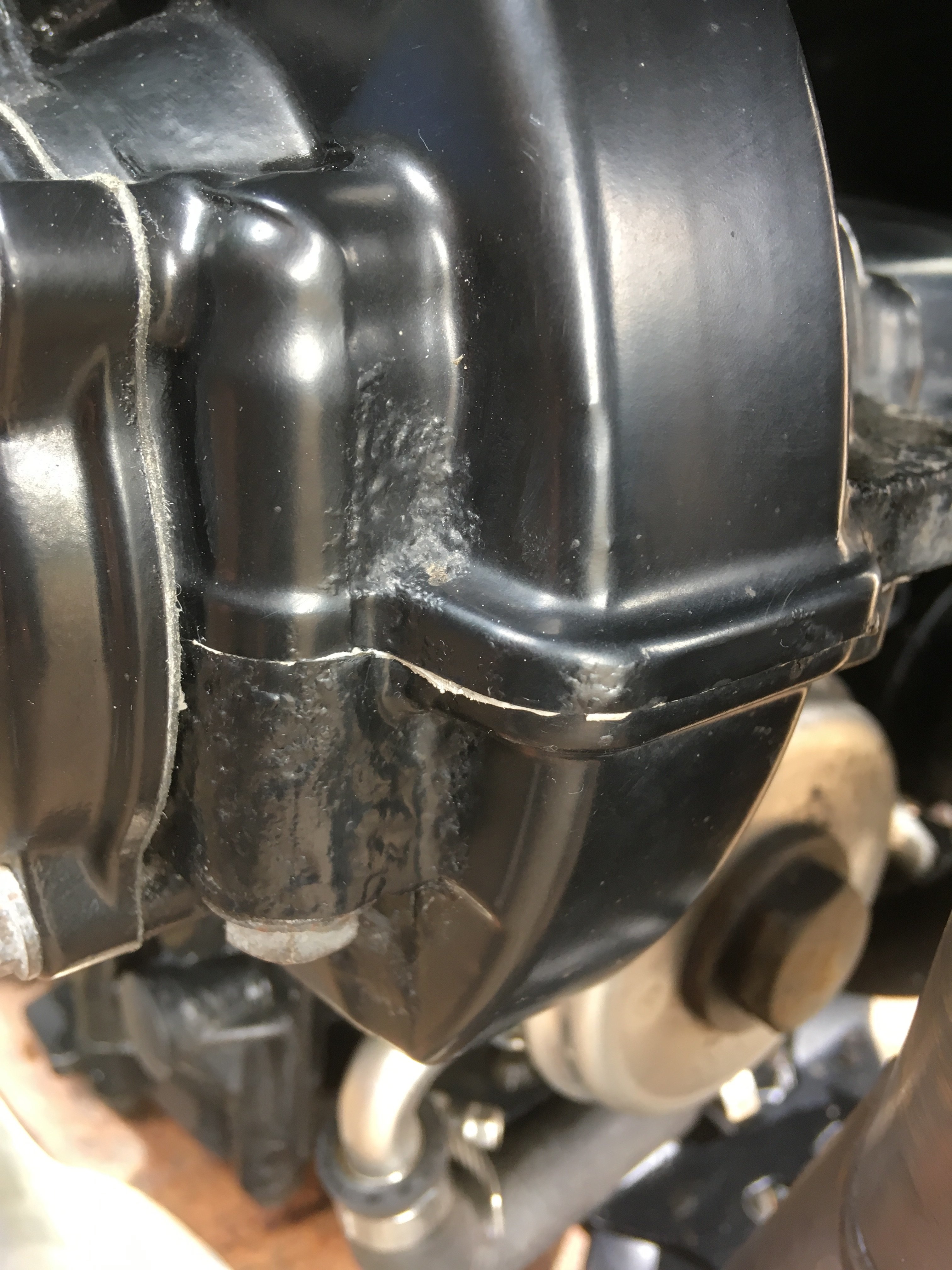

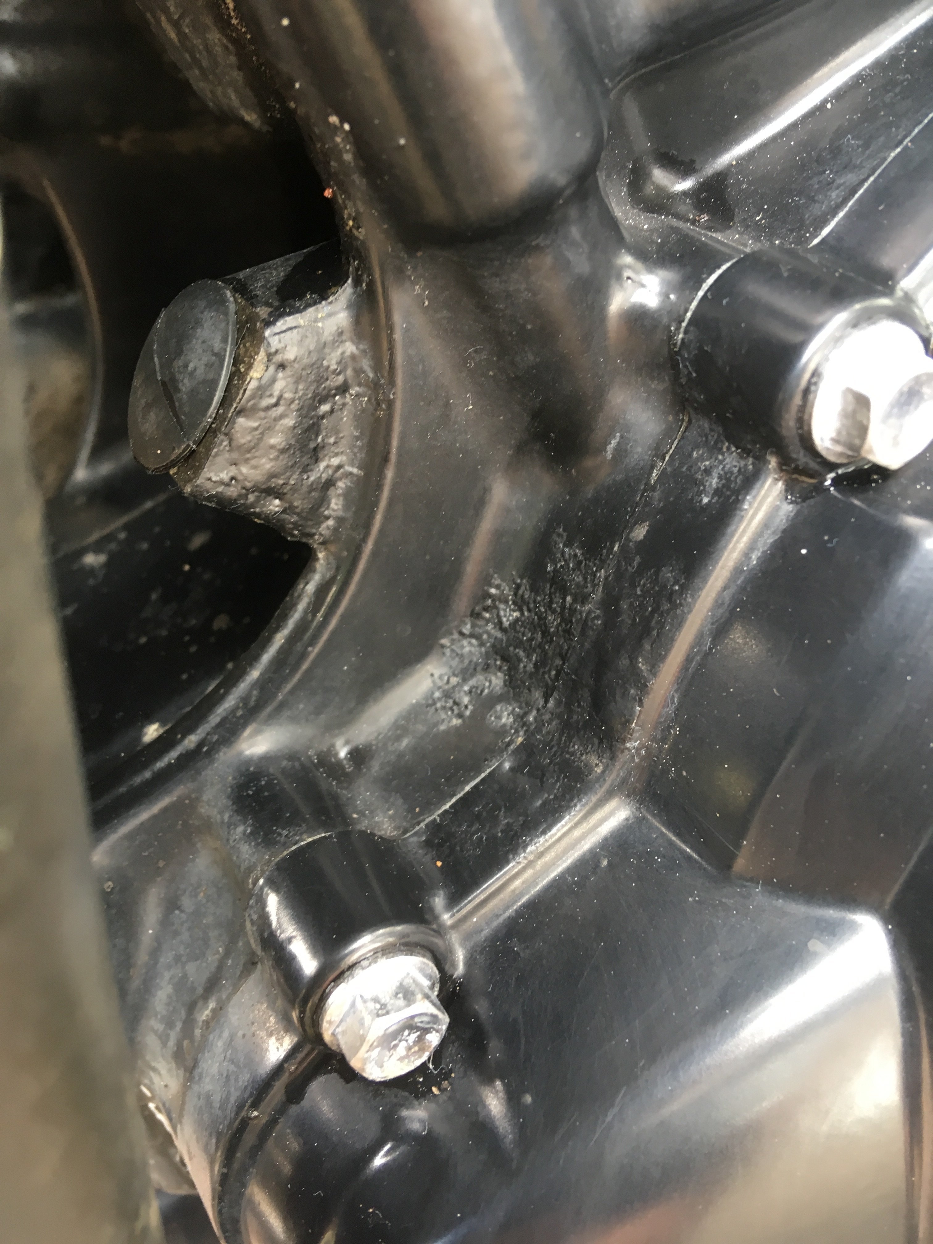

    I was giving Tracey a good going over today and noticed this, pics below, anyone else had this bubbling paint, what's it caused by and is there a fix?

    Hi mate unfortunately it's aluminium corrosion under the surface of the paint :confused:
    It will need to be stripped back to bare metal and repainted
    Warranty? Or to old?

    That be oxidization surely, getting in through the smallest gap betweep paint and engine case.
    Oxygen from the air, salt n crap off the road getting under the paint, then reacting with temperature changes (vaporising moisture when hot) spreading the gap allowing more crap to get in.
    Best give it a bit of a rub down and some localised paint with decent undercoat..

    Just about to say corrosion. but Diligaf beat me to it. Seems to be a bit of a bugger for this happening on Triumphs,
    It can be caused by Salt on roads or water getting under the paint . The Cam cover you can get Powder coated with success, Although they do not guarantee it working because of the heat but i have not seen one fail yet . The Engine I would recommend heat proof paint. But as said, A visit with the dealer first and kick up about the paint.

    A few Tiger owners on the Tiger forum have experienced this corrosion problem.
    Some have had the cases renewed under warranty, so Triumph must already know about this problem albeit a few years ago.

    Dremmel it to death, etch prime aerosol and top colour coat will do it for now. To do it long term it's engine out, bead blasting and thorough going over

    To be quite honest , you should remove the bubbled paint and give the aluminium a rub down to remove the corrosion.
    It’s exactly the same as steel corrosion, get rid before any real damage occurs

    That looks like something really aggressive has been left on the paint and exhaust studs.
    Either salt or a really strong cleaner

    The basic message is that aluminium corrodes quite readily but the resulting aluminium oxide is itself quite protective of the underlying surface - especially something chunky like a casting. The corrosion tracks along the edge of the casting under the coating but will then slow down unless you pick it off! If you do you have to replace the coating then start with an aluminium specific paint and then colour if you can’t dismantle to powder coat.

    It is fundamentally cosmetic but I would use a scraper to remove the paint then buff the aluminium with a brass brush to remove all loose oxide and shine the metal back to a solid edge in the finish. Medium wire wool would work too. You want a slightly rough finish to key.
    Apply some high temp aluminium undercoat and once that has cured finish in gloss black to match the existing finish.......if necessary overpaint/mask off to achieve a neat/uniform finish. Bear in mind the curing temperature some of these paints need if it is barely 5 degrees.
    And in a couple of years do it all again!
