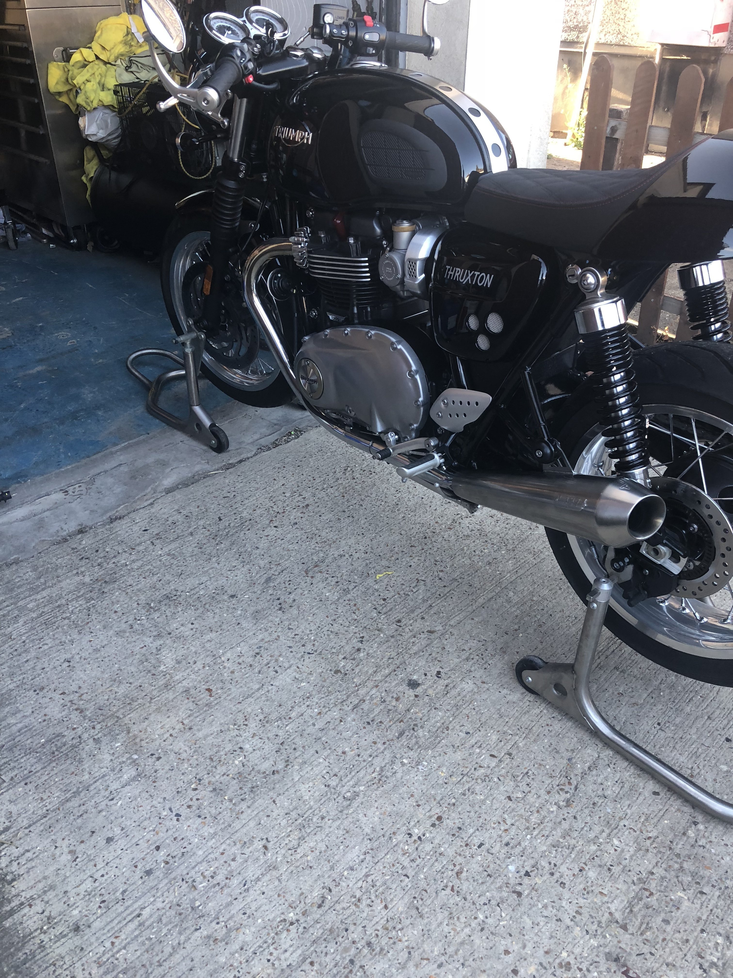

    The issue was that because my Oxford Premium rear paddock stand lifts the Thruxton 1200 far more than is needed to have the wheel clear the ground (a function of the lifting bobbins being underneath the swinging arm), the effective leverage is reduced. Although I can do it by putting a block of wood under the side stand to get the bike nearly vertical, I really don't like lifting it by myself so am in the habit of asking for help - and my 58Kg wife wasn't heavy enough to use the paddock stand (she just became airborne) and didn't (and still doesn't) want the alternative job of holding the bike whilst 76Kg me does the lifting.
    I therefore got a local engineering company to extend the stand as shown below. To get the necessary step for one tube to slide inside the other they used an inner and outer tube, the former beautifully welded to the latter but protruding the correct amount. The result is a double walled extension that is immensely strong and I am pleased that I accepted their advice not to extend the handle.
    Now to sand, clean, prime, paint, and lacquer it. Oh; and put some washers under the bolt heads and nuts!

    E3BC7D73-FF12-4228-BBD2-7A4B1C655457.jpeg B4EECA34-6FA9-4DA2-9801-A3BFBD05E6B3.jpeg Hi again, I’ve taken pictures of my bike up on both stands you still have to lift the bike up straight to fit the rear stand in but I just leave the side stand down and raise the bike with my hand on the seat.
    The front stand then fits straight on and lifts both wheels for removal or cleaning
