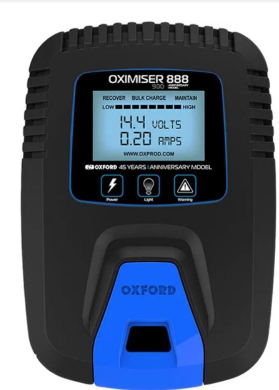

    I have had problems with flat battery on my Triumph America but I don't know if it is the heated grips or the USB ports, as they do use a bit even when not connected. I am an infrequent rider in winter months and always connect an Oxford Optimiser to trickle charge.

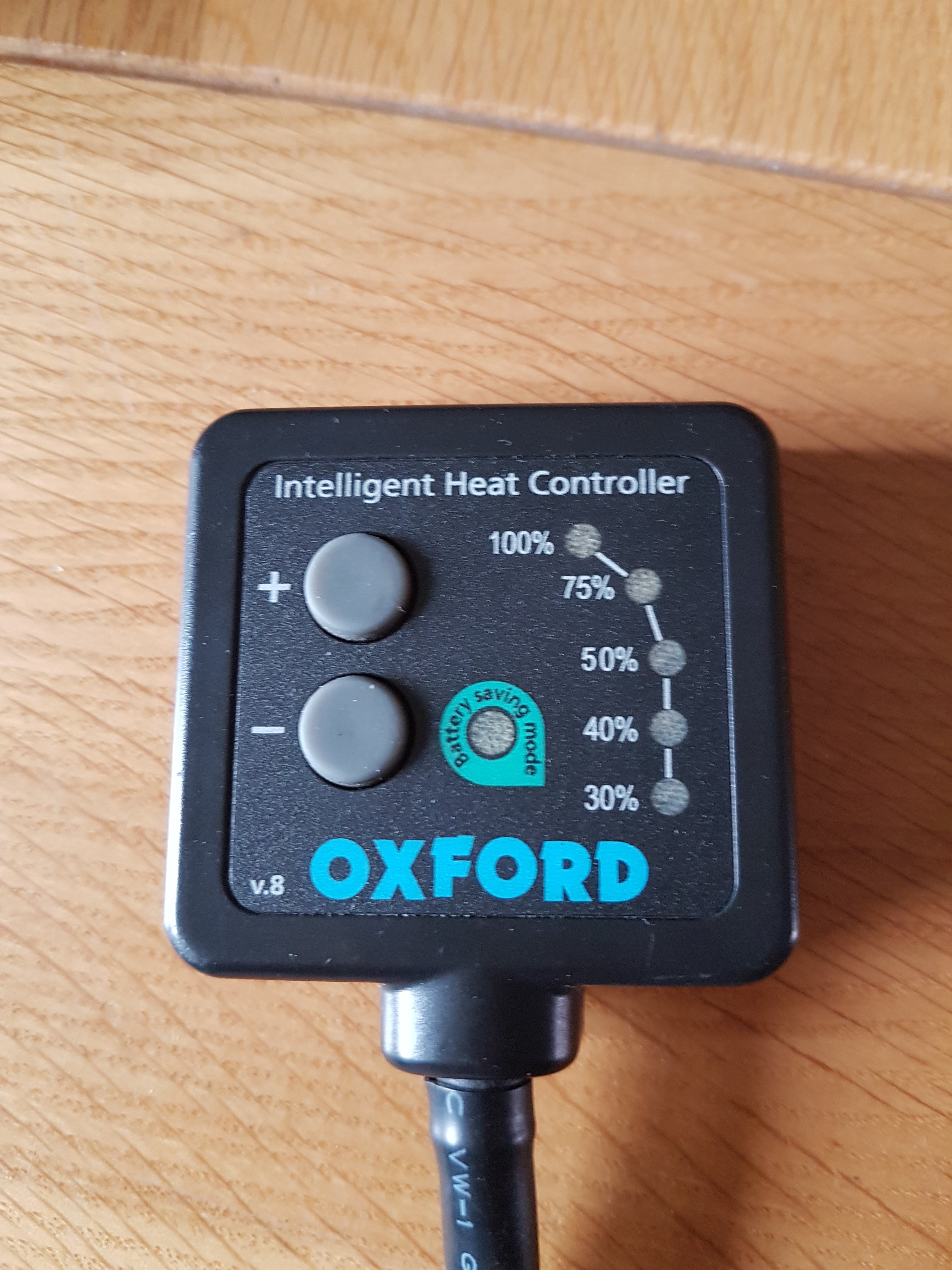

    This may sound stupid but how do I know an old set from a new set. These have been used but are clean and look tidy but I don't know how old they are or really where they came from.......maybe I should just buy some new ones and stop being cheap.

    Post a picture on here.

    I've hooked them up to a battery in my shed they go off after 5 or 6 minutes but you can switch them straight back on. Is that the norm?

    Thats the newer type as it has the intelligence written (and battery saving mode led) on it also.
    It cuts out if it detects the battery voltage being low (if you forget)
    They detect the current going up and down (to the battery) so they know if the engine is on.
    If it's just on the battery, it's only going down so it's correct.
