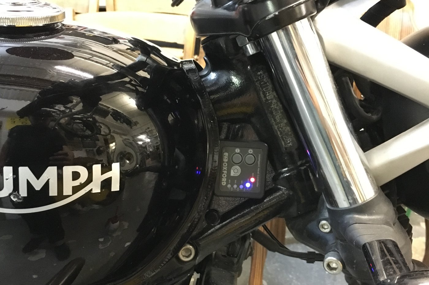

    My plan is to mount the controller with the sticky pad, hopefully on the LH side of the headstock - like this from The Bike Shed's fitment to a Street Twin.
    Can't do it on the RH side on the Bonnie as it has the stupid, pointless, awkward steering lock barrel sticking out there! :D:D

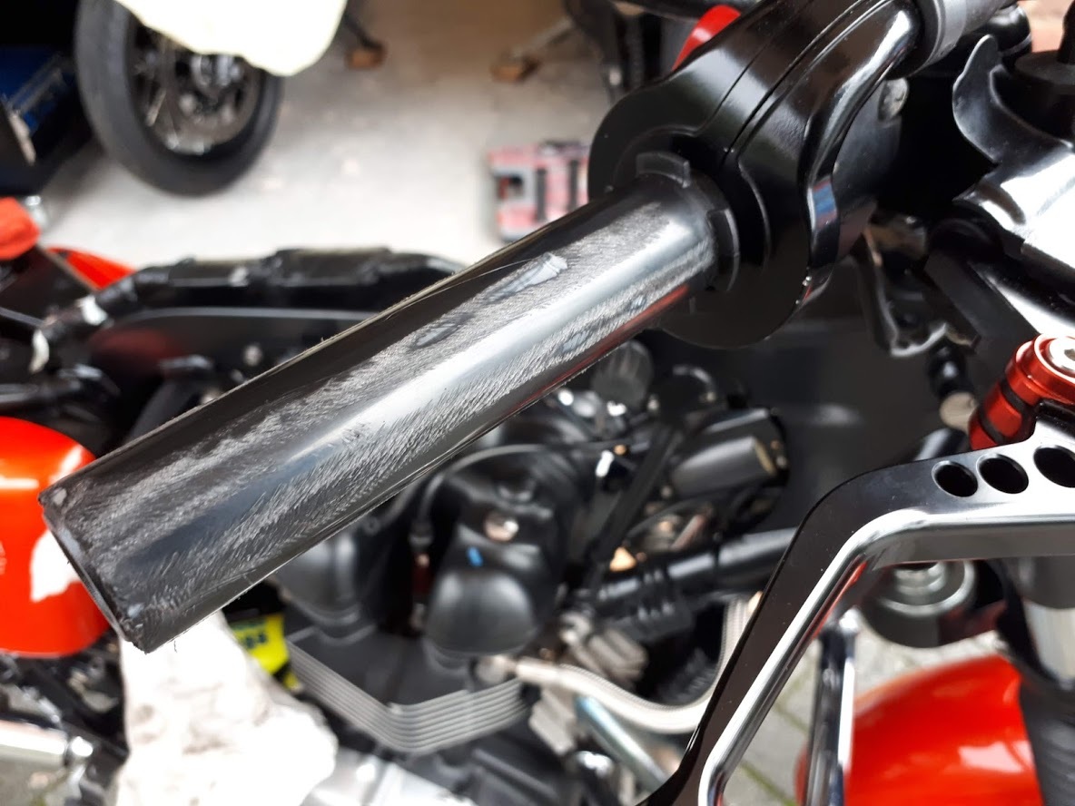

    Back to the grips - you really do need to trim all the projections off the throttle tube and then sand it down to a smooth finish. The fit of the grips is very tight, especially the RH one, so much so that I haven't bothered with gluing either side.

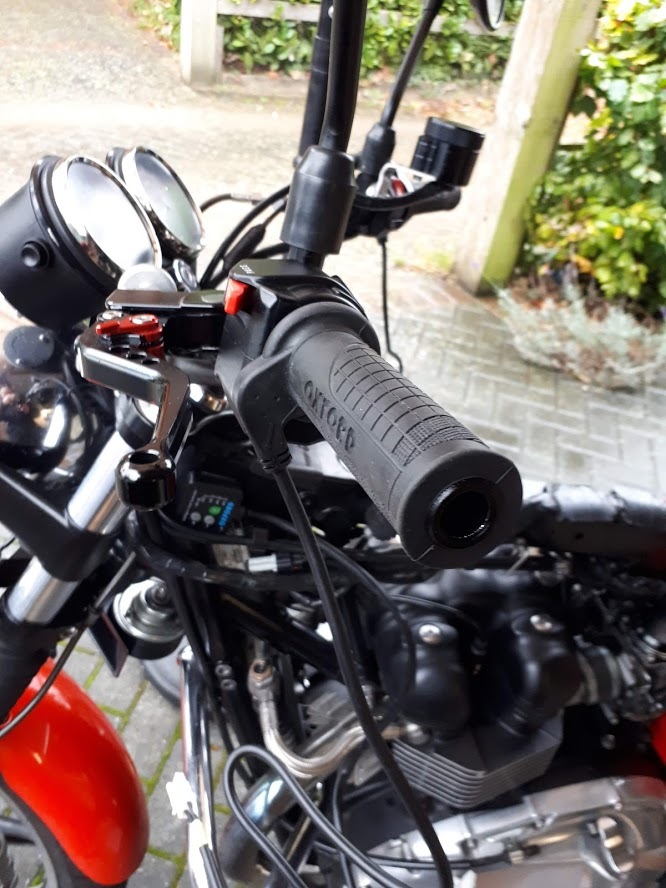

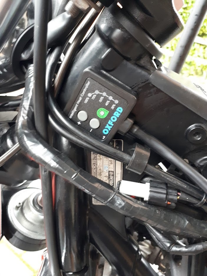

    This is where I mounted the controller - still accessible but out of the way.

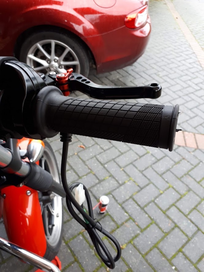

    Both grips now fitted - the arrow moulded into the grip indicates the correct angle of fitment.
    Just a bit of tidying with the wires - all hidden under the tank. Run up the bike and there we go - toasty hands and no more bulky winter gloves. It is bloody hot at 100% after about 2 minutes. :cool:
