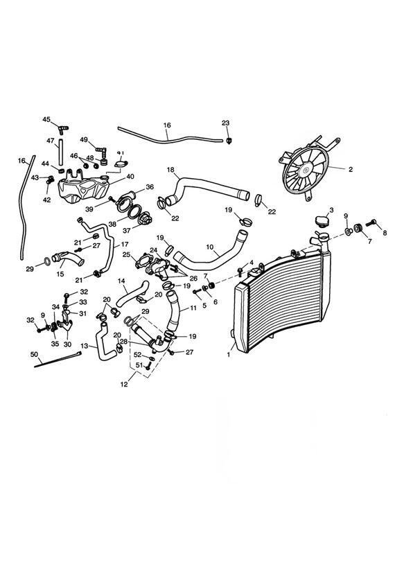

    Assuming the temp gauge is correct, the FIRST thing I would do is whip out the thermostat. It will do three things:
    A) make it run cold blooded so slow to warm up but at this time of year insignificant
    B) allow free circulation of coolant and ease clearance of any air locks
    C) see if a blocked (non functioning) thermostat is the (most likely) cause of the problem.
    Part no 36 on the attached accessed under cover 37.
    675 Daytona .......not sure which model yours is but plumbing is generally similar.
