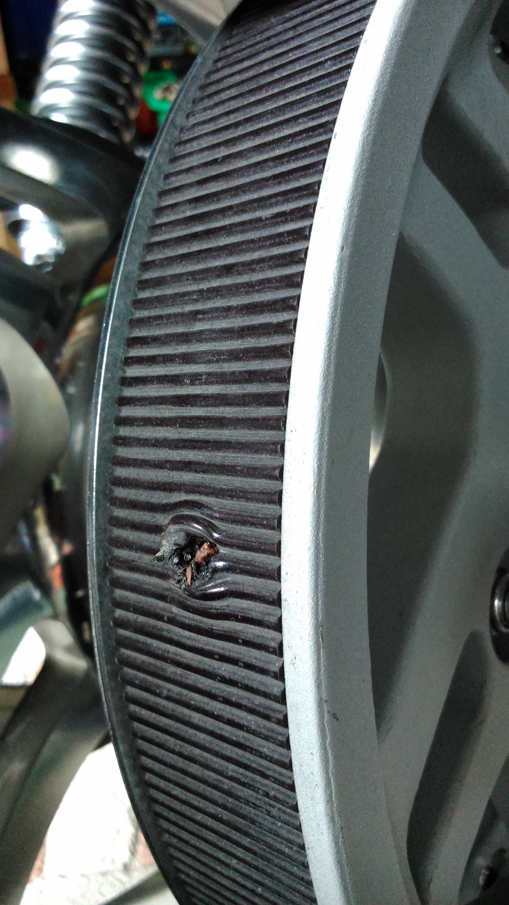

  6. TEZ 217
    3,925
    3,154
    Carefully check the drive belt for any damage if some debris such as small gravel gets on to drive belt teeth it can be driving into the belt itself causing noise like this. look at pic below.
