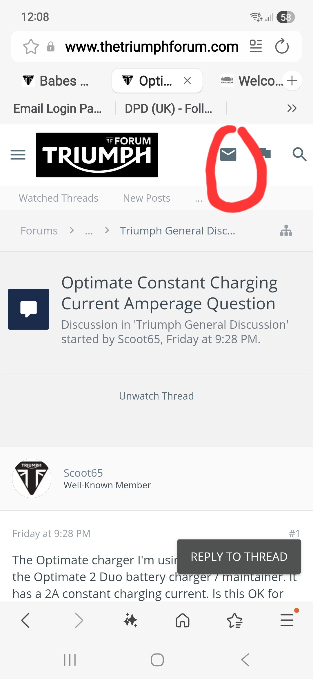

    Scroll up to the top and next to the Triumph logo is an envelope, click on that, then choose the "Start a new conversation" option. Then in the Participants box start typing the person's user name you want to message.
