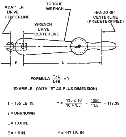

    Hi all, any suggestions on how to torque up some small nuts, which need an open spanner rather than a socket?

    Caution folks, most Torque wrenches that use spanner ends can have them fitted onto the torque tube [the torque wrench has no torque head] to be precise because as you move away from the centre line of the torque head it involves a re calculation
