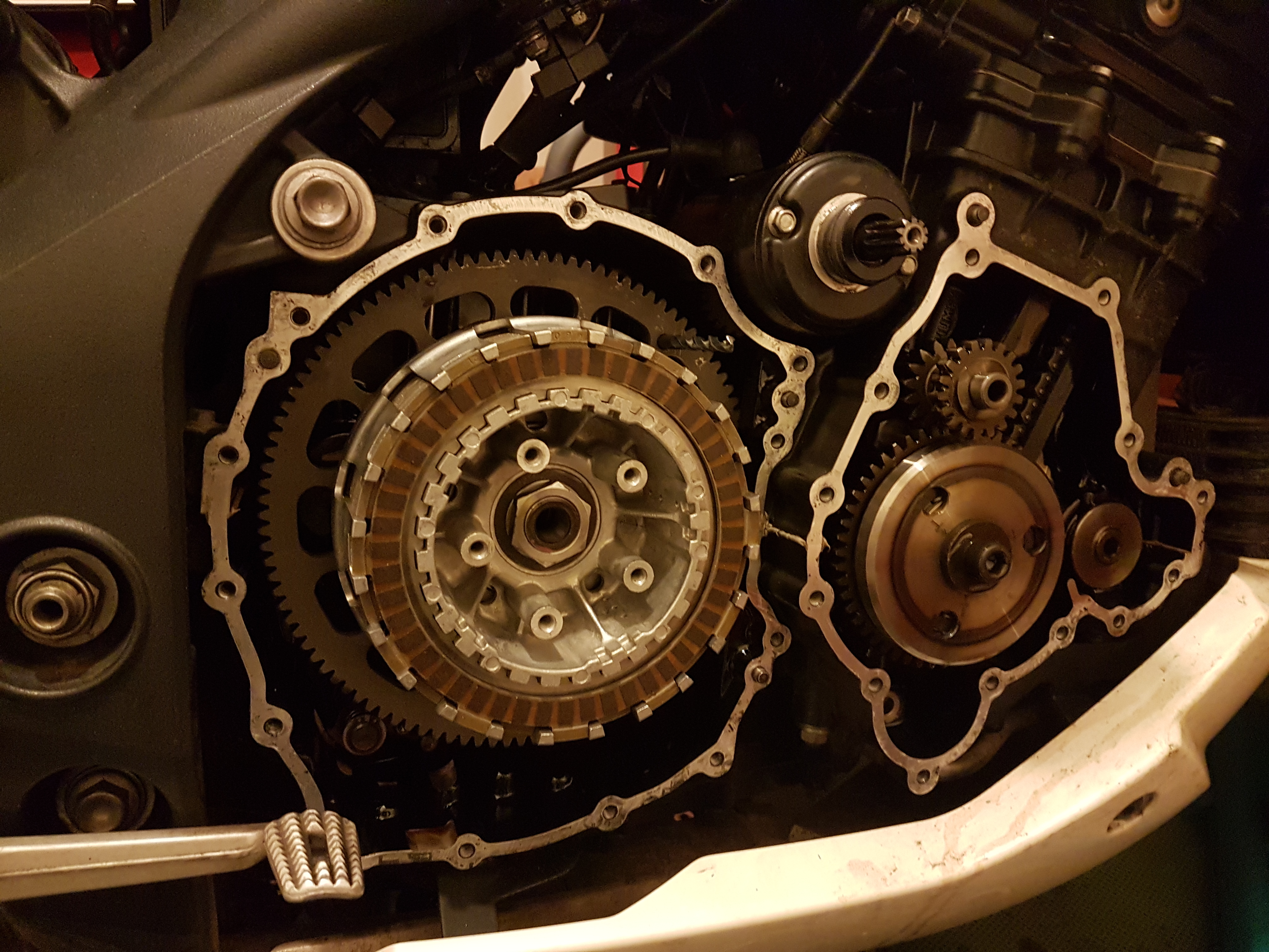

    Right then..... As well documented on here I have had issues with clutch drag/sticking and various other issues on my 2011 ABS Speed Triple
    I could live with a few issues but not all of them hence one last try to sort out the clutch.
    I bought a whole 2nd hand clutch (outer basket, plates, inner hub, pressure plate, springs, bolts, pull rod)
    On another forum I read some people had there basket replaced by Triumph under warranty for a sticking clutch so thought it was worth one last try.
    My timeline is...
    Bought bike...
    Clutch started dragging and occasionally sticking...
    Changed oil to Silkolene to try and improve to no avail...
    Noticed steels were a bit blue so replaced steels (Barnett) and fibres (EBC) as I was informed the oil oil could still be present in the old clutch fibres...
    Added updated Triumph clutch pin...
    Clutch started dragging and sticking all the time too...
    Pissed about with oil level and cable tension...
    After stripping it countless times I came to the conclusion it is the oil not clearing from the plates making them drag and a lot of oil lingering around the inner most plates making it stick when parked for any time.
    While doing the clutch swap I thought I would swap the detent arm to the newer version too, my bike had some weird setup with the spring for the detent arm over the top where as the later engines and Speed R had a normal setup.
    They obviously don't update stuff unless the older one had an issue so for the cost I thought id do it and see if it improves the clonky gearchange any too.
    Time for some pics....Apologies they are a bit crap....Did it in my tiny garage by the light of a 40w energy saving bulb as it was raining ha ha ha
    Removed case covers.....bit of oil on the clutch
    Checked old springs for equal length to ensure pressure plate pulling even
    Pressure plate removed, some oil inside the hub and wet plates (ooh er missus)
    All but one plates removed and quite a bit of oil present at the bottom of the hub/basket
    Last plate removed dripping in oil (bike has been sat since Thursday night 10pm)
    Thought id check the backlash gear was doing its job while in here...looks to be
    Time to remove the hub and basket with my new clutch tool
    Anyone fancy some sticky plate action
    Some oil present in the basket when removed
    Basket and hub removed, notice old detent arm with spring going over the top
    New detent arm fitted with normal spring setup....Older spring was very weak compared to the newer one, easily stretched by two fingers new one takes lot of force to move

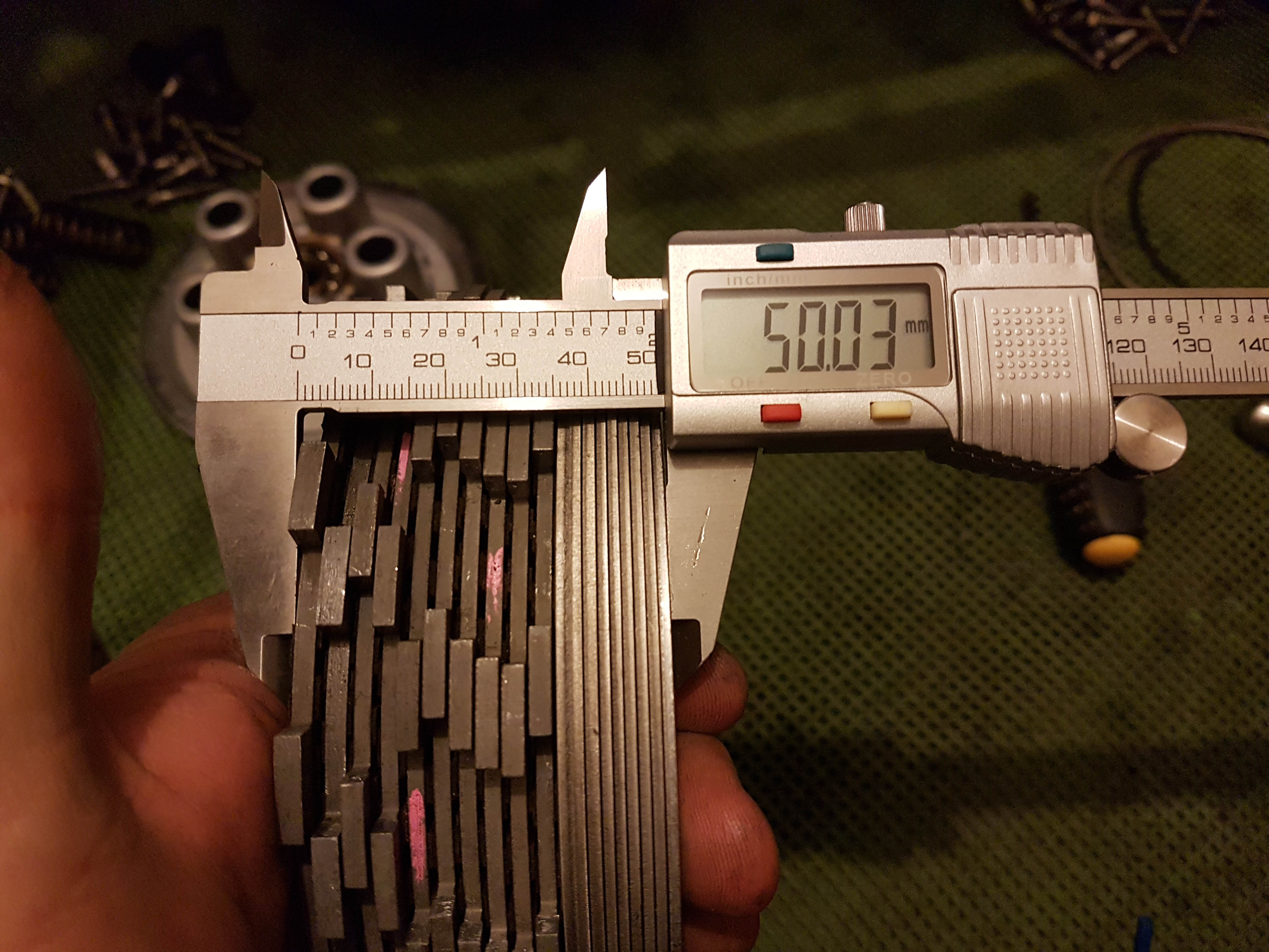

    Thought id check the stack height before fitting the other clutch plates
    Workshop manual says max limit is 50.37mm as you can see it was at the limit give or take a bit of tolerance from my tools/measuring
    Swapped out a 2mm steel for a 1.6mm steel, not exactly .4mm less as the 2mm aren't 2mm and the 1.6 aren't 1.6mm :D

    Borrowed my mates torque wrench, tightened the hub nut (150nm) checked the springs for equal length, threw the plates in ( in the order the workshop manual says, bar the swapped 2mm) buttoned it all up and I'll give it a ride tomorrow !
    Yes I did remove my drill bit/backlash gear set tool too :D
