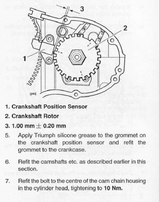

    Could it be the crank pick up sensor for the ignition ?
    Sometimes they can fail and cause intermittent problems.
    I`ve seen on here others having problems with them.
    It`s part No 1 in picture.
    Others on here might have more experience of this on forum or more information

    Crank sensor failure would affect all cylinders equally and 99% of the time is all or nothing.
    The symptoms would point to a fuelling fault rather than an electrical issue, and removal of the tank to change coils etc is enough to disturb / reset the fault, the other thing to look at would be the carb vacuum caps on the carb tops for presence and splitting / leaks, also check the vacuum line to the tap from the carbs ( usually from no 3 ) and or pinched / trapped fuel lines.
