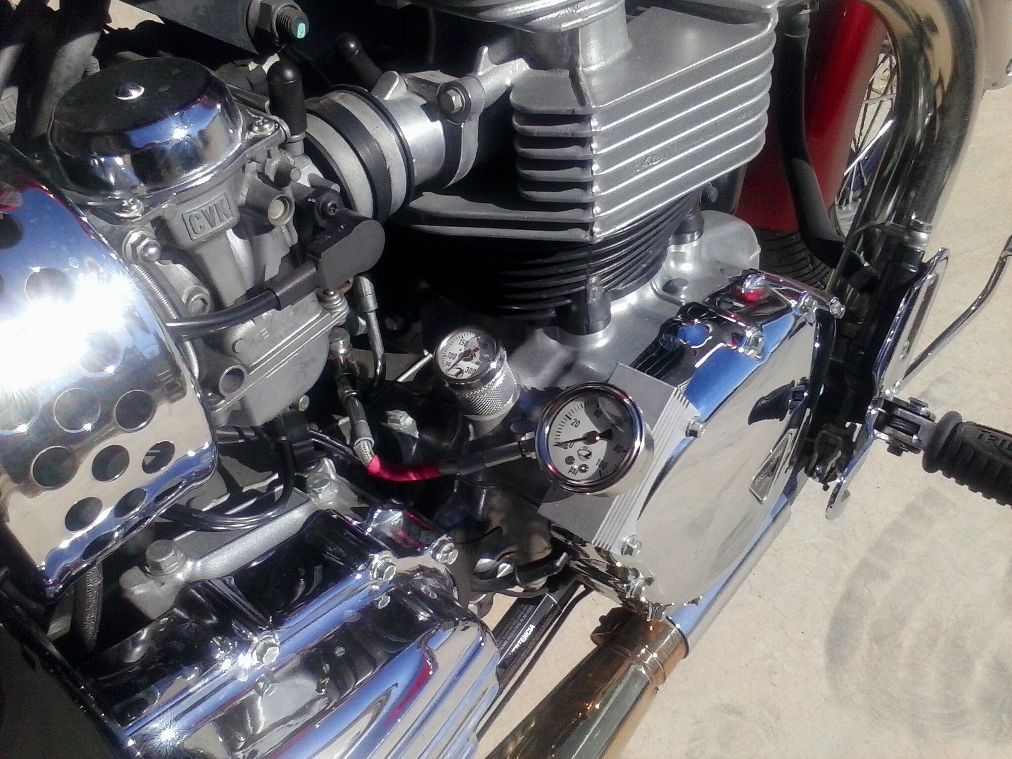

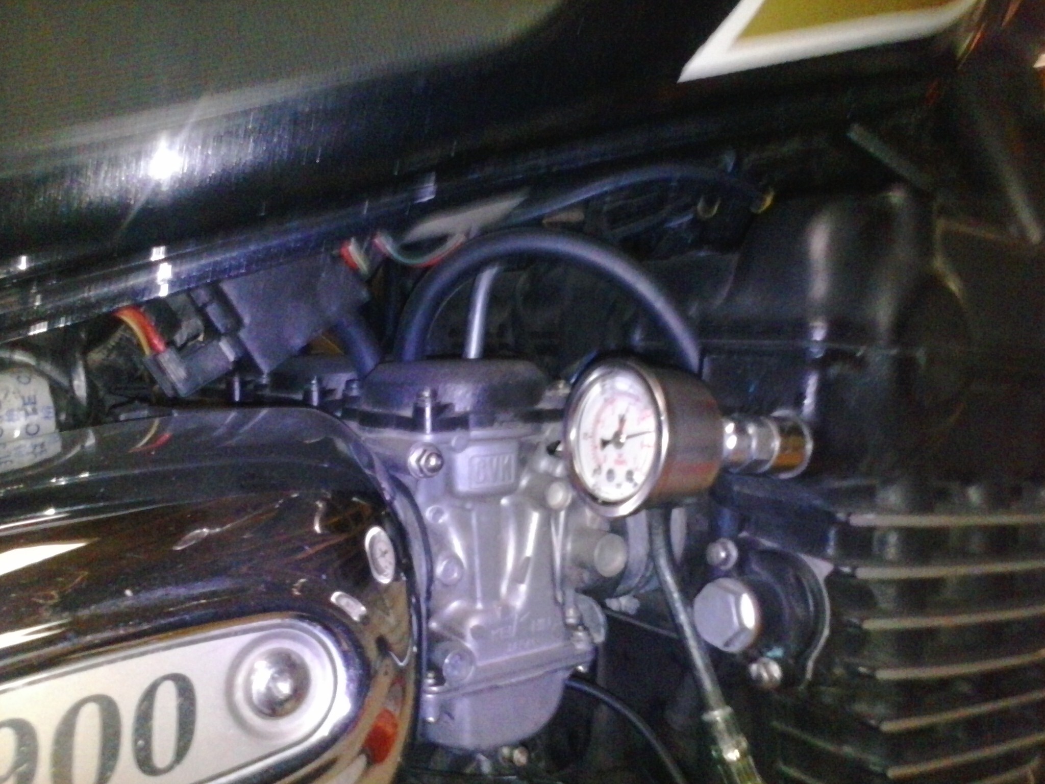

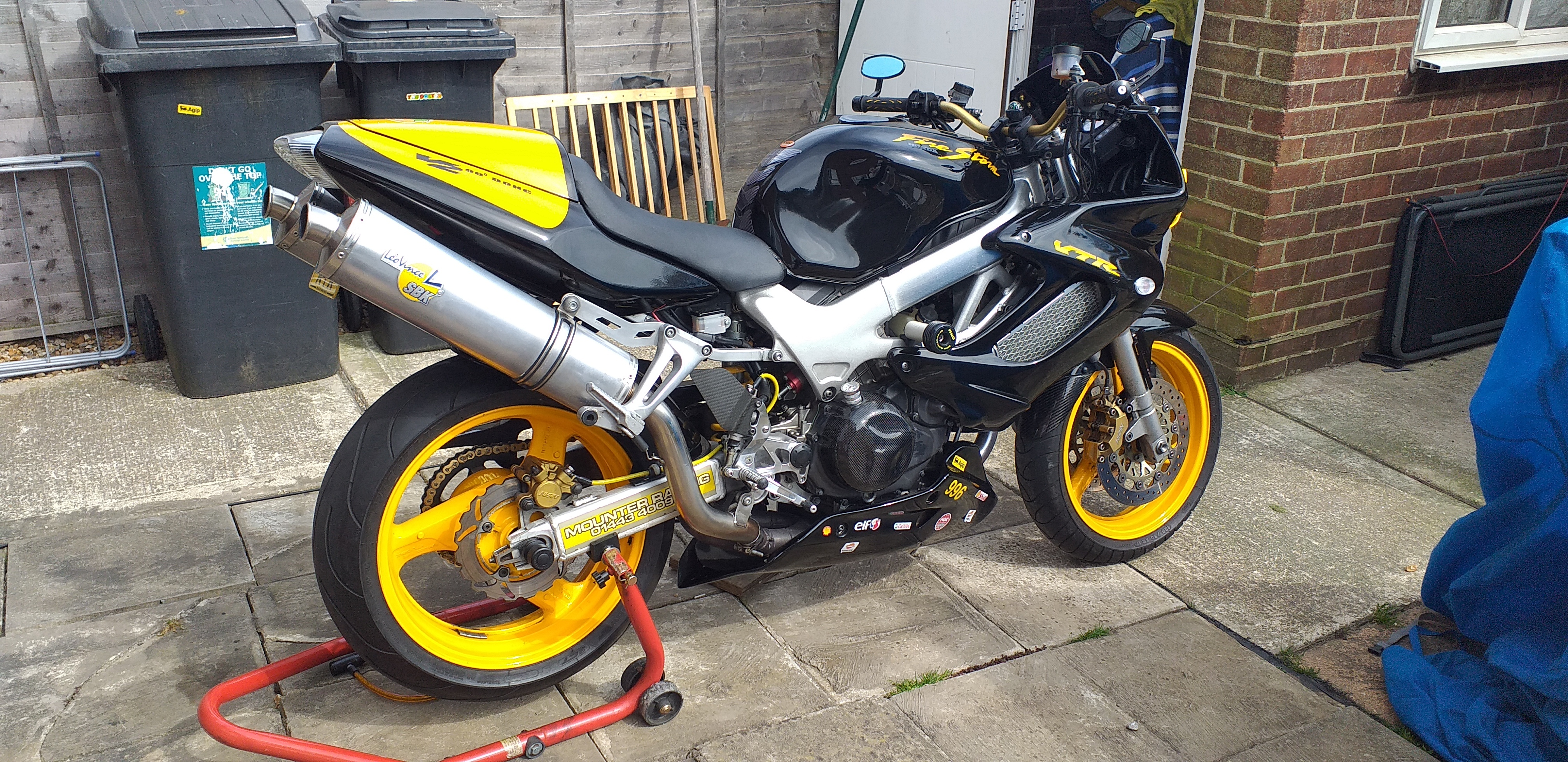

    Couple of ways do this Gil. I have one on each one of my bikes. Here is a picture of the one I have on mine. I bought both the gauges on my America from Newbonneville.com . I also did some on my two old T-3 bikes with a fitting of my own design. Here are some pictures:
    ...J.D.
