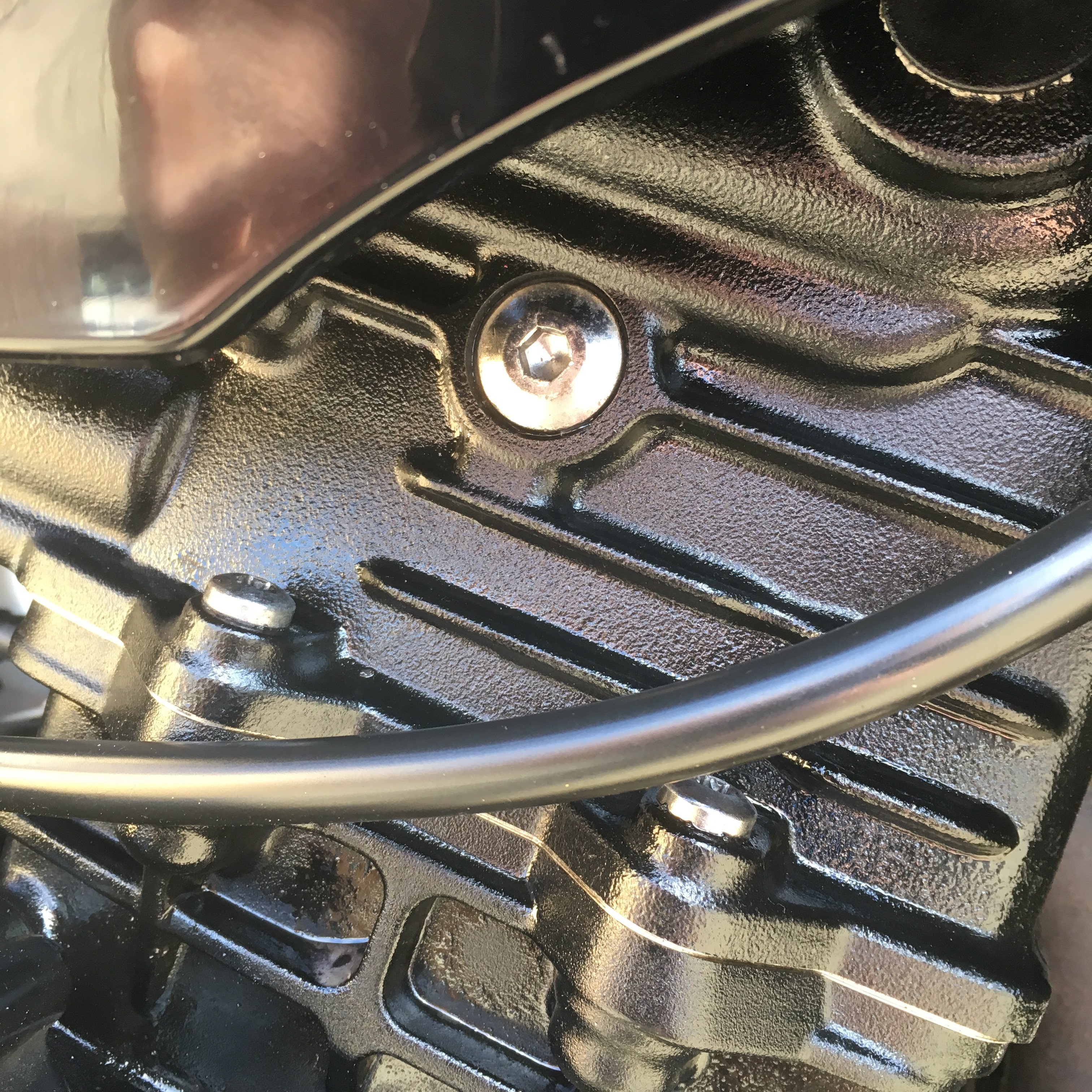

Hi all. My speed triple 2016 with 18k has just developed a sml oil weep from the single bolt on the right hand side below the rocker cover but above the head gasket. Just started after I topped up the oil. Any ideas. Cheers
The one below the clutch cable? Been known to be loose on another members bike, try nipping it up a bit. Are you under warranty? Dealer if you are.
No, its not part of the tensioning system, the actual tensioner is mounted behind the cylinder block. That bolt is number 10 in this picture https://www.worldoftriumph.com/part...triumphmc/modelid/610370/block/100073425-1-2/ The cam chain tensioner is shown in this drawing, item 12 https://www.worldoftriumph.com/part...triumphmc/modelid/610370/block/100073424-0-2/ Nip it up a bit but don’t go daft with it, if in doubt go to a dealer and ask their advice.
