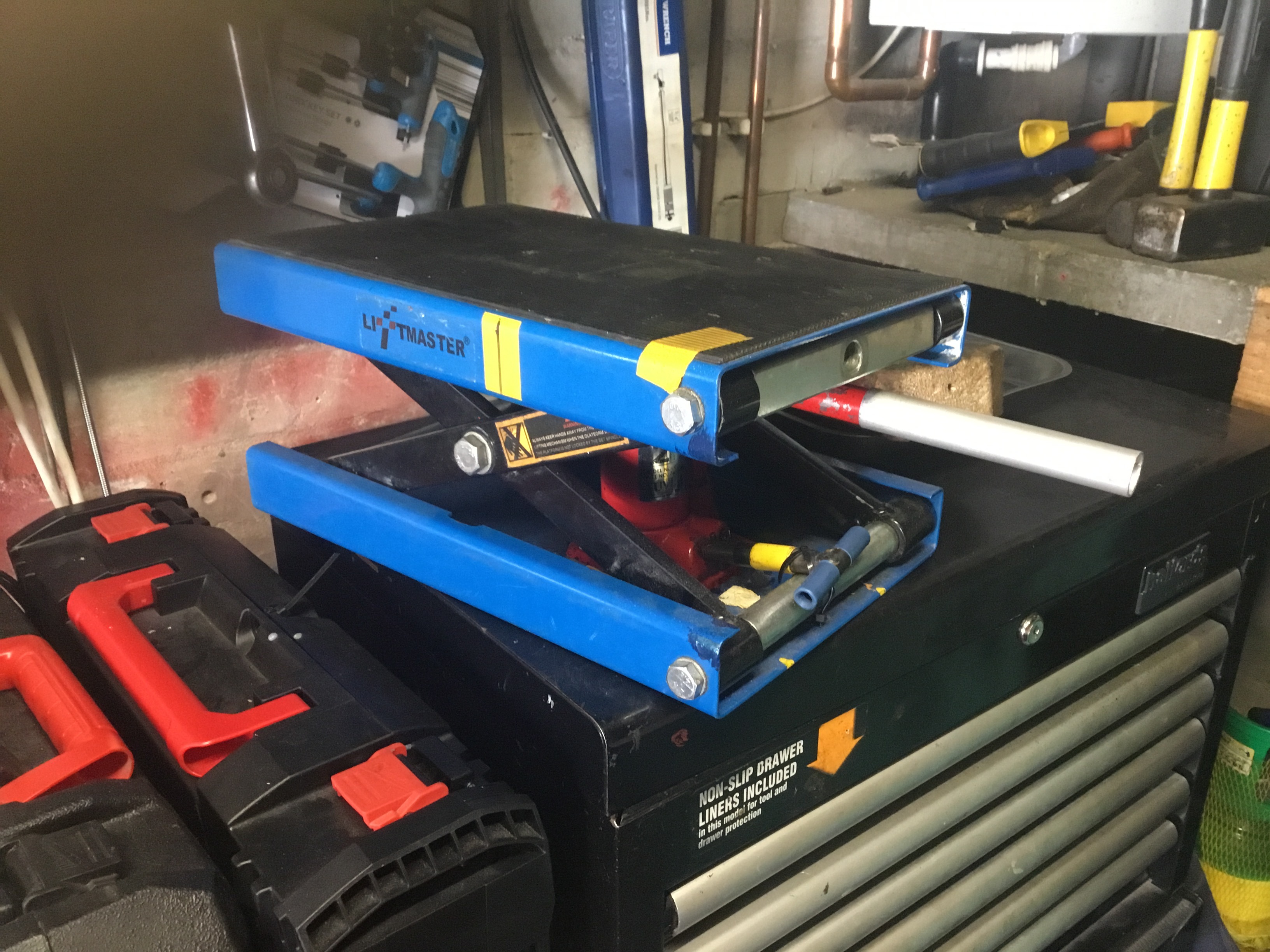

    Other options include a Centre Stand, Scissor Lift or a Wheel Roller. The Centre Stand is expensive (Triumph OEM) and not easy to use with a heavy bike, so I'm torn between a Scissor Lift and a Wheel Roller.
    A Scissor Lift is a bit pricey but does get the whole bike off the ground which may be useful for other tasks or cleaning. Having looked at the bottom of the bike I think the engine sits about 5 mm below the level of the frame so I guess I could use a couple of wooden chocks to ensure I'm lifting the frame and not the engine. Wheel Rollers are cheap but I think I'd like the rear wheel to spin freely for cleaning/lubing.
    Any advice/thoughts on the best way to lift the bike would be much appreciated. Additionally, I'd be interested to know how often other owners clean/lube the chain as every 200 miles does seem rather often!

    @Rob2025 Welcome to the family. I oil my chain every thousand miles or so. I have a car jack trolley and it lifts my bike handsomely. Do tap the upload a file button bottom right corner and show us all the bike.
