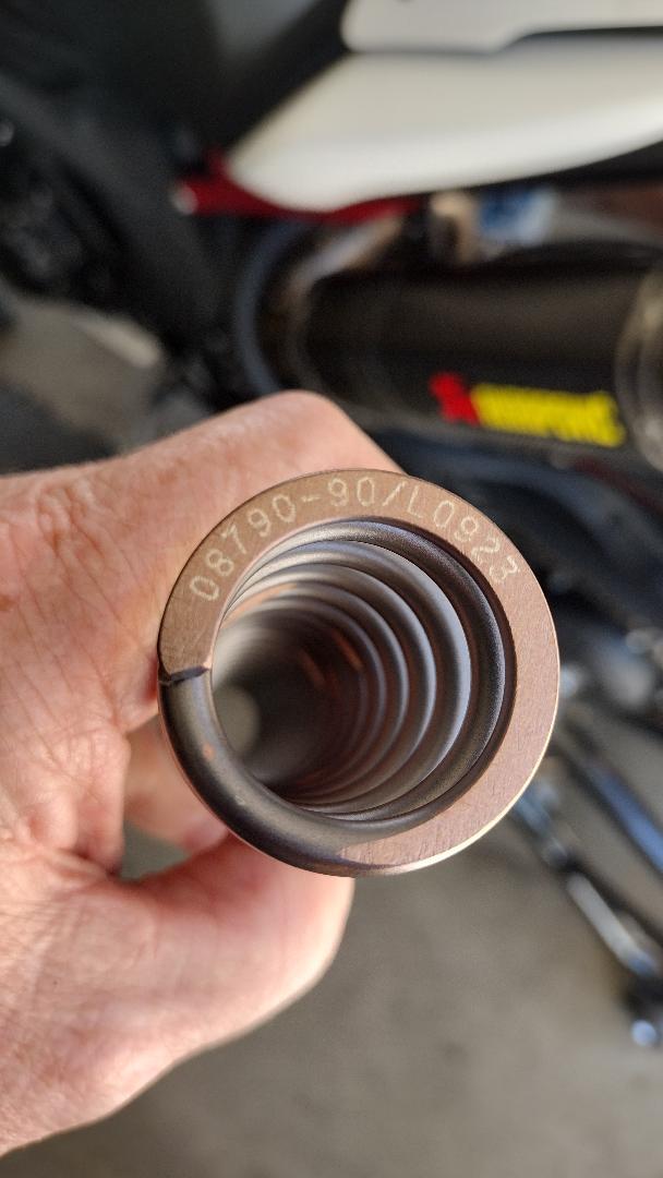

    Well guys after all this adjusting i decided to order new springs still to harsh over any uneven roads here in Cali...getting the 9.0 N/mm
    Ohlins Fork Springs FGK 200 9.0 N/mm 08790-90

    I fitted the new springs today the old ones had no numbers, ..update.. i contacted Ohlins europe and was told the the springs fitted in 2014 had no etching they were 9.5 M/nn the 9s had a line etched on the spring .. i can now set the sag, before i had the pre up and down little adjustment.... feels much better in garage....These ohlins springs are not cheap... 135 quid for the pair inc UPS.......$174
